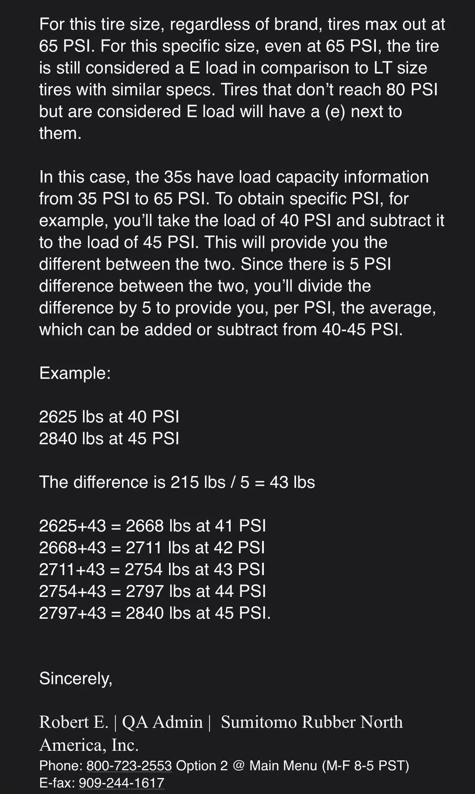

The psi you run at is dependent on the load. A 6000lb JT isnt going to run as low a psi on pavement as a 4000lb JL. By my calculations I can run my 35s at 20psi and still have 6200lbs loadCl capacity on the tires. Outside a chalk test, the Falken service rep I emailed (who also Jeeps) says for my 6000lb rig 35psi is ideal
Keep in mind the load at any given PSI is more a logarithmic scale, not linear. If I remember correctly, it's also diminishing returns where you gain more per psi at low pressures. To be able to do the pressure correctly off a calculation, you'll need the engineering specs for the tires.
Companies often post their load index charts and it is a linear relationship more or less until below 35psi. I checked with Falken on their M/T 35s and it was essentially 34lbs per psi

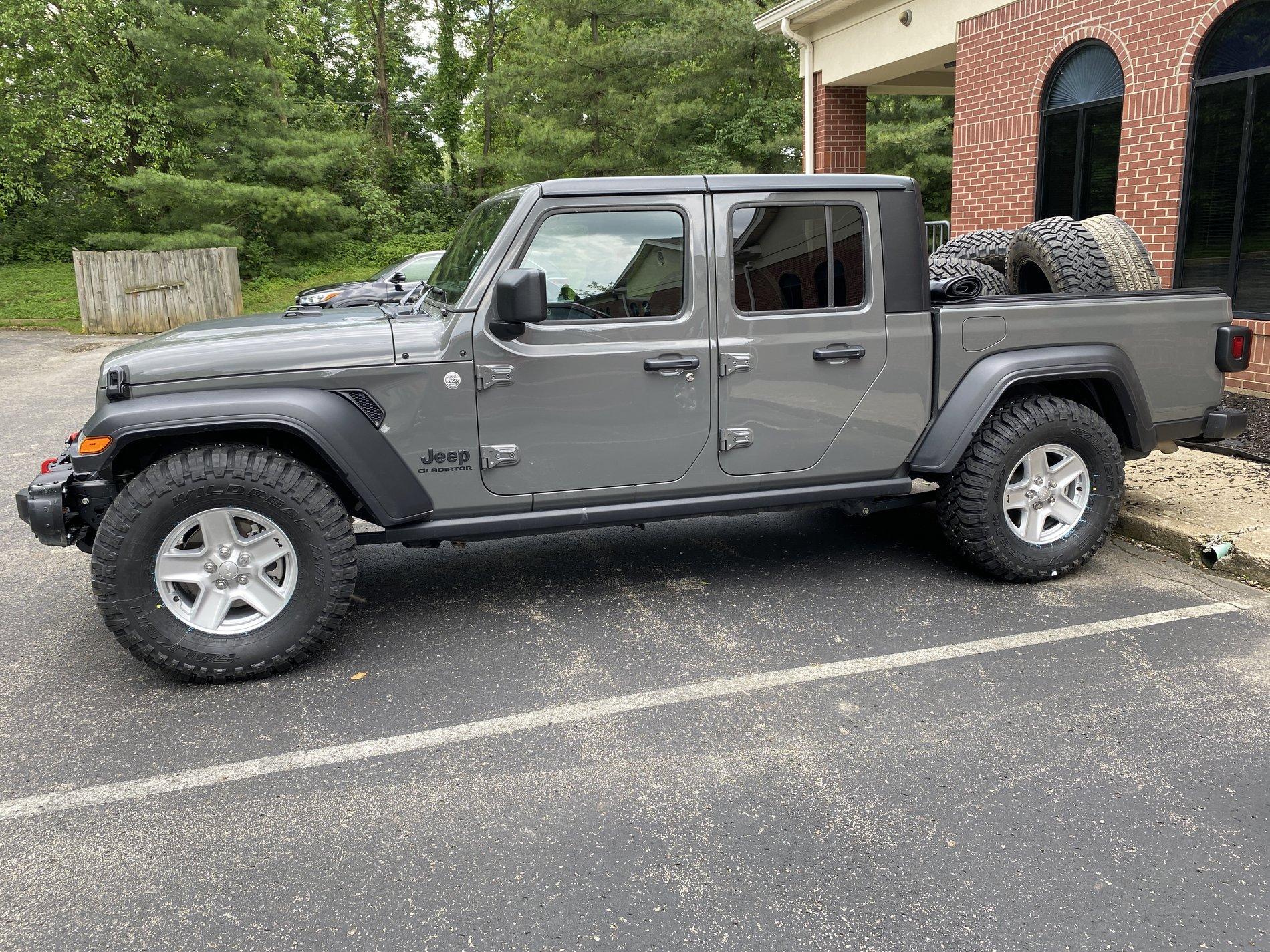

35x12.5x17. Completely stock JT, even the wheels, except for the bumper (which can be stock)
That's not a Sport bumper. You don't have the wings between the bumper and fender that causes the tire obstruction. Even with a 2+" lift these will need to be removed. Of course, also a good excuse for a new bumper.
Before
Jeep Gladiator 315/70/17 vs 35x12.50x17 1590797454497
After
Jeep Gladiator 315/70/17 vs 35x12.50x17 IMG_20200529_122234
