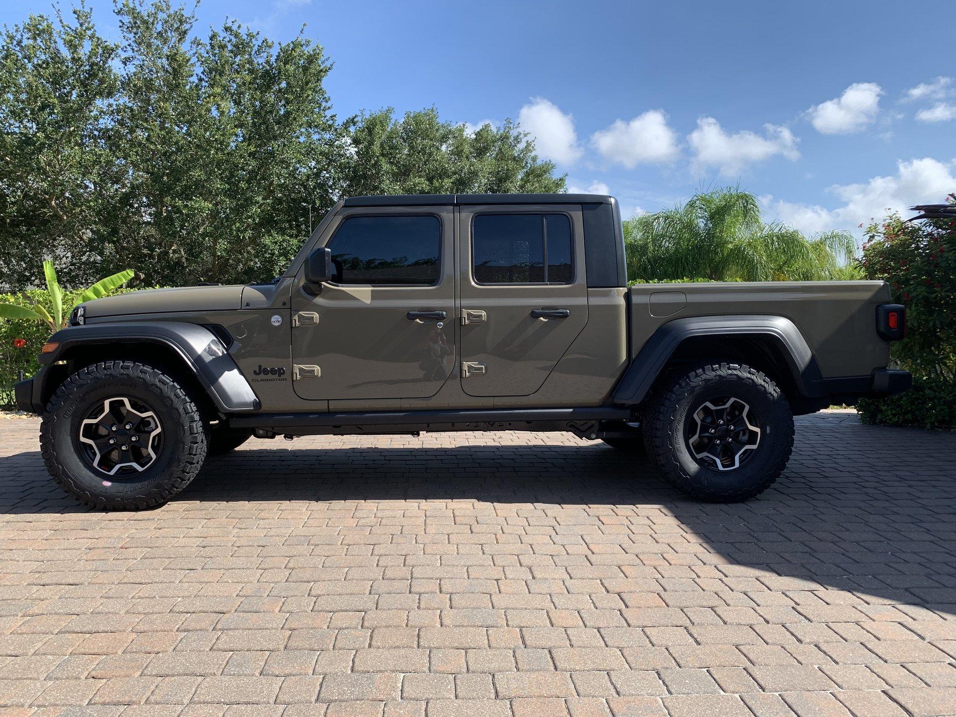

Hit my local Discount tire today for a set of the C load 315 Bfg’s & pretty happy so far. Fit’s perfect on the spare wheel also & under the truck. I was hoping to have the lift on first but with any luck the Mopar lift will arrive this week. The only thing that would have been better is if I didn’t miss the $100 rebate. ;(
DaveFrat
David
May 23, 2020
36
San Antonio, Texas
2020 Gladiator
Driver
Jeep Gladiator 315/70/17 vs 35x12.50x17 6D7D7DDB-0024-4E26-85DA-D8DCEFE8EABF
Looks great
