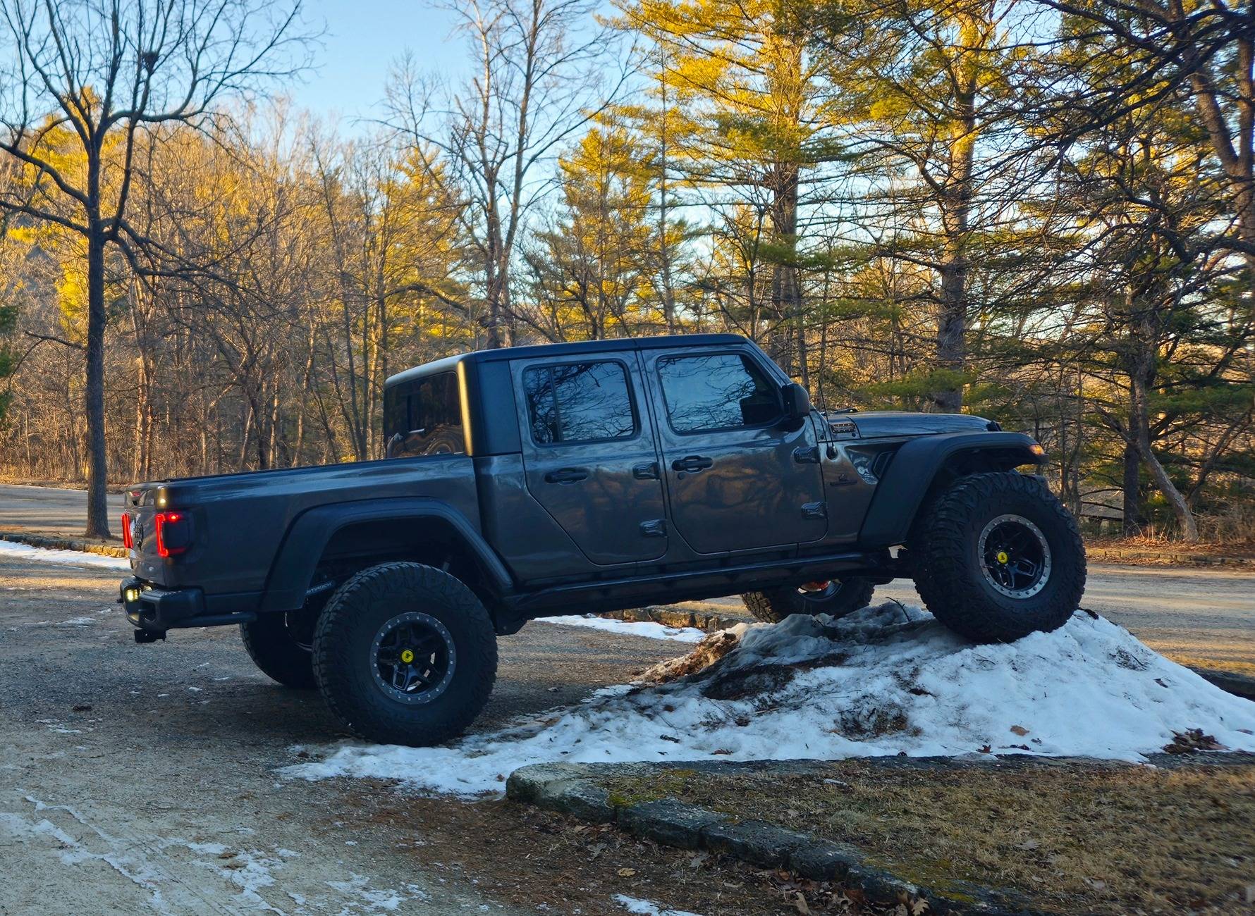

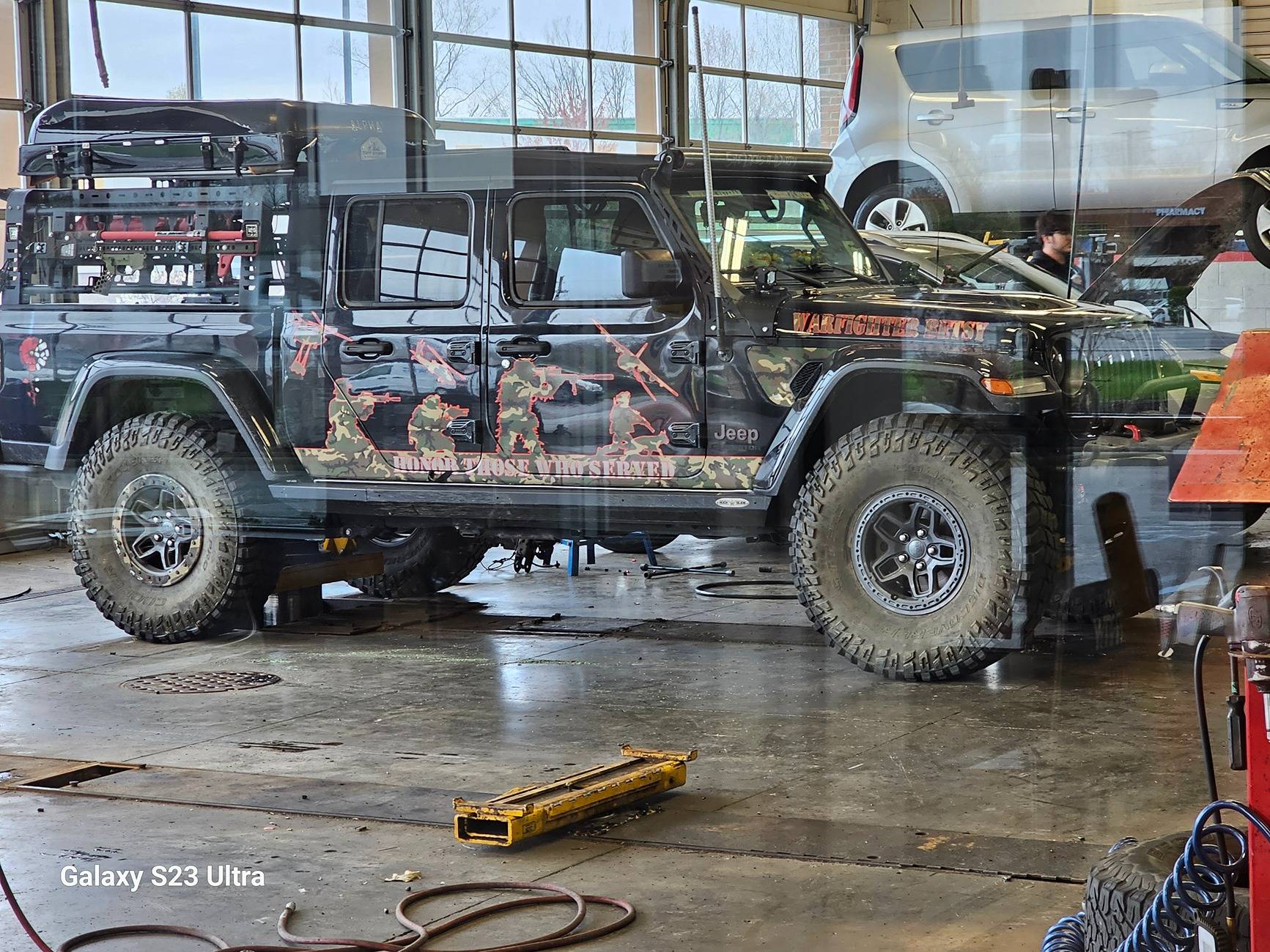

I don't quite meet your spec but I'm running:
- 3" rockkrawler long arm/triangulated rear
- Borah beadlocks
- 38 Falken RT01
To clear the front control arms with a 38x13.5 I need a 4.5 back spacing. Obviously, the Borah runs 5.72" BS so I added a 1.5" spacer to accommodate for now. I've also gutted my inner fenders, but still run a full fender. I think you will have issues with backspacing, rubbing control arms, and rubbing fenders with that much tire.

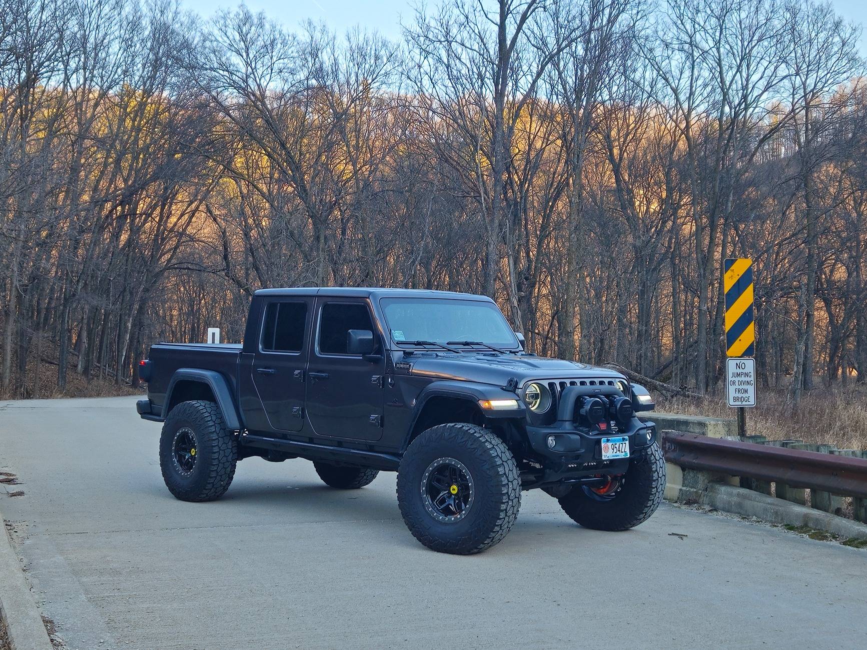

Definitely rub the control arm. I have 1.5 spacers on the way. But I didn't make any contact with the fenders at all.
I wouldn't expect fender rub at ride height but any flex and i imagine you're going to grab them pretty hard. Looks cool though.
Any other supporting mods or are you looking for a stance more than clearance on the rocks?
Are they STT Pros?
STT Pro 40x13.5x17
Eventually I'll switch to 5.36 gears. And if needed I have an AEV 2" puck lift.
