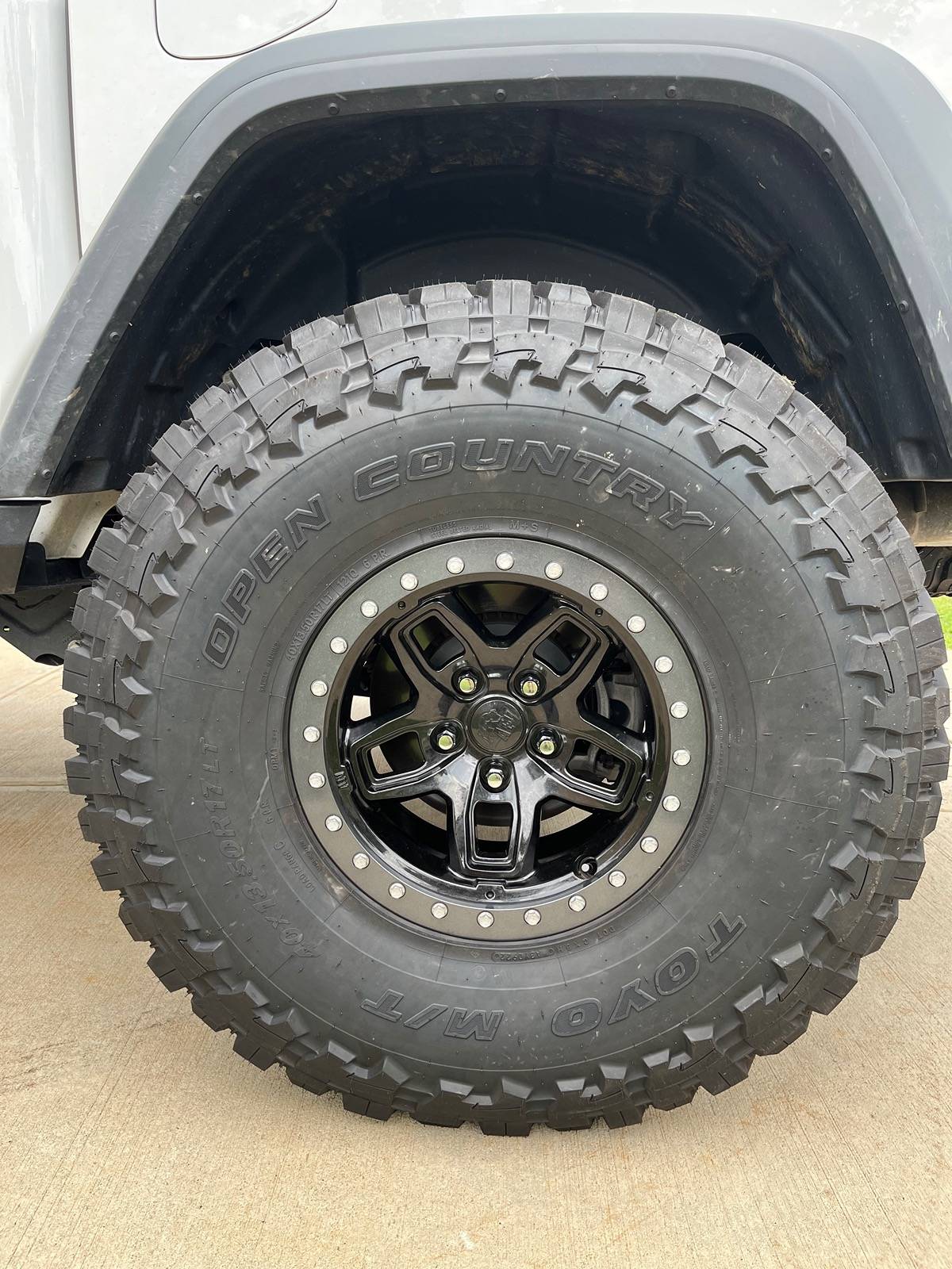

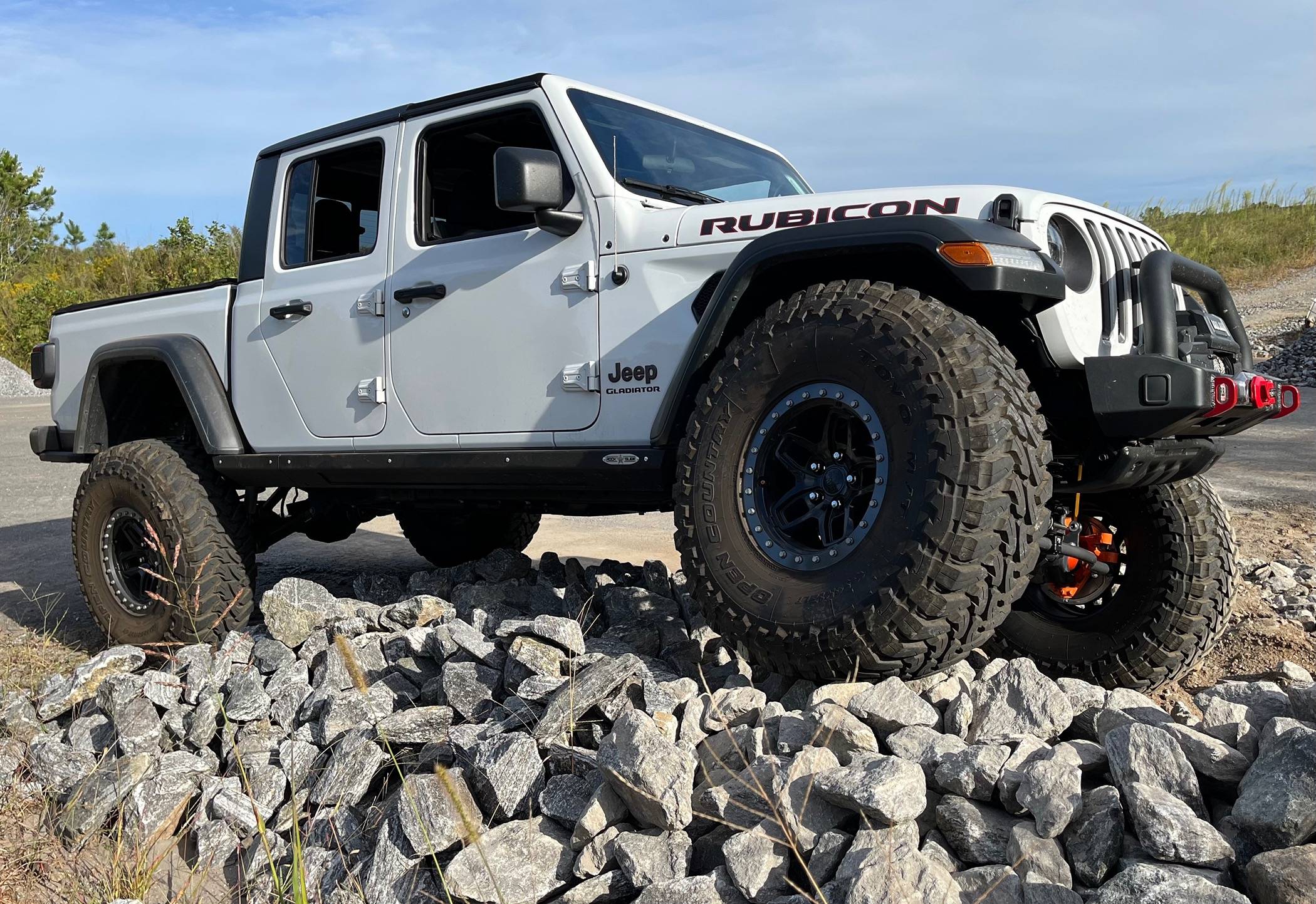

I’ve been running AEV Borah in both beadlock and rock ring for years without any problems at all. Daily driver.

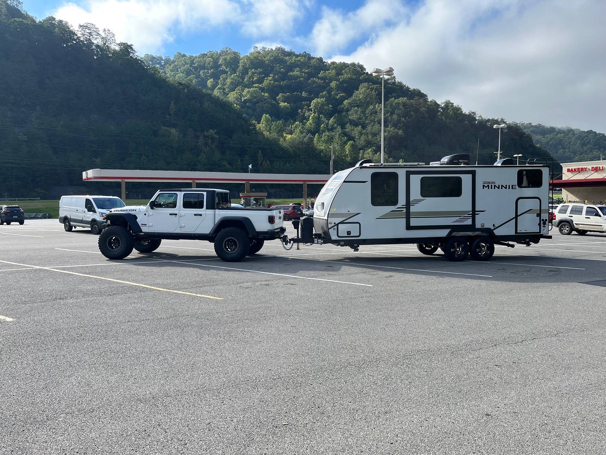

I’ve towed a trailer across the US and wheeled in Windrock and have put over 150,000 miles on beadlocks on my Gladiator and Wranglers.
I also run KMC Tank beadlocks on a daily driver that wheels hard.
I don’t worry about anything anymore like others will say to be worried.
Companies have lawyers for dumb people that sue after their own neglect and incompetence.
Most people don’t have or never have had beadlocks so they don’t know.
AEV Borahs are great except for one thing…
The large ridge around the valve stem hole makes them off balanced by approximately 3.5 to 4 ounces.
I use balance beads and they work great.
Otherwise, you’ll have a lot of sticky weights that can come lose.
I do think very good quality tires are necessary though because they will balance far easier with almost no weight needed. Toyo and Nitto are the best.
My 40” Toyo MTs needed no weight with KMCs and only needed enough to offset the valve stem bulge with the AEVs.
Now, my AEVs are mounted with BFG ATs and they need more weight because BFGs suck. Rock rings now on the AEVs.
Thats a good thing about the AEVs, that you can run them as standard mount or beadlock. And they look great.
My tire sizes are 40x13.50r17, 38x13.50r17, and 37x12.50r17.
I will say that the 40s are a little too heavy for the AEVs or I’d still be using them because they look great.
