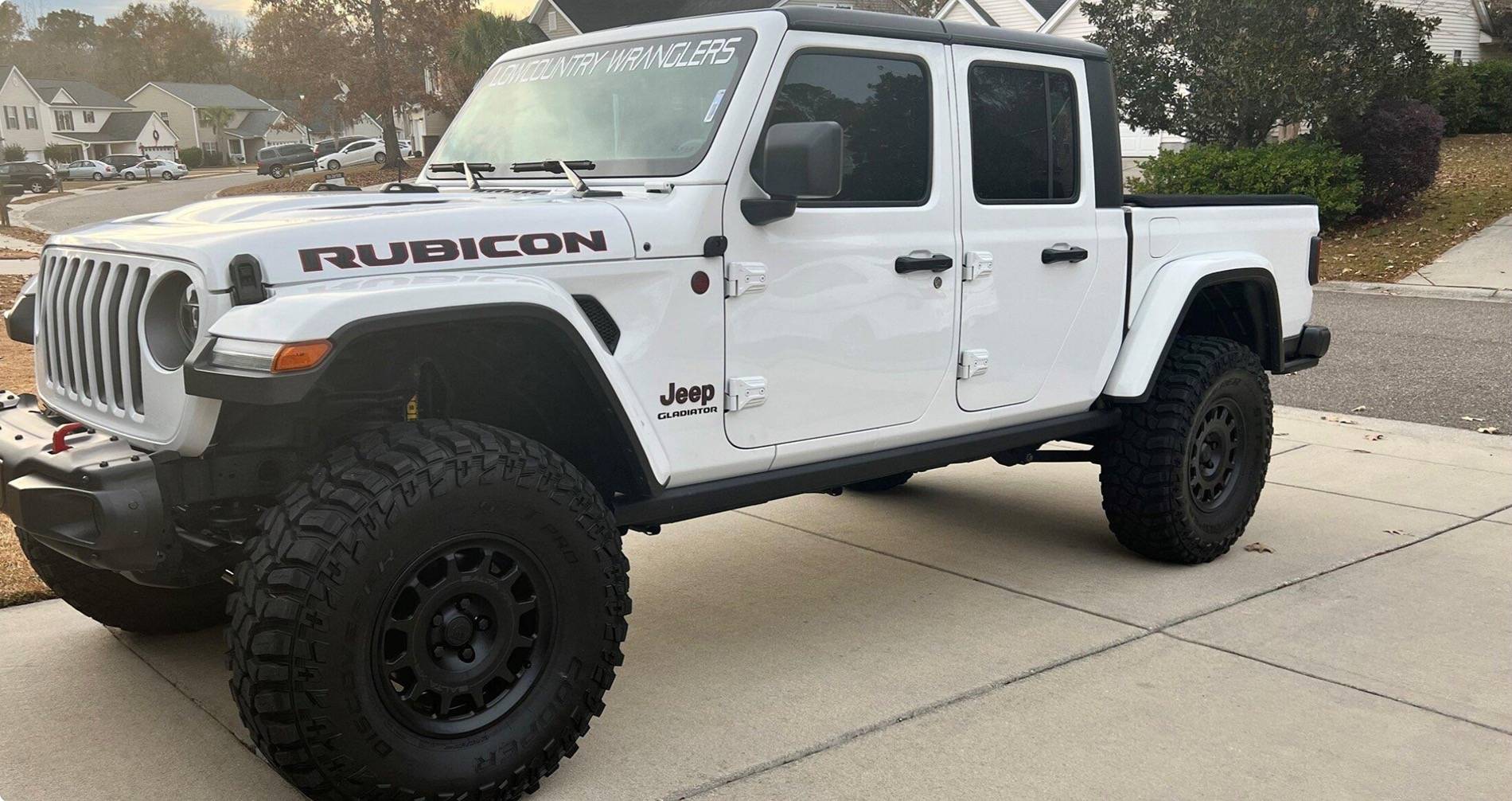

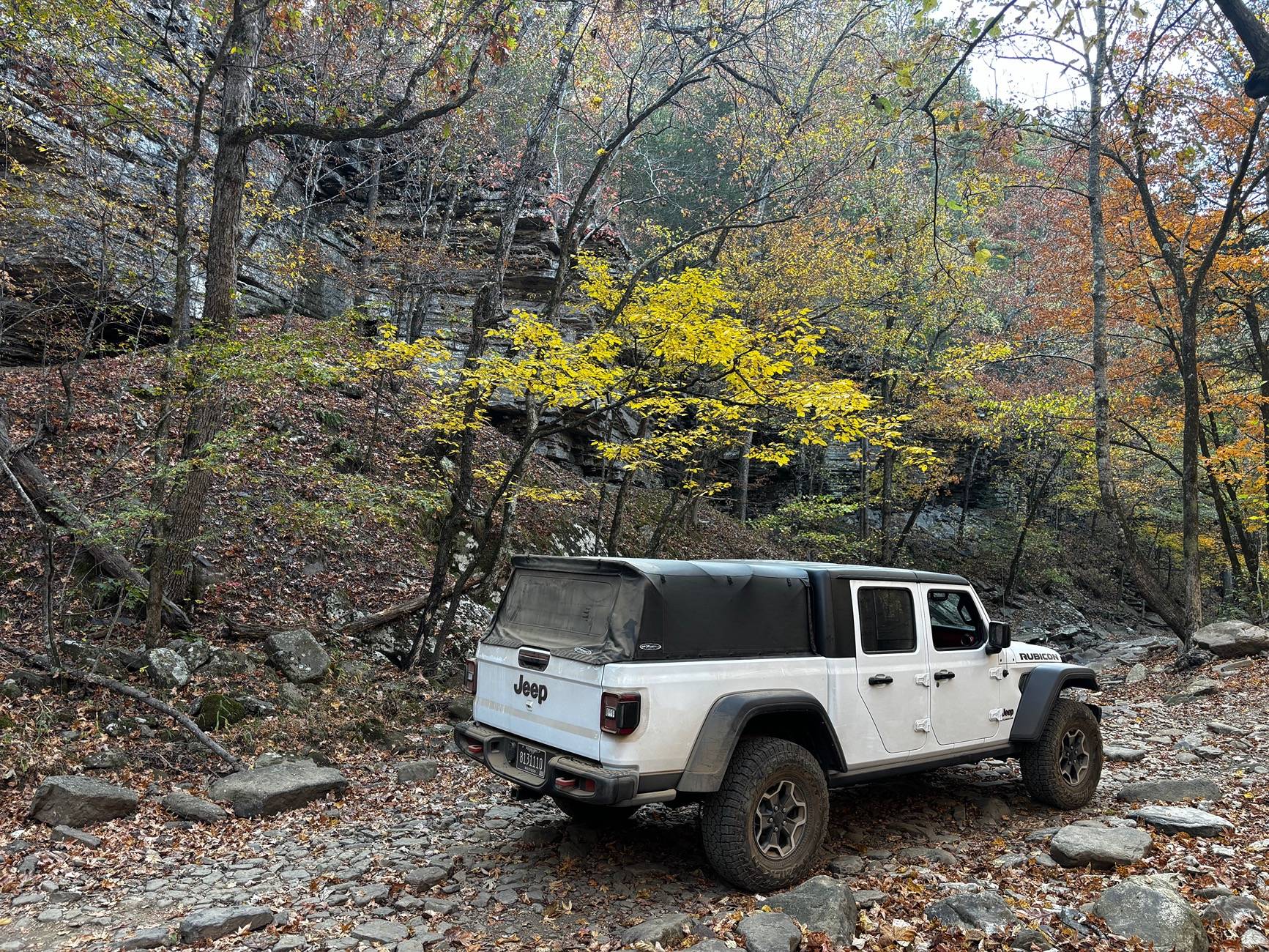

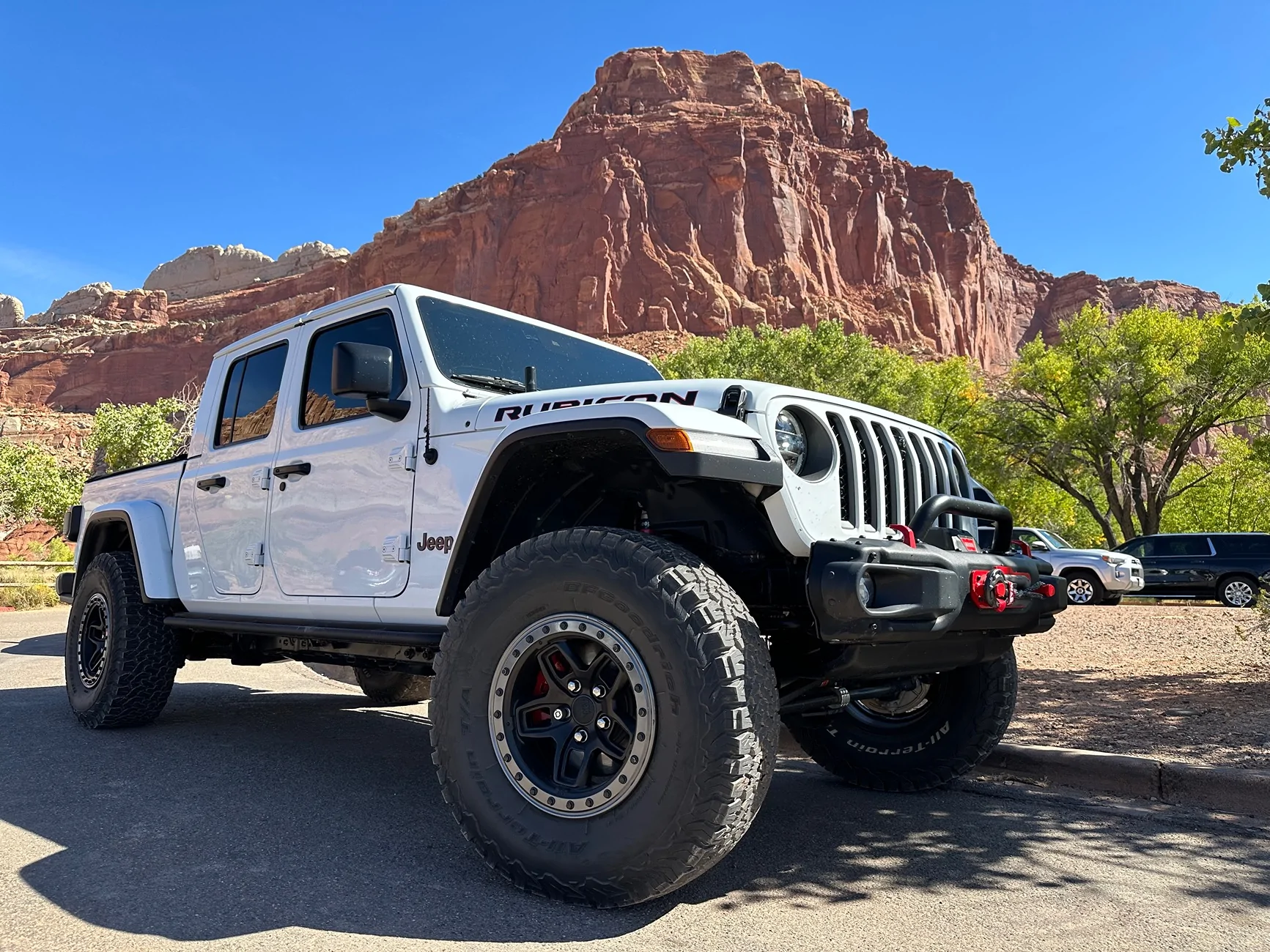

I am looking at purchasing the Borah or the salta XR but am torn on which one I like more. Both would be satin black and I would get the satin black protection ring for the Borah. I like the idea of having the added protection for banging up against rocks but I also like the looks of the salta. Help me decide and add any info from your experience or opinions that would help influence decision. Thanks
included couple pics of my jeep for reference
Jeep Gladiator AEV Borah vs Salta XR IMG_1562
Jeep Gladiator AEV Borah vs Salta XR IMG_1797
Jeep Gladiator AEV Borah vs Salta XR IMG_2689
Jeep Gladiator AEV Borah vs Salta XR IMG_2690

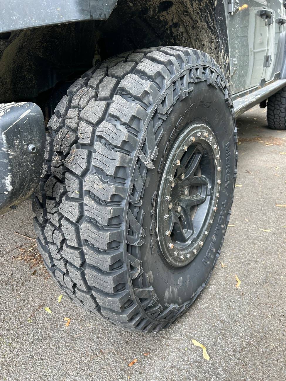

For the Borahs: Are you adverse to removing/installing 120 bolts when the time comes to replace your tires? (24x5 wheels).
I wouldn't trust just any shop to do this work. Even though they are not beadlocks the bolts need some amount of attention when being installed and removed. 20 ft. lbs of torque only. Don't want some generic tire shop ramming them down with an air ratchet until it won't go anymore.
I have the onyx with silver protection rings.

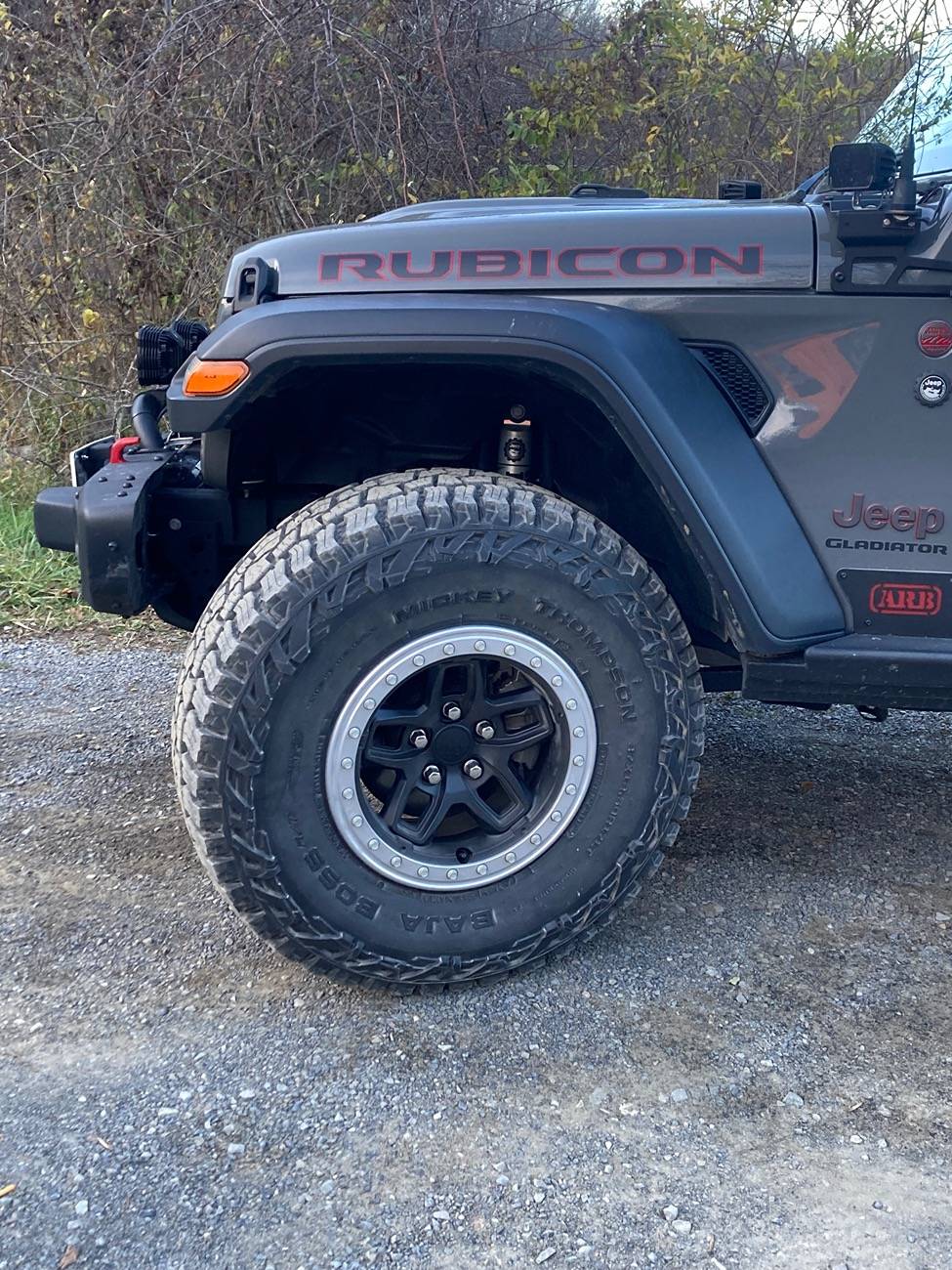

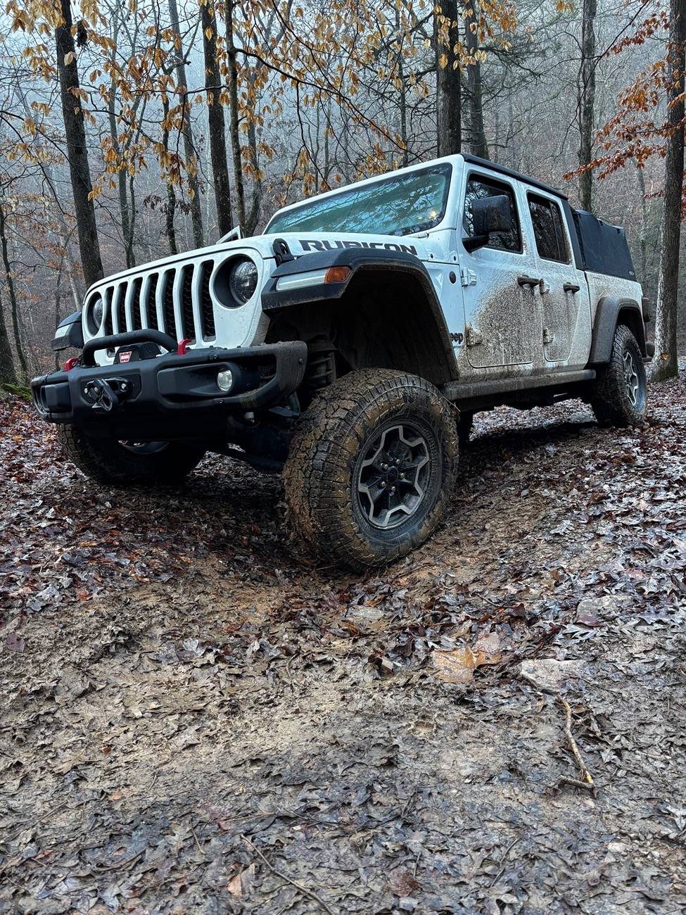

I have Borahs and love them. I like having the ring to take all the abuse of the rocks on the trail.
