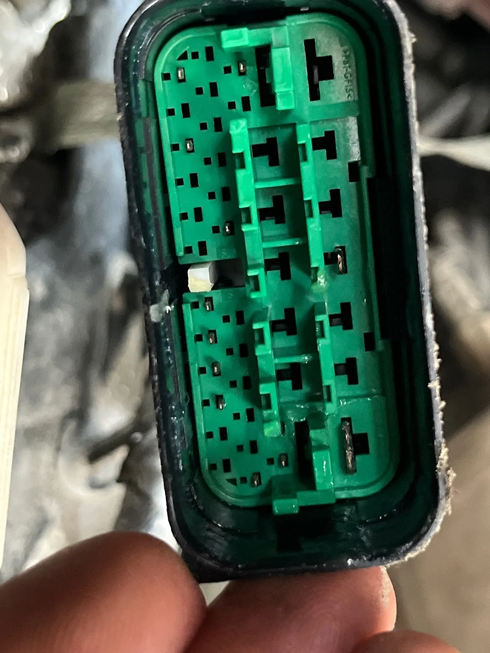

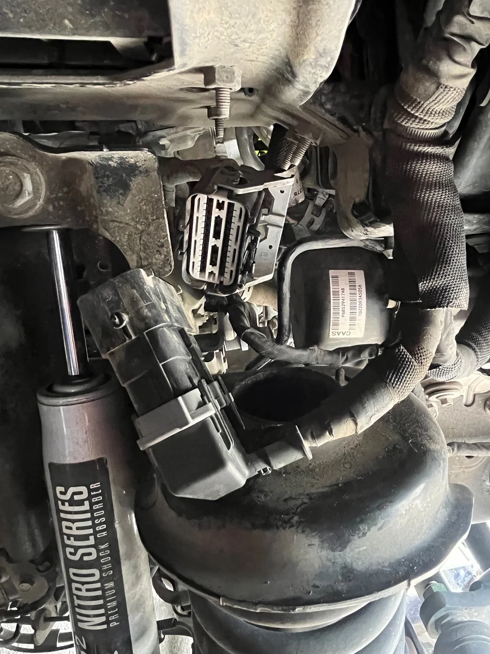

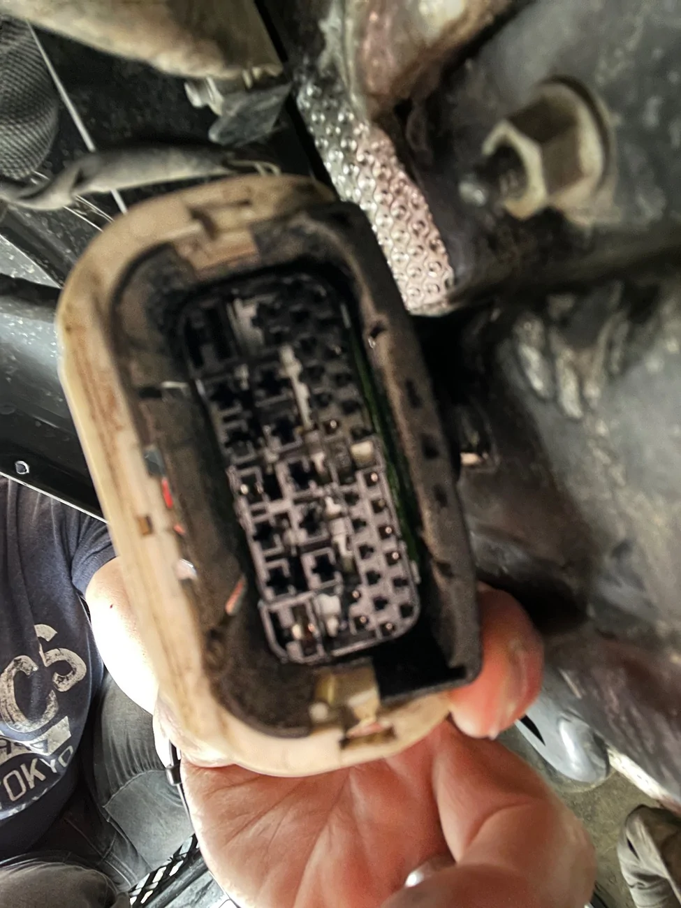

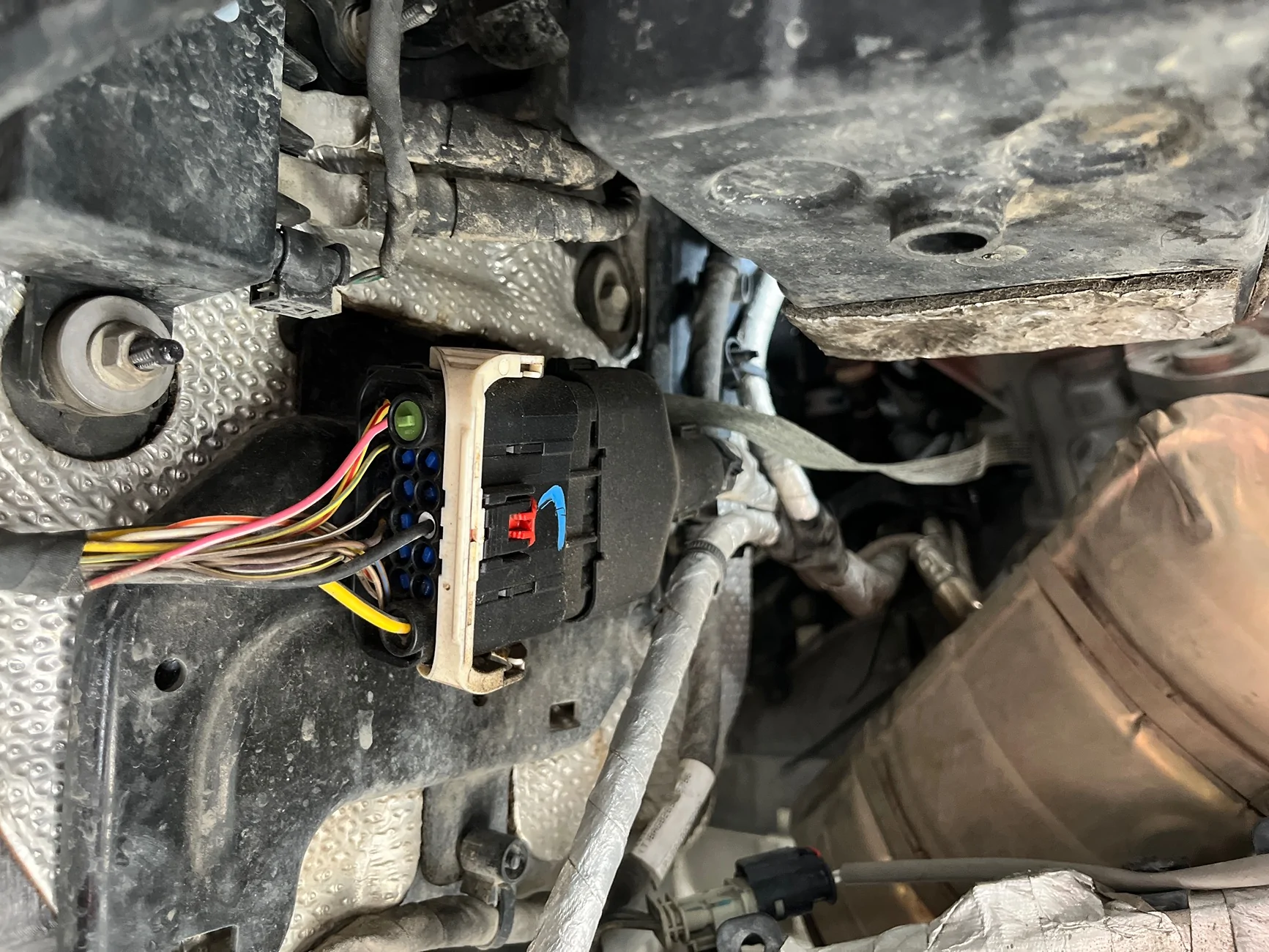

Today, as a proactive step, I got under the passenger front wheel liner and took apart the TCM connector and the big a$$ FAD connector and flushed out the pins out with electrical cleaner DeoxIT D5 followed by DeoxIT Sn5 and put them back together. This just ensures great pin contact and trouble free communication.

Jeep Gladiator 4WD and Transmission Lights IMG_4924
Jeep Gladiator 4WD and Transmission Lights IMG_4922
Jeep Gladiator 4WD and Transmission Lights IMG_4921
Jeep Gladiator 4WD and Transmission Lights IMG_4917
