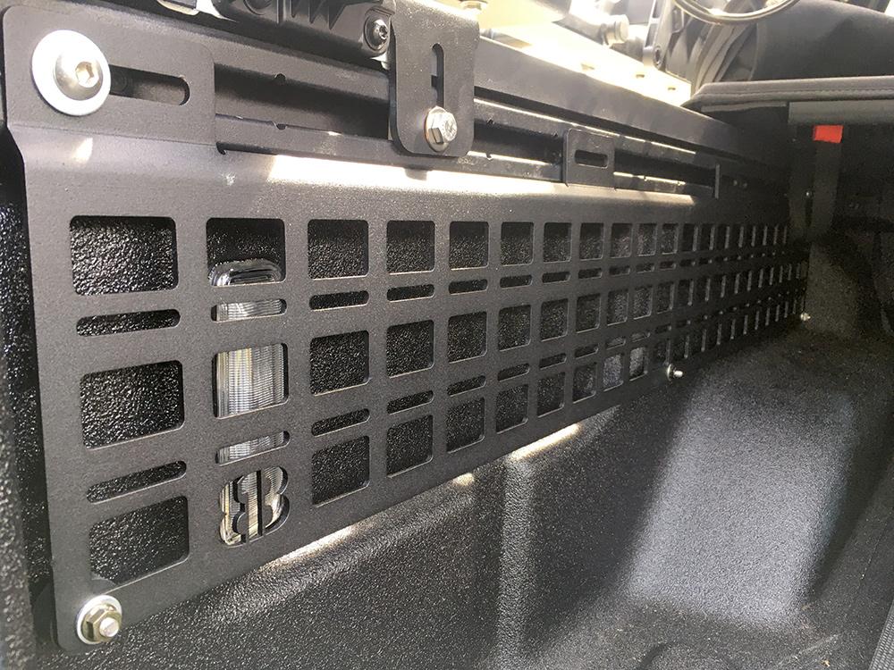

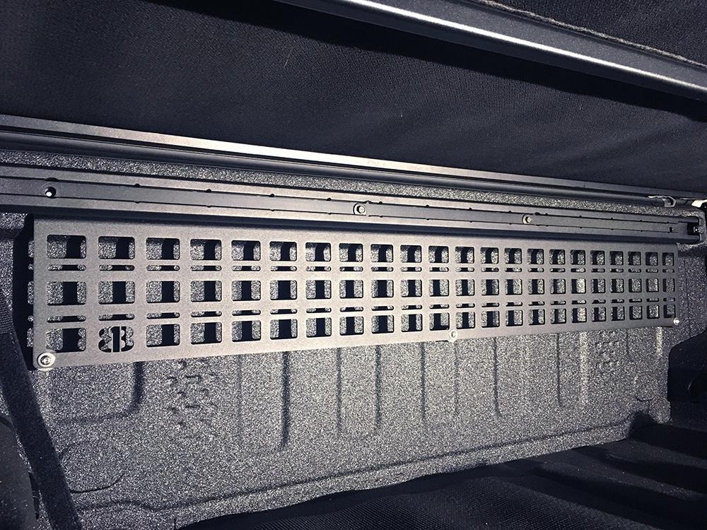

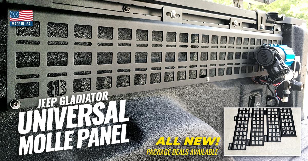

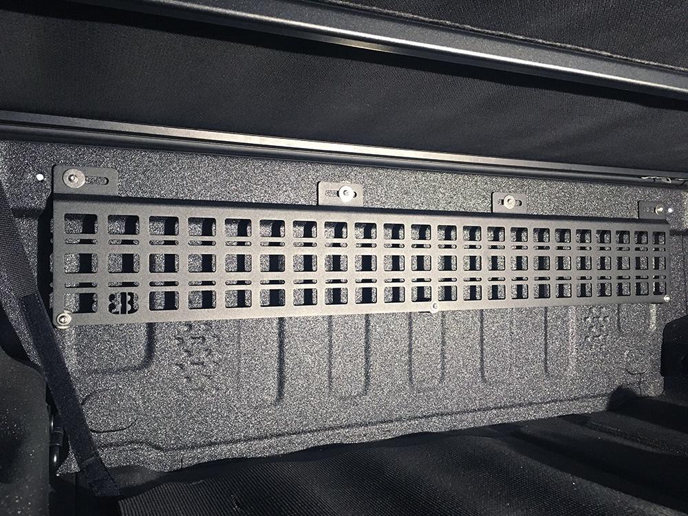

Now Available! Our new Universal MOLLE Panel for the Jeep Gladiator. The panel mounts on either left, right or cab side of the bed depending on the hardware used. The panel leaves space for the bed organizer indentions as well as some lower space on the cab side for longer loads. 1/8" powder coated aluminum. Package deals are available at www.813fabrication.com!

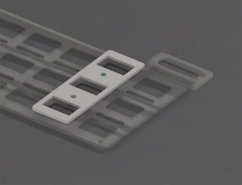

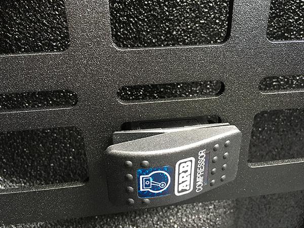

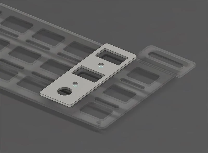

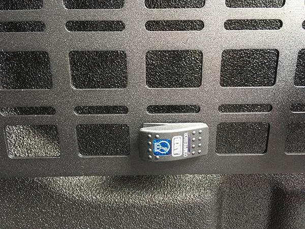

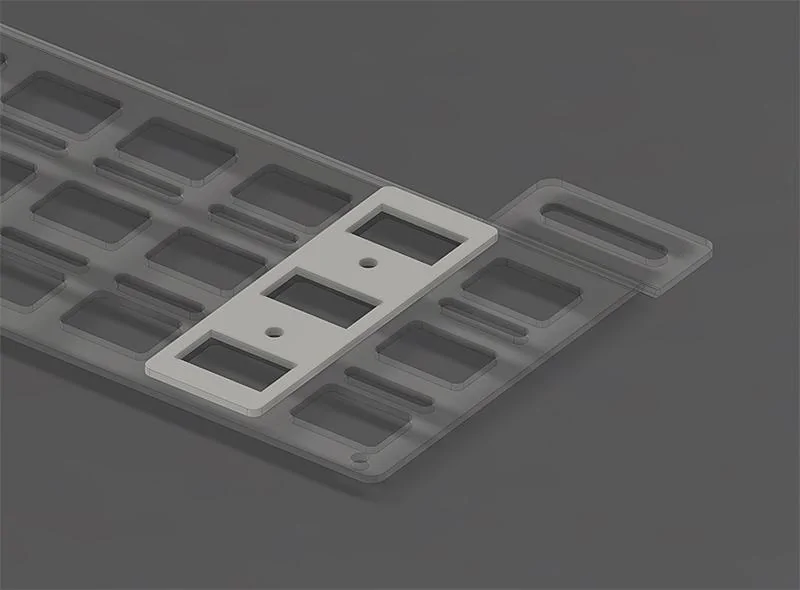

I had someone ask me about mounting a rocker switch plate/3 rocker switches to our Universal MOLLE Panel. So, my wife and I were kicking around some ideas last night. Turns out, the MOLLE panel is the perfect length hole for a rocker switch! They click right in. If only putting the rocker switch in there is a little play from side-to-side, but the switch is locked into place. A little more shallow rocker switch should work great. The ARB switch is a bit taller than some other rocker switches, so it does not have enough clearance to sit directly into the MOLLE panel, almost, but about 2mm too tall. So, I designed a few switch plates that will raise the switch up some from the panel and give a little more clearance, hopefully enough for 90 degree wire connectors. But, a few spacers under the switch plate would for sure work. I also did a plate with 2 switches and an air chuck hole. If using spacers, it would allow using the JIC-4 air chuck from ARB with a 90 degree elbow. If the MOLLE is mounted on the cab side, I believe it would have plenty enough space behind the panel, since it has an inch or so behind the panel on that side. So, this makes our new Universal panel even more versatile!
