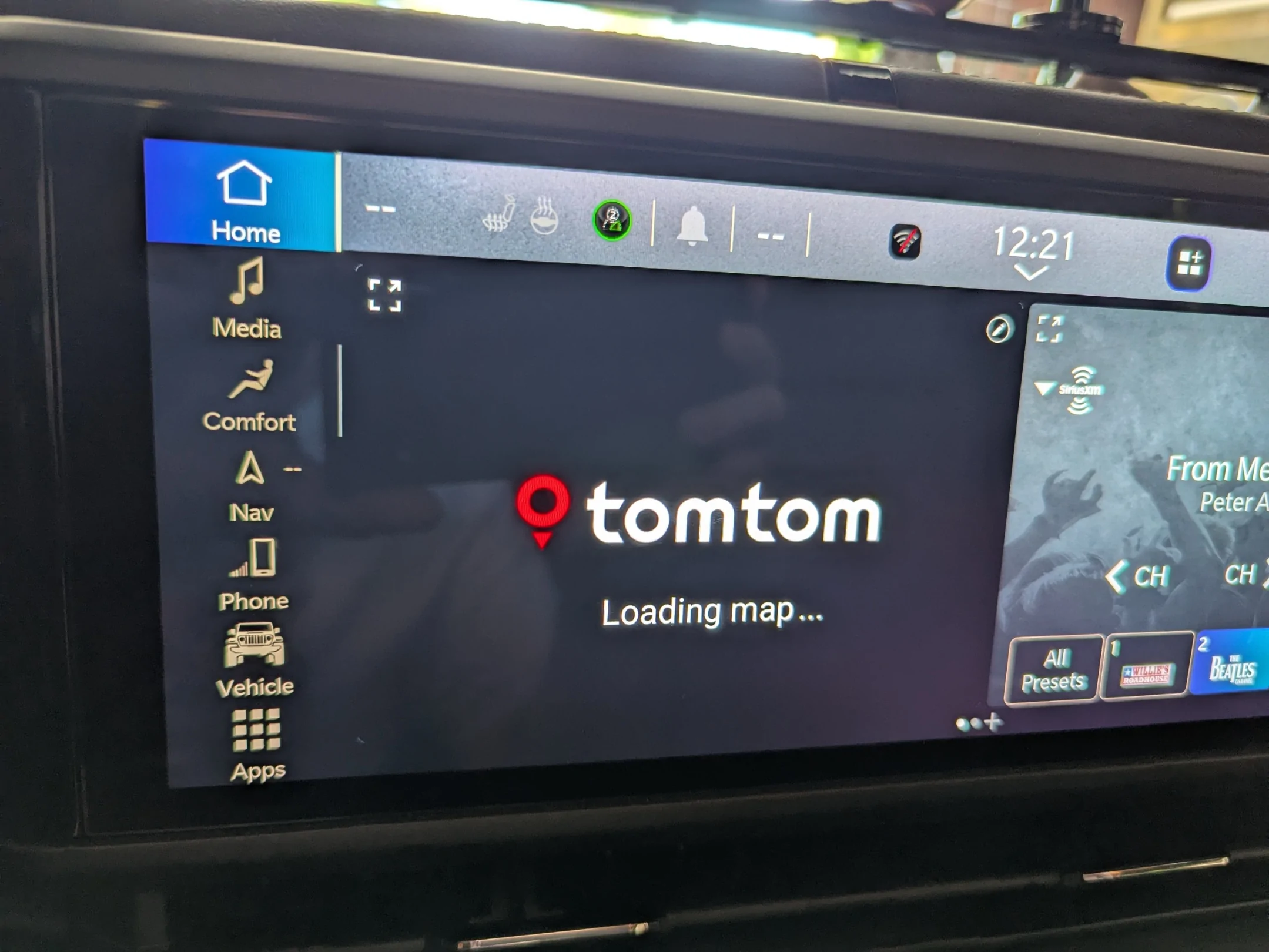

to this point, my electronics have been perfect (at least I recall no issues in the first two)
Will ride this out and see if it self-corrects. It has been this way all day, each trip.
Ironically, when I put it on full-NAV, that works. It's only this screen that's frozen in time.

Put the key on acc. Then hold both volum and tuner buttons down till the screen goes dark to do a reset.
"radio, heal thyself".
Went out at 6am for my trip to the doctor and it was fine, in fact, I didn't see a loading maps screen at all.
Not sure if there was some update, or it seriously had trouble loading maps and hung, or what (because it worked fine in the full-screen NAV setting)

My 2024 JT Rubicon X did a TomTom update while I was driving a few days ago. The screen was like yours, but it only took about 2 - 3 minutes to update, then install. No lock-up problems.
