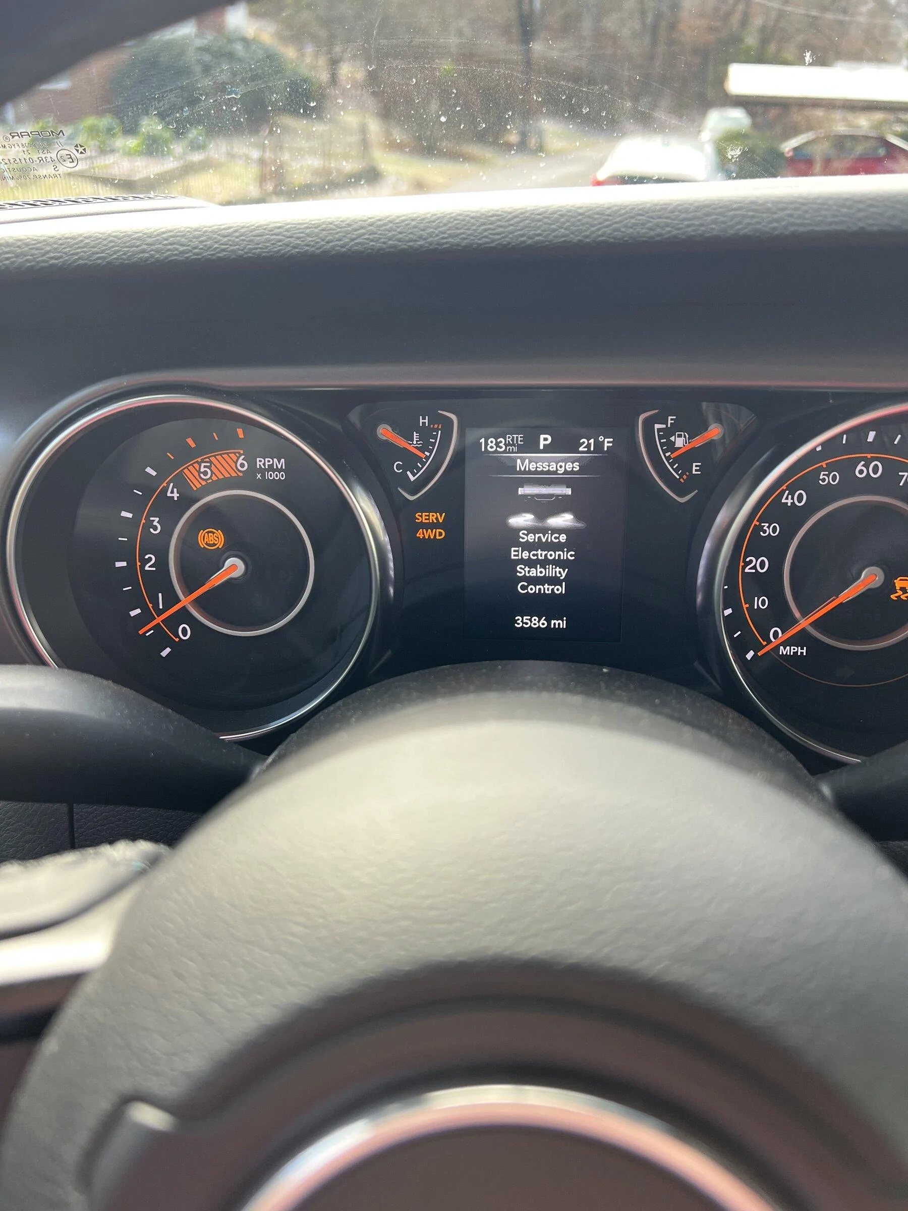

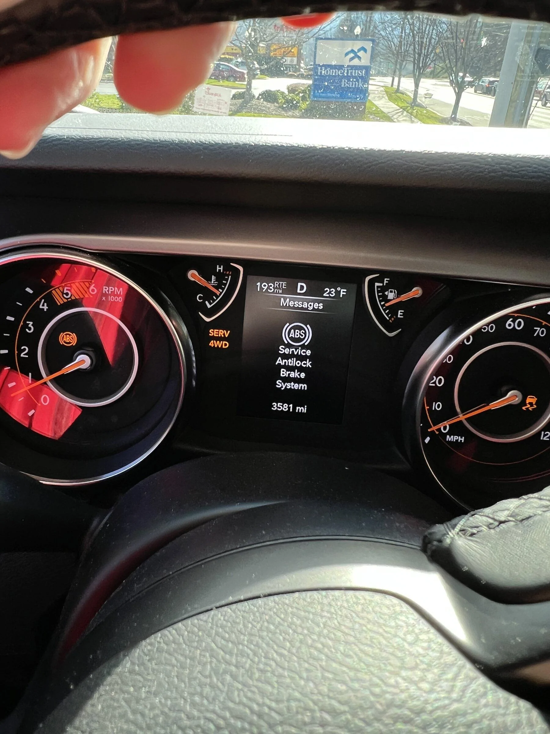

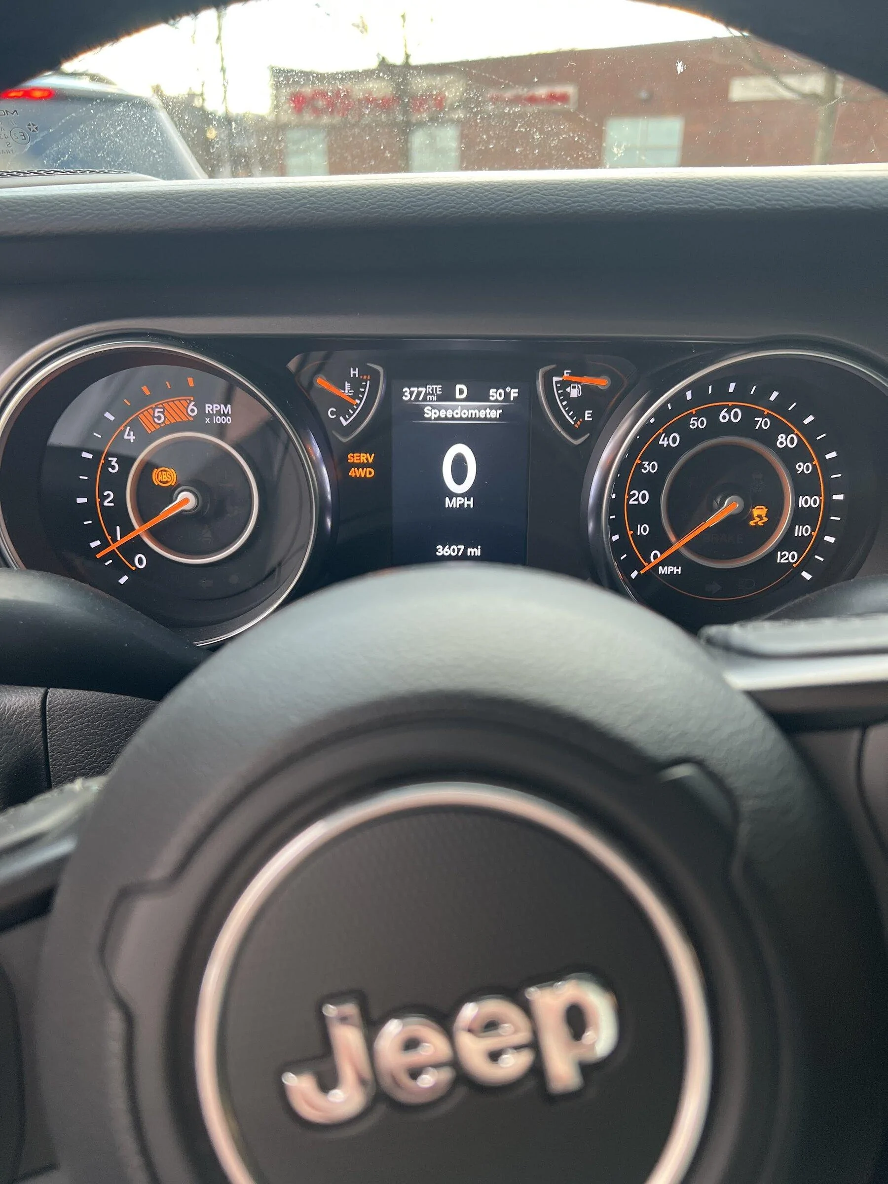

Started with just the ABS pump randomly kicking on and now randomly kicks on and also pops the ABS, TC and Service 4X4 lights and pops up the Service ABS and Service Electronic Stability Control messages.
It happens randomly when braking, coasting, or accelerating.
It doesn't happen at highway speeds, just around town.
It doesn't matter if on flat ground, up hill, down hill, smooth roads, or rough roads.
The abs pump will activate without activating the lights occasionally and the lights will sometimes come on without the pump activating.
The lights will sometimes come on and then turn off after a few minutes(and keep coming on again at random) and sometimes they will stay on till I shut off the Jeep.

Dropped it off and they ran the codes which said it was a front left wheel speed sensor. So they are replacing it and we will see.

ok they finally texted me and I picked up the truck and everything seems fine now
here are the notes.
CUSTOMER STATES THE ABS, TRAC, ESC, SVC 4 WHE EL DRIVE LIGHTS ALL CAME ON. PLS CHECK AND ADVISE
SCANNED AND FOUND CODES C0501-00, c0505-00, C 0031-1D, U0415-00 FOR LEFT FRONT WHEEL SPEED SENSOR
SENSOR HAD INTERNAL FAILURE THAT CAUSED ALL WARNING LIGHTS TO APPEAR. REMOVED AND REPLACED WHEEL SPEED SENSOR AND CLEARED CODES. RETESTED. OPERATING AS DESIGNED AT THIS TIME
