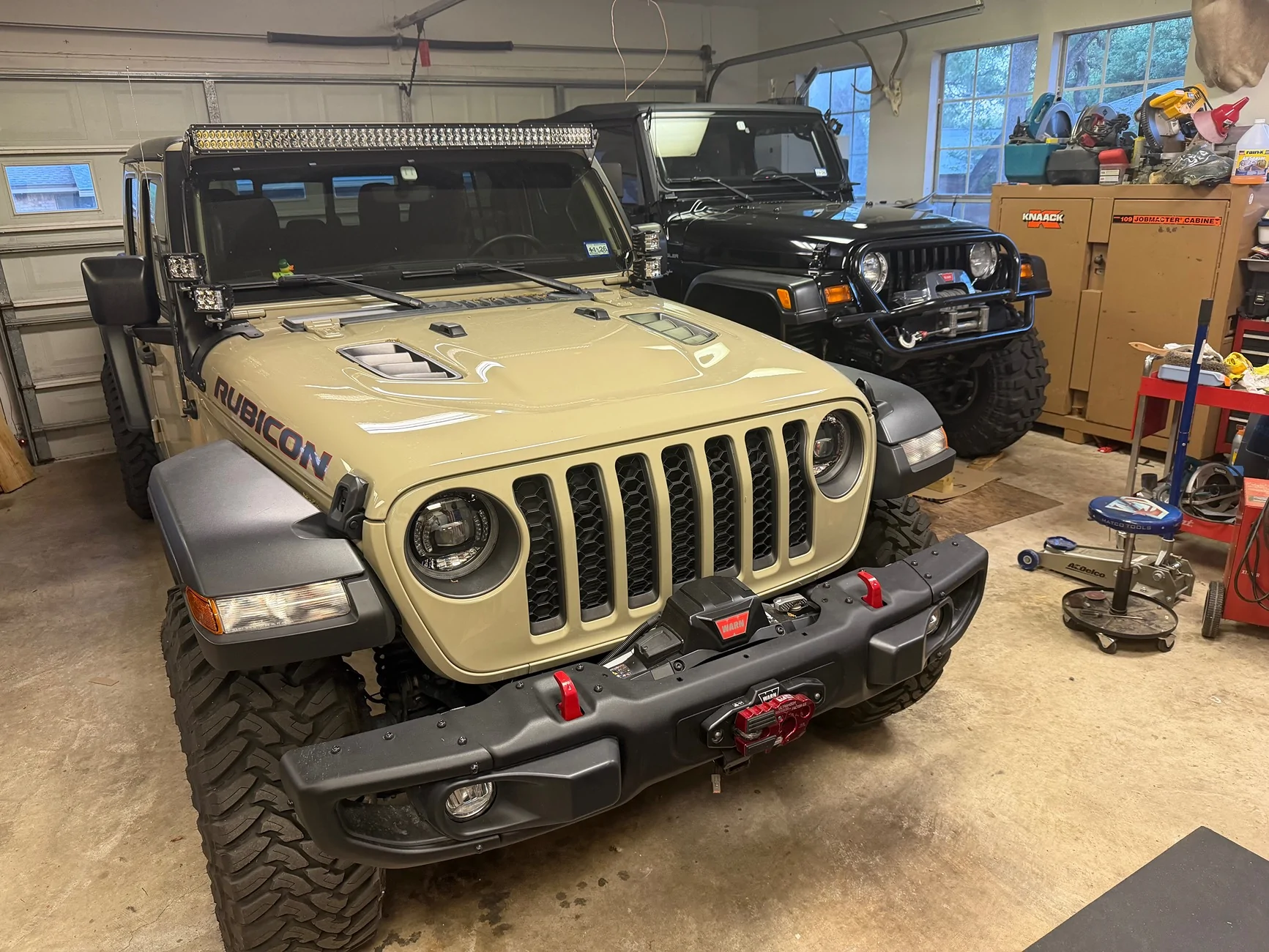

Bandit's Lair, I agree it's too hot. That was using the voswitch grab bar kit. 40 amp relay with 30 amp fuse. And yes it was blowing fuses. That's when we got a 75 amp Bosch relay and ran 10 gauge wire with an inline Bosch 40 amp MIDI fuse. That brought temp down to the 150's. Light bar is the Rigid industries 50" E series PRO light bar. 49,000 lumens. Also has 4 Rigid DSS pro ditch lights but they are on a different circuit.
