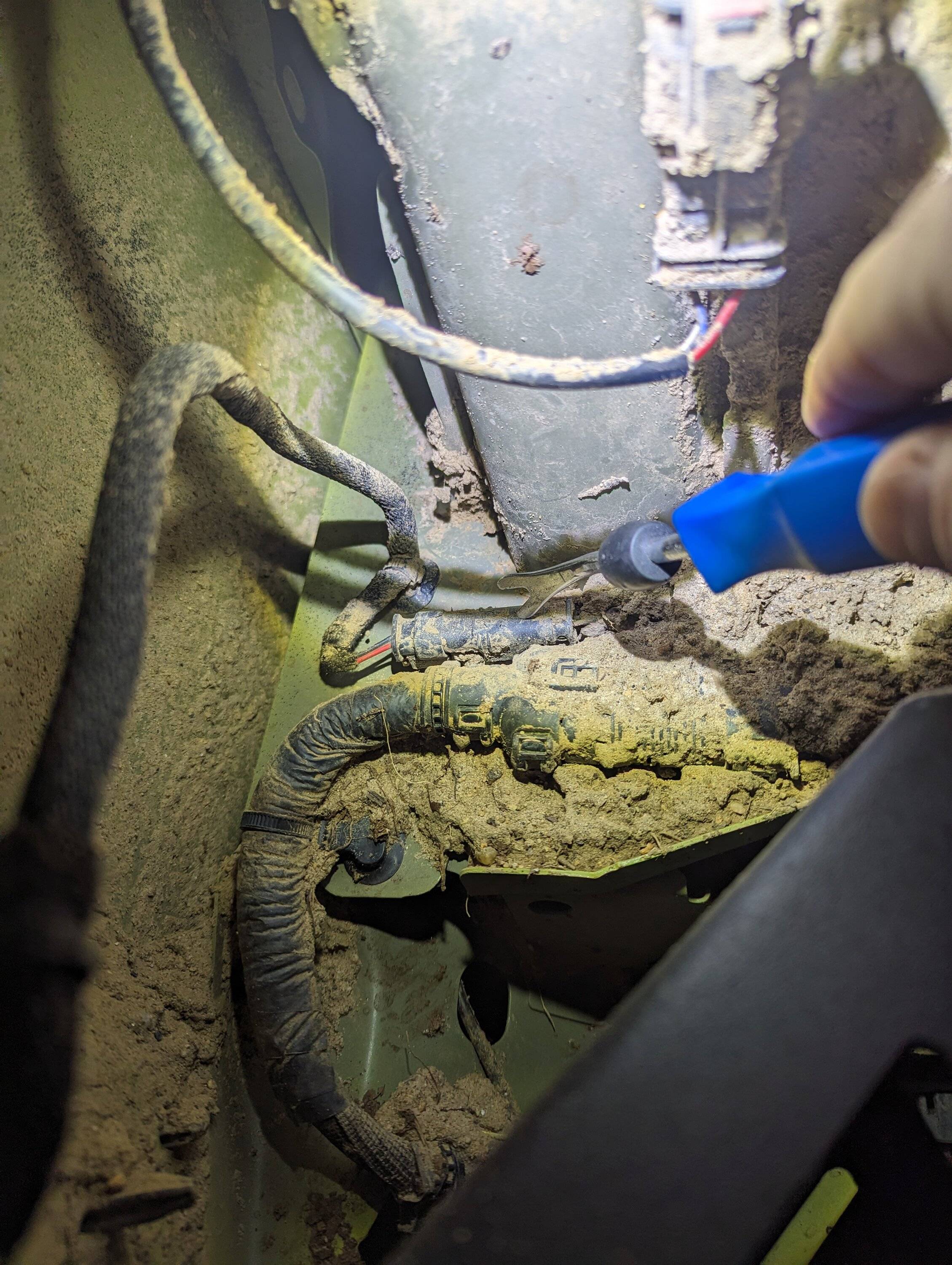

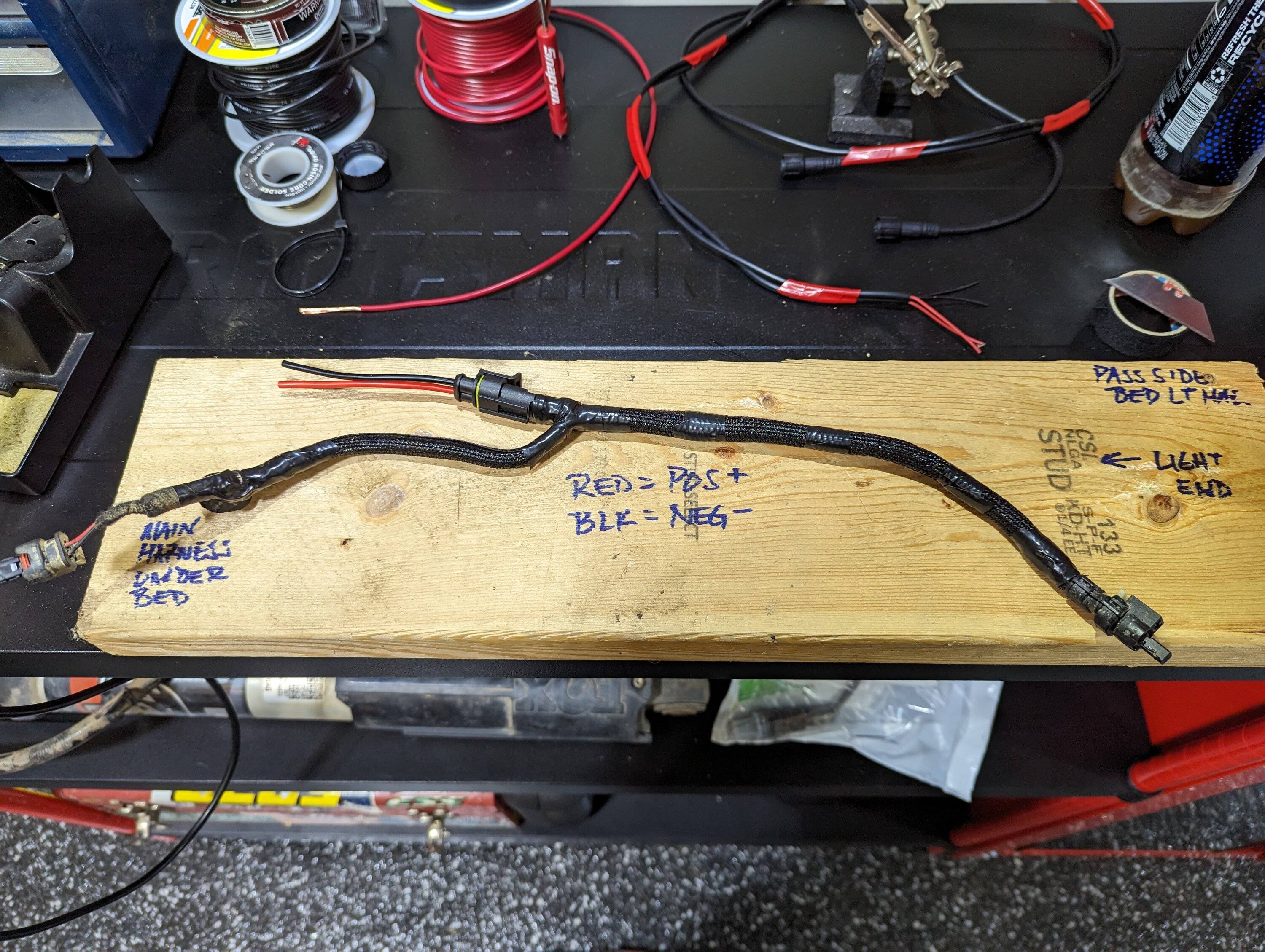

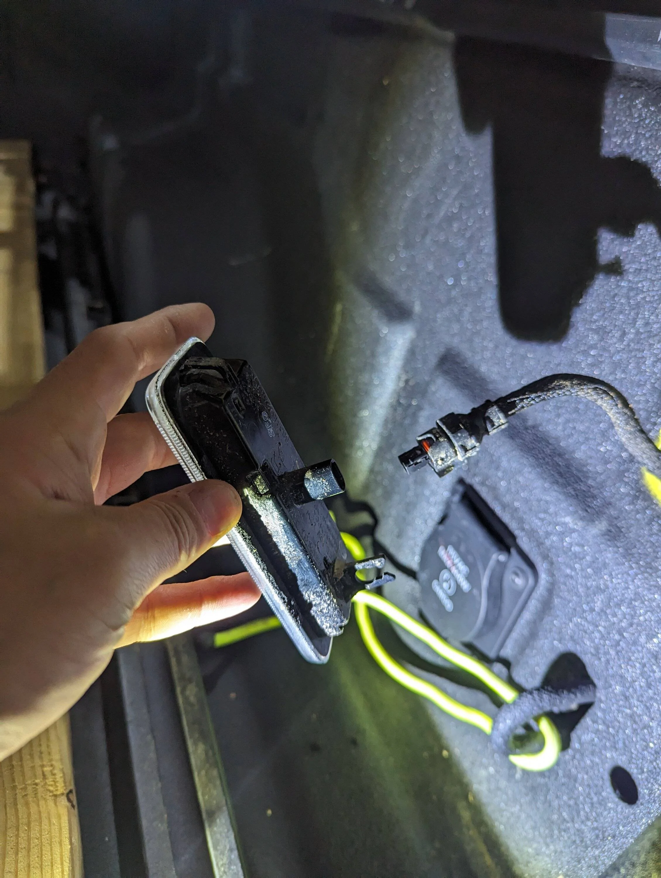

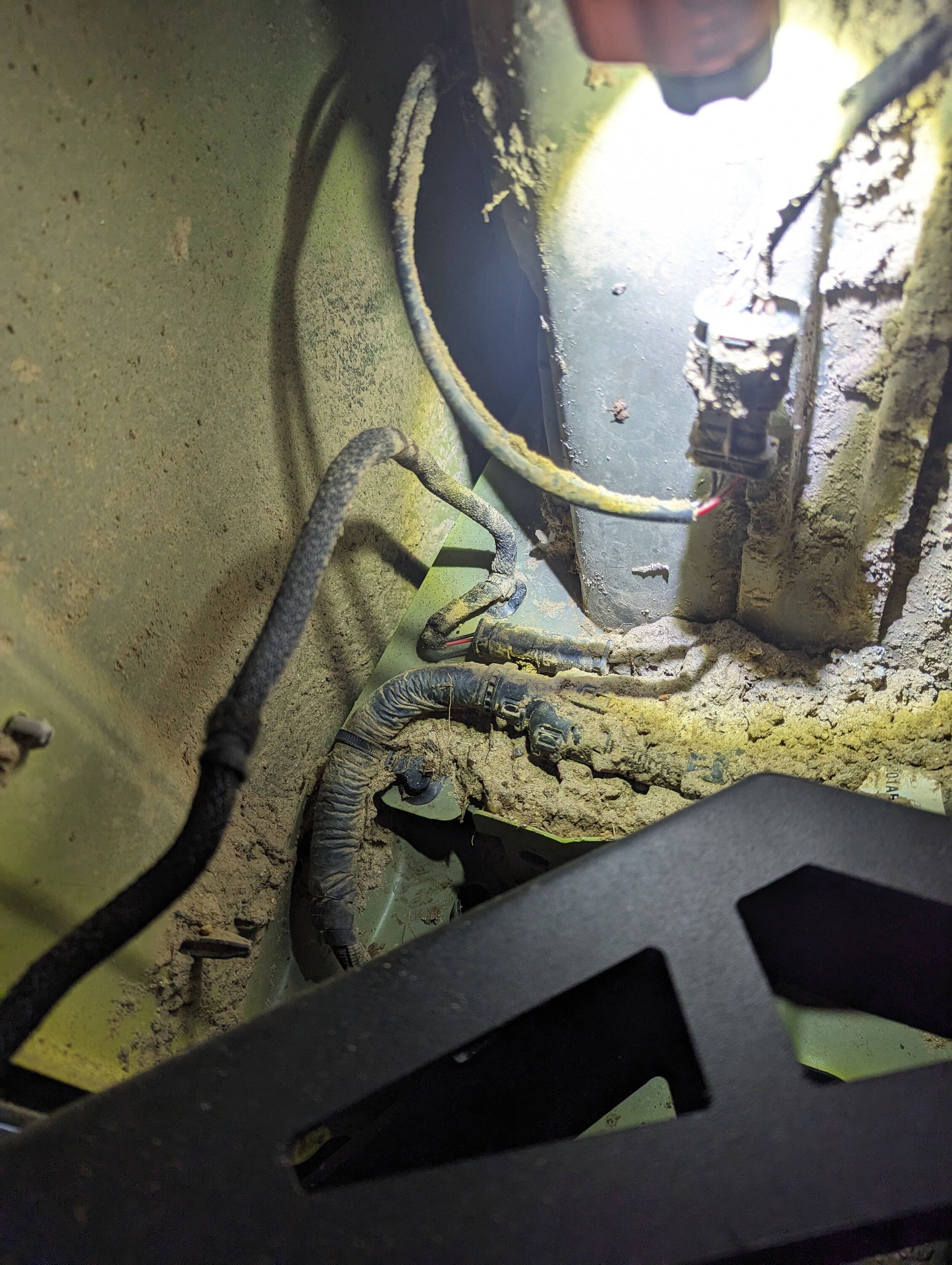

Here's some additional information from my path down this rabbit hole. Solution w/o pics is irrelevant right. Here you go.
I have unwrapped the center section so I can strip the wire and solder in my harness to the new bed light harness I'm building
More to follow. Hoping to finish it this weekend.
Jeep Gladiator Adding extra lights to the bed PXL_20240113_155632397
Jeep Gladiator Adding extra lights to the bed PXL_20240113_155918108
Jeep Gladiator Adding extra lights to the bed PXL_20240113_155942168
Jeep Gladiator Adding extra lights to the bed PXL_20240113_160032701
Jeep Gladiator Adding extra lights to the bed PXL_20240113_161254129

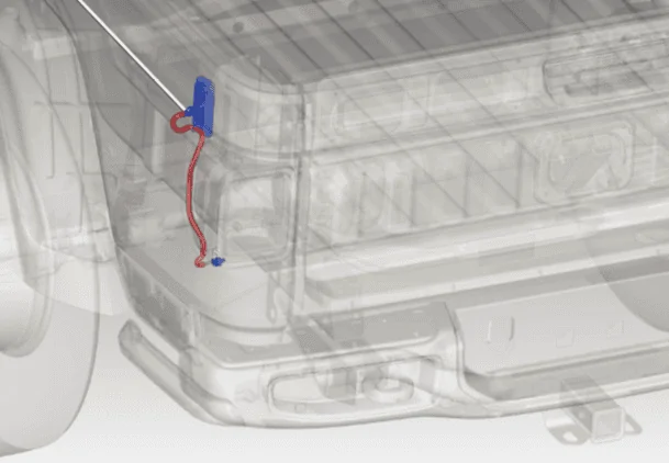

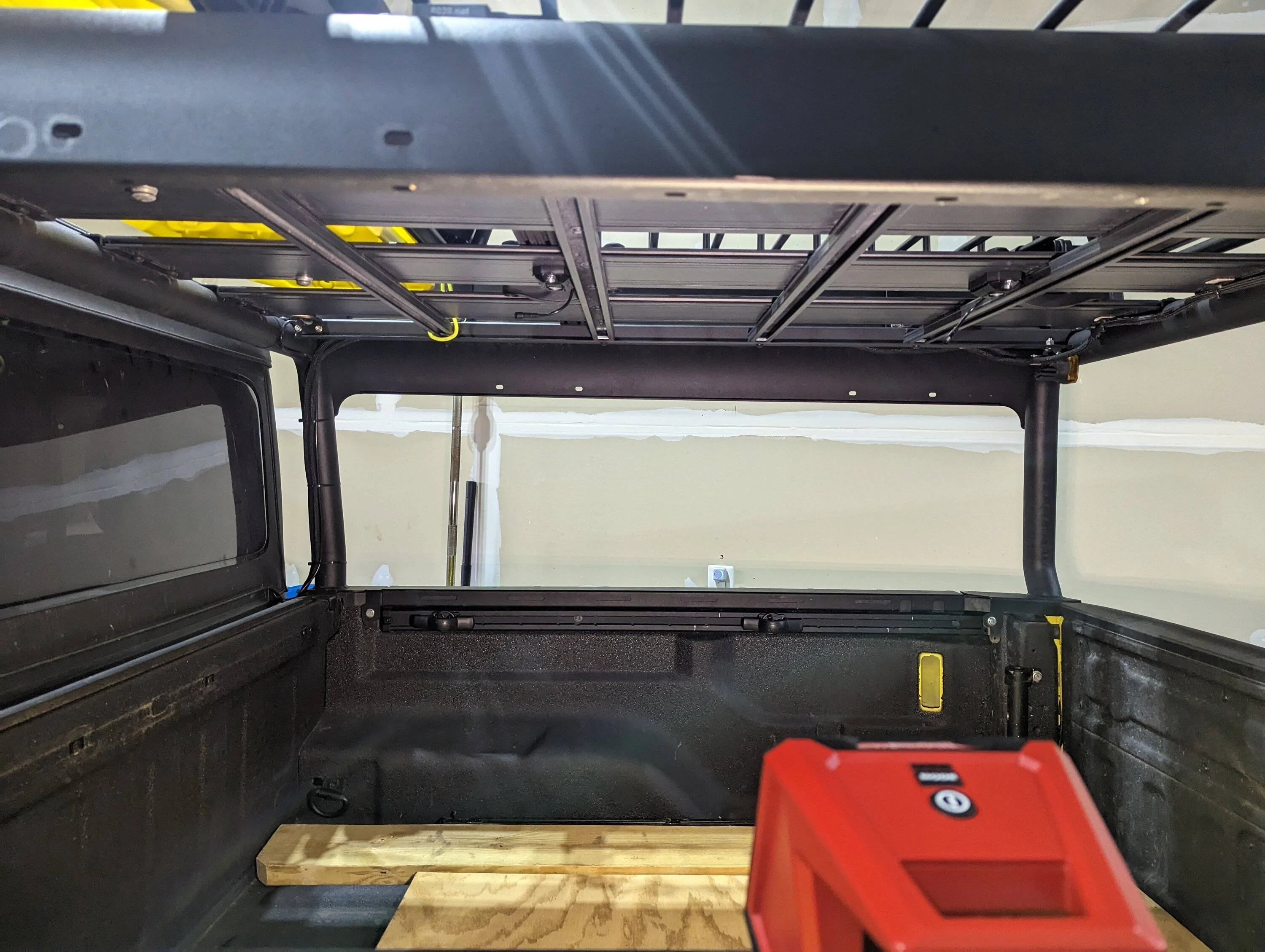

Why did I go about it this way, well the bed lights already have a switch and secondly they will activate when the truck is locked/unlocked. Finally, I can keep an eye on cargo at night while driving.
I just learned the other day you can turn on the bed lights while in motion/driving......that's handy. In my Colorado I can only turn them on while in park.
This came about yesterday while doing the fender chop on my buddies JTM. He had a extra 4 rock lights from his JKUR, so he installed 2 on his and gave me the other 2. He mounted both of his to the rear over the tailgate so he could have useful light while taking gear out of his Decked system. He also has the Maximus 3 rack.

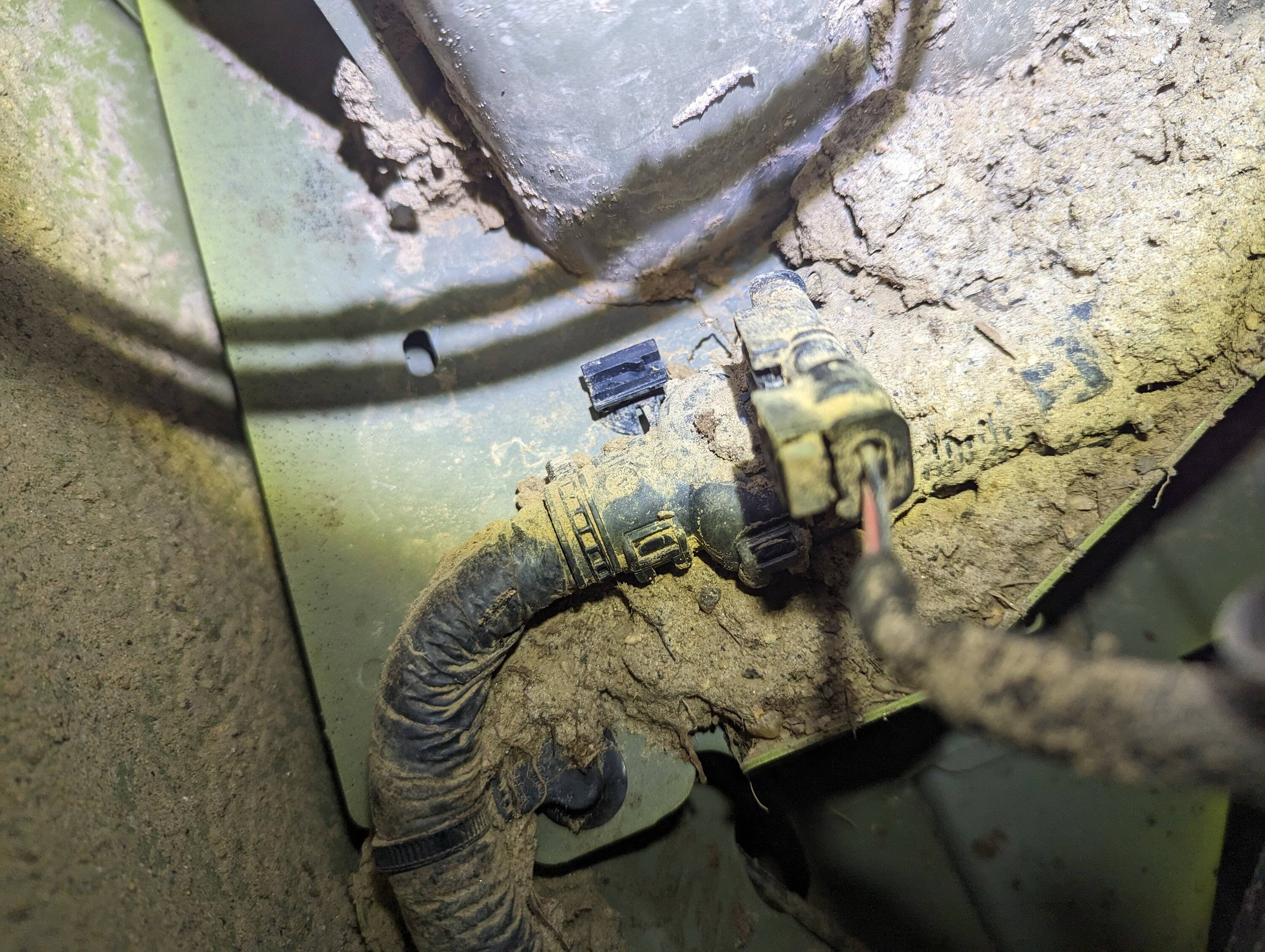

Factory harness with a pigtail added

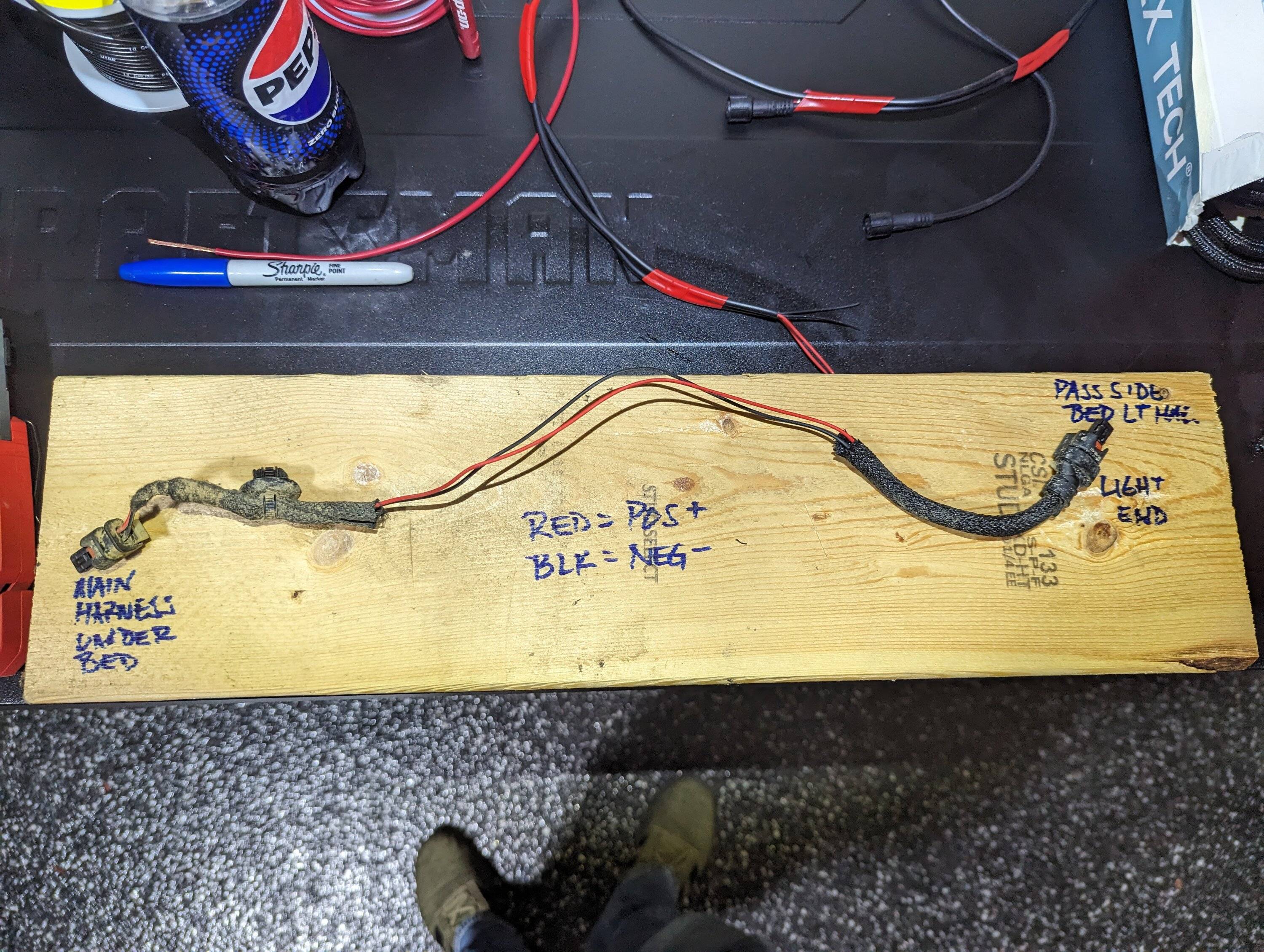

Harness tapped and ready.
I've since built the harness and installed. Everything works as desired; either via the switch or when the truck is locked/unlocked.

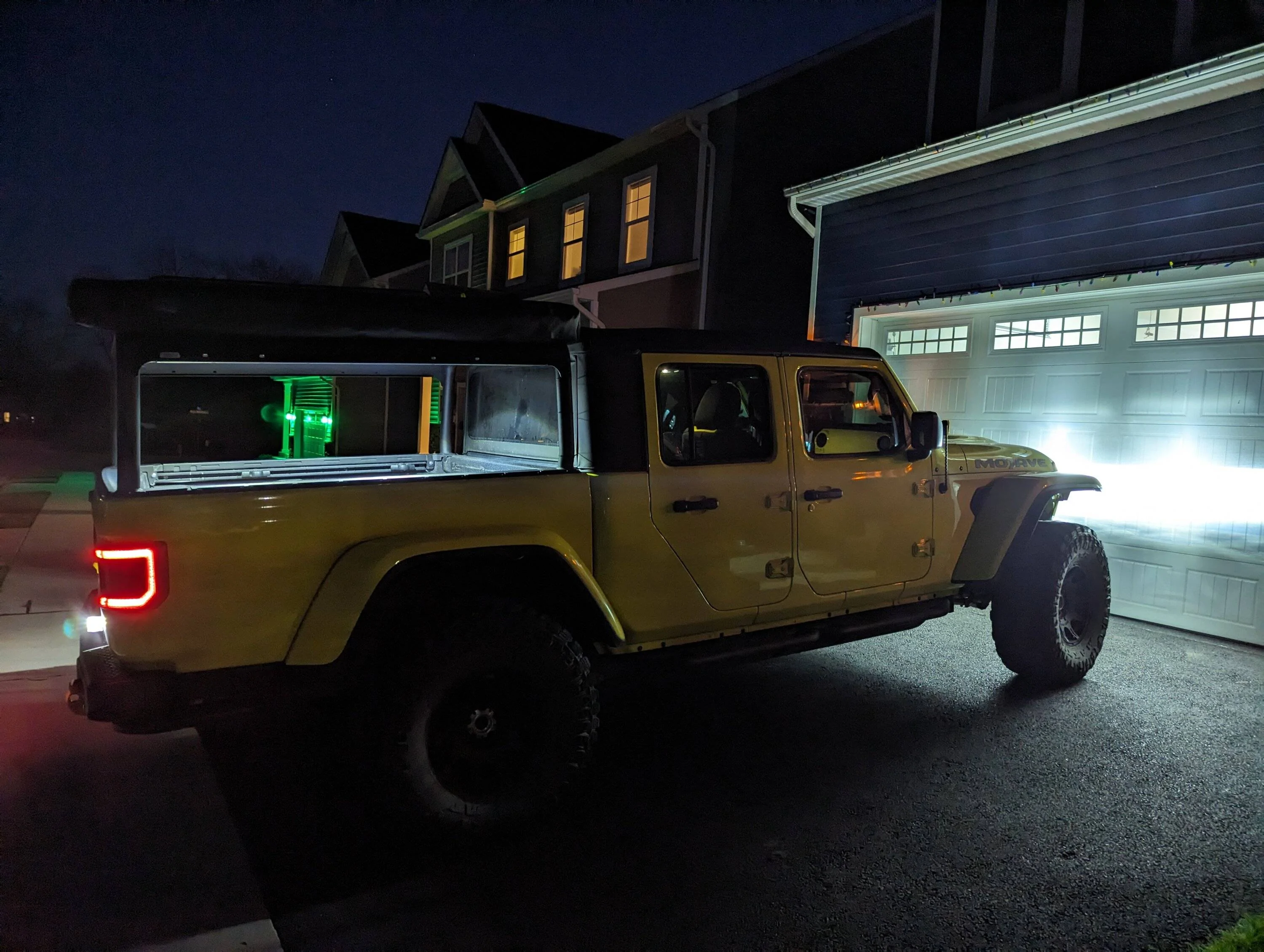

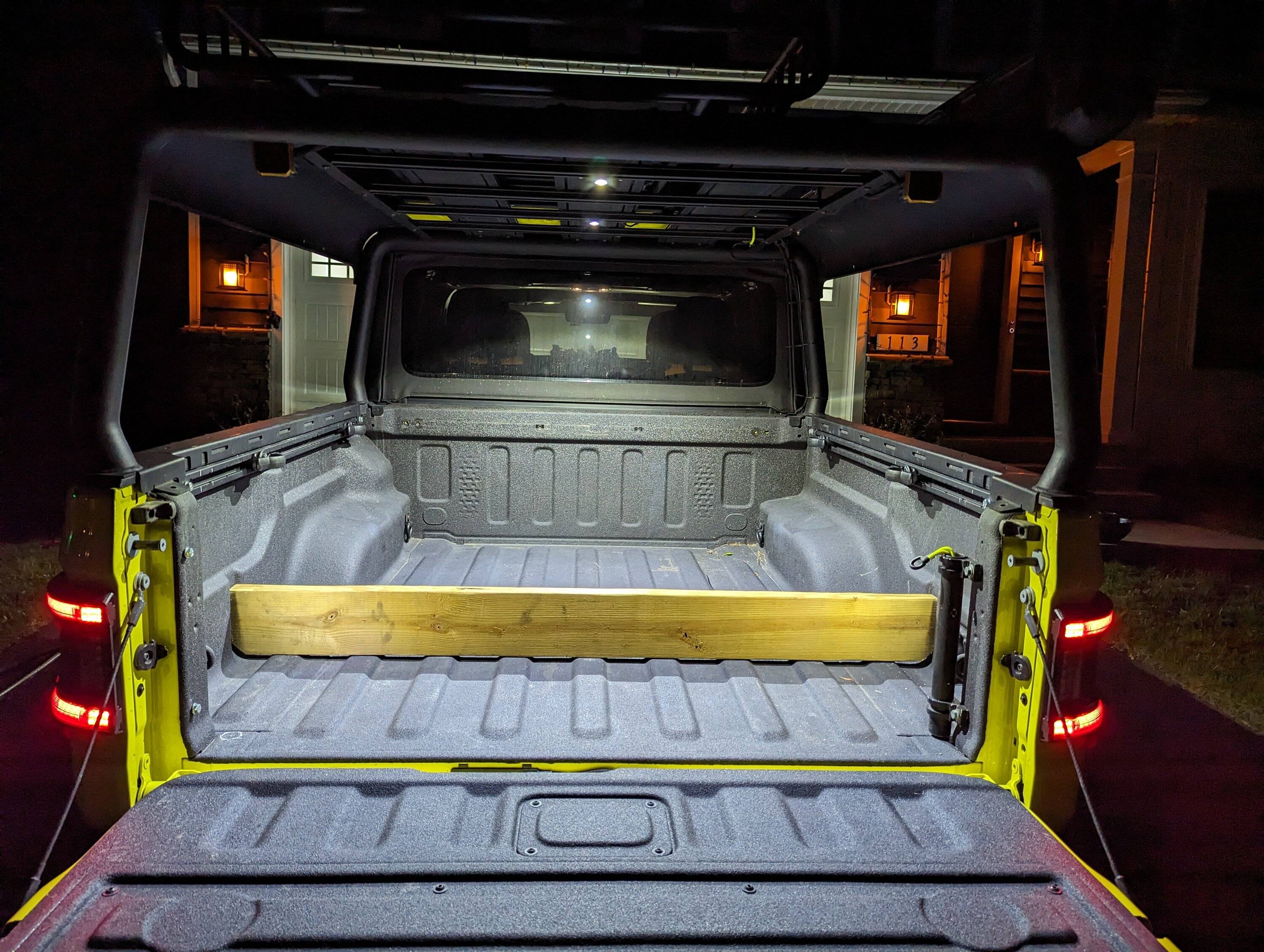

Here's the night time pics/results. This was via just unlocking.....same effect with the OEM switch.
Desired effect was achieved for about $5 in wire and solder.

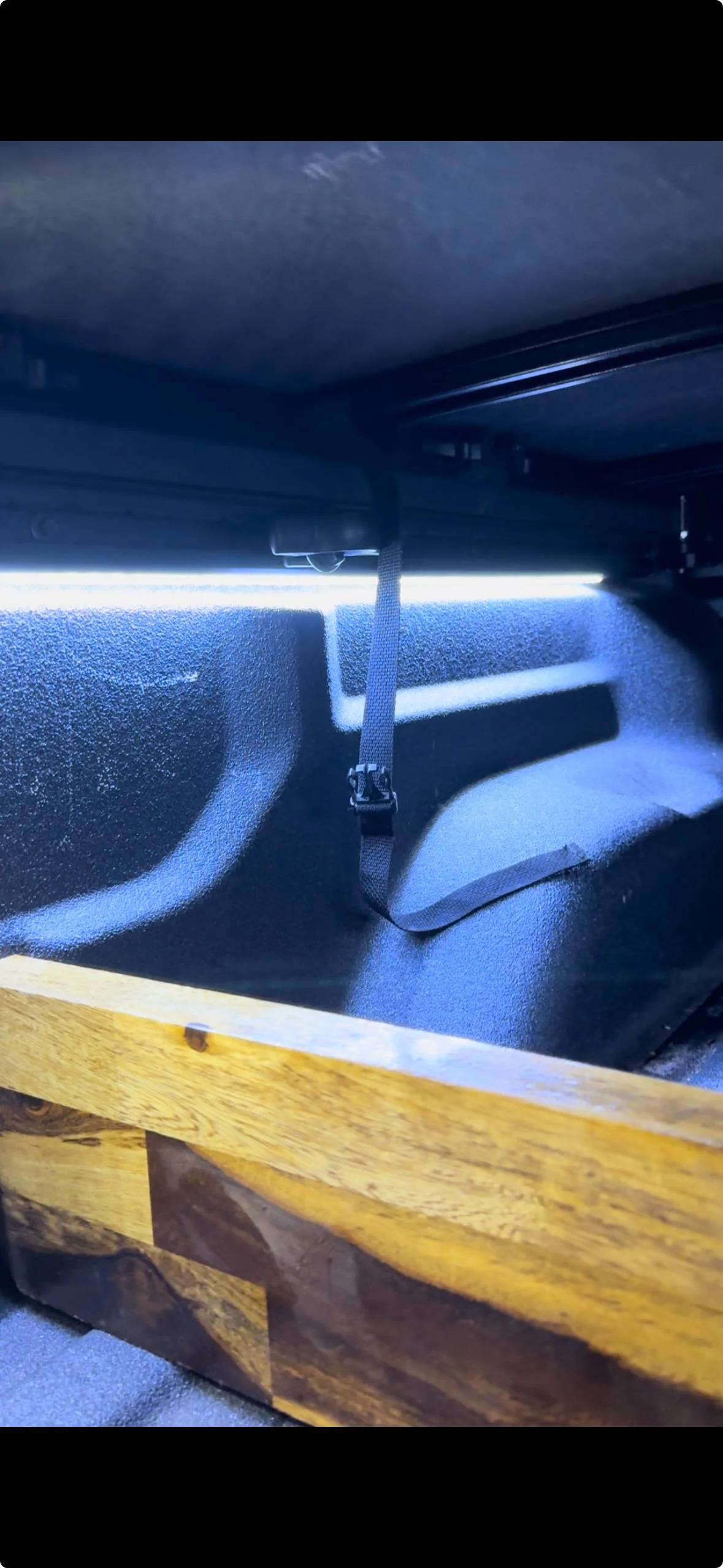

Finally got around to wiring up some waterproof led strip lights. I ended up buying a spool and skipping the fancier options with a switch. I stuck them under the bed rails and wired them into the existing bed lights. Big difference. I wish the lights I bought came with leads about an inch longer than they were, but was able to make it work with only a little stretching ;) .
While the connections are made with those marine heat-shrink splicers, I didn't wrap the wires further inside the bed wall. Certainly not as clean as @Minty JL 's harness.
I ended up drilling ? a hole just big enough for the two wires tiny wires above the existing light, but right below the bed rail and sealed it with some clear silicone. Its almost invisible and pleased with the result.
Jeep Gladiator Adding extra lights to the bed IMG_8C129E1CB244-1
