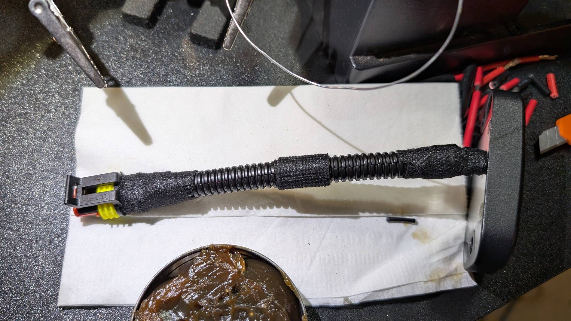

To mount these i bought some 1/8" rubber sheet and cut it to put a layer between the lights and the bumper. To make them easier to replace, I purchased some automotive type connectors and soldered them to each light and finished them off with some wire split loom and cloth tape:
Jeep Gladiator Adding flush mount lights to rear bumper PXL_20241230_215756675.MP

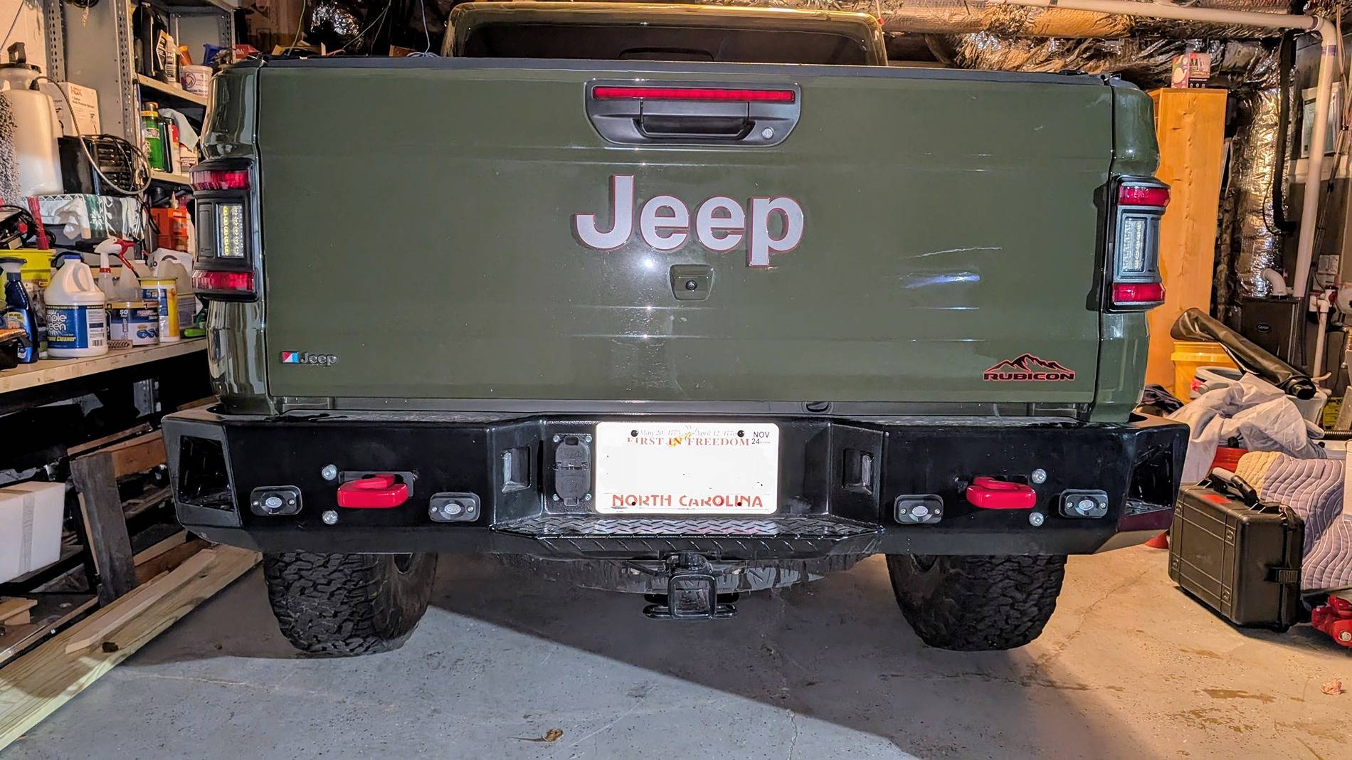

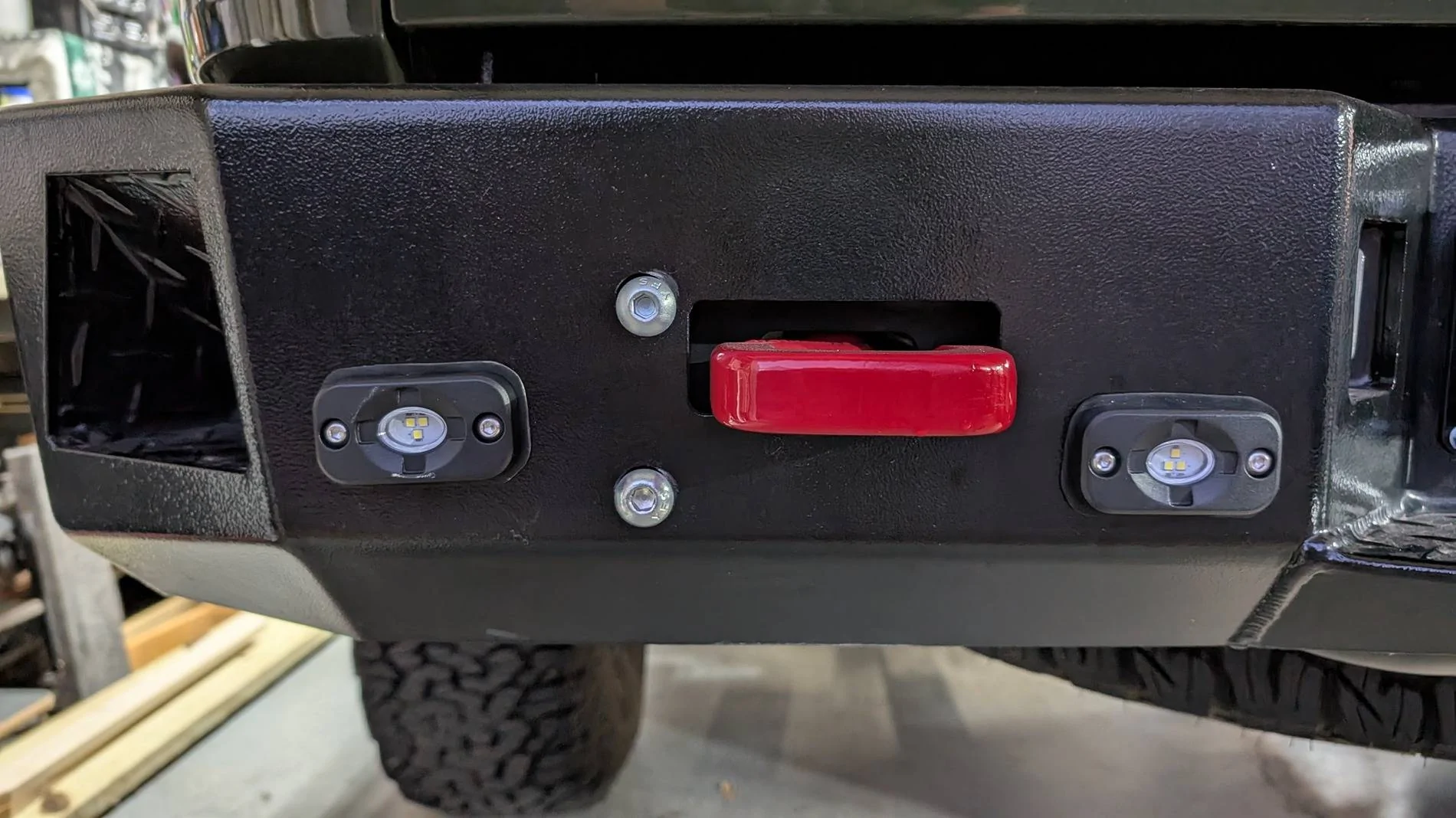

I created a similar wire setup for behind the bumper and ran wires to my cab switches in more split loom to protect them. I think they look good:
Jeep Gladiator Adding flush mount lights to rear bumper PXL_20241230_223311413.MP
Jeep Gladiator Adding flush mount lights to rear bumper PXL_20250101_232855298~2
I promise the lights are mounted level, the picture makes them look a little crooked. They provide a pretty good amount of light:
