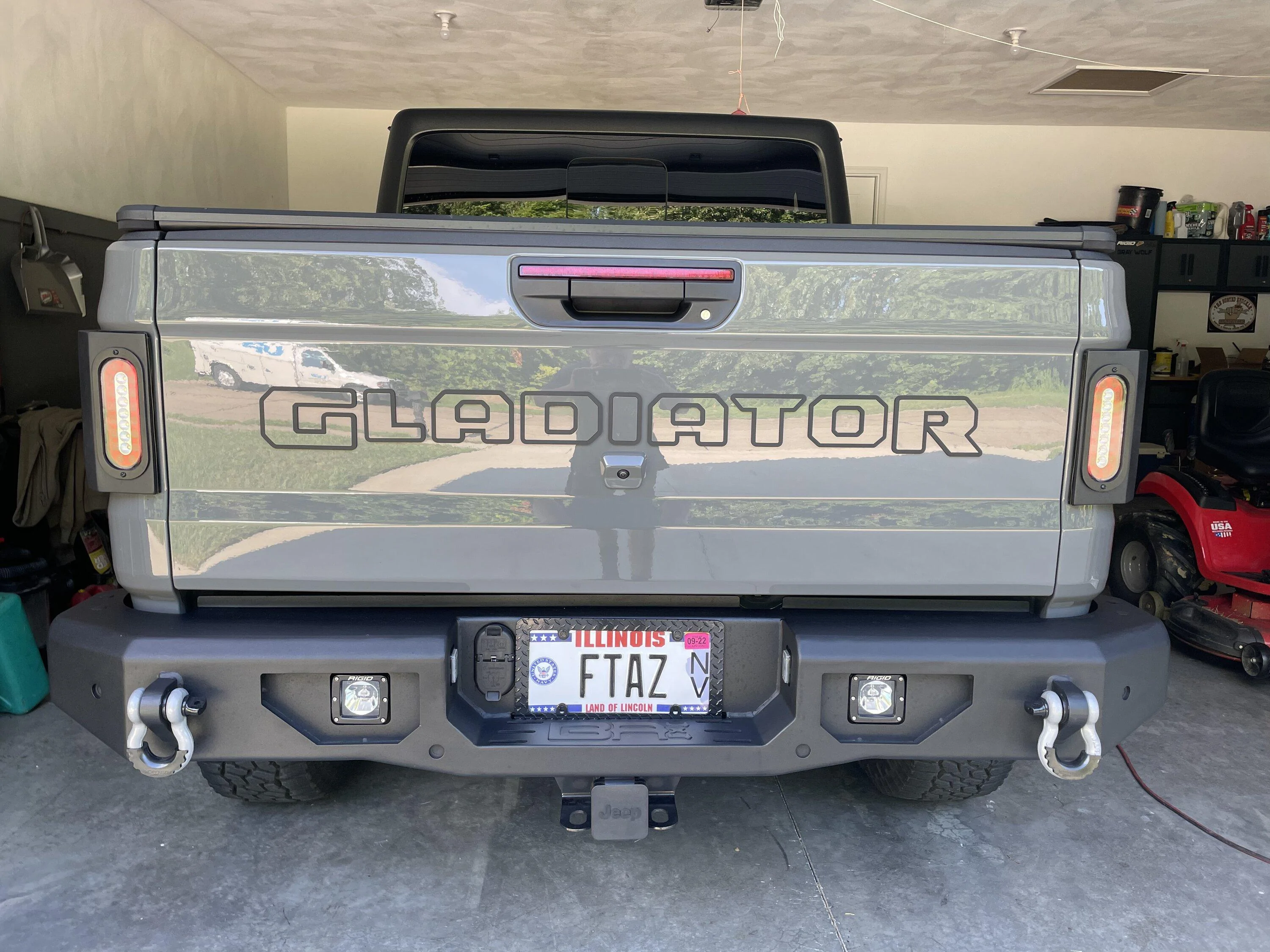

For a good majority of us wanting or at least interested in flush mount taillights for the JT, I'm surprised nobody else has made any. Jeep Steel made some but they aren't DOT approved.

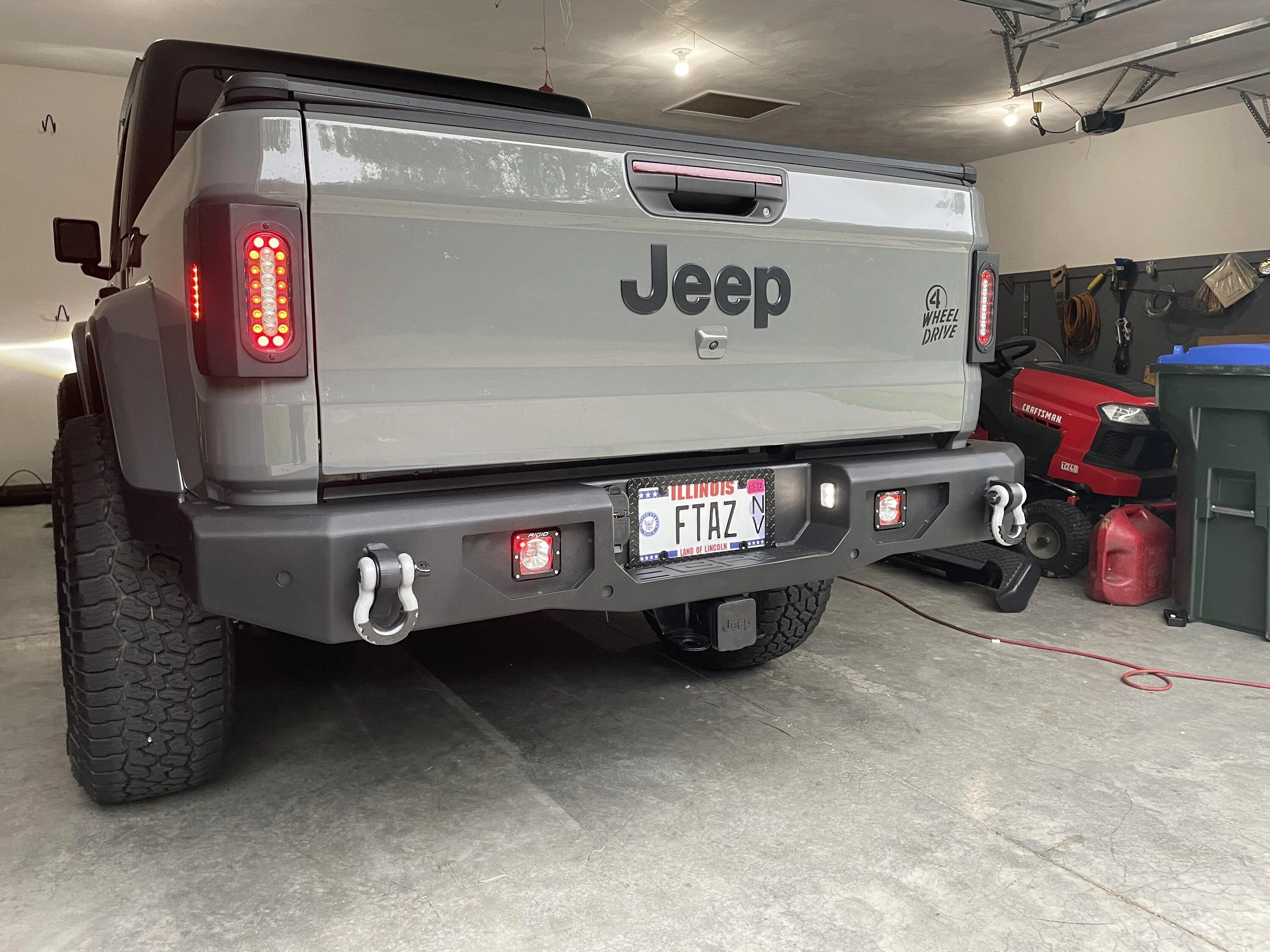

I have the jeepsteel taillights. I didn't know they're not DOT approved. I noticed the side marker light does not blink. I wonder if that's the reason.
I'm pretty sure it's because there's no reflector. Let me do some more dot research. Do you have a few pictures of them?
Klicht87
May 3, 2022
460
380
Connecticut
2022 Jeep Gladiator Willys
Veteran/DoD Program Analyst
I did some digging and all headlights and taillights need to be stamped "DOT APPROVED". Reflectors need to be on the back which the oem bumper has. I see you have an aftermarket bumper without reflectors. I would be careful with your setup. I do like those taillights though. I'm not sure how strict cops are where you are with offroad bumpers and aftermarket lights.

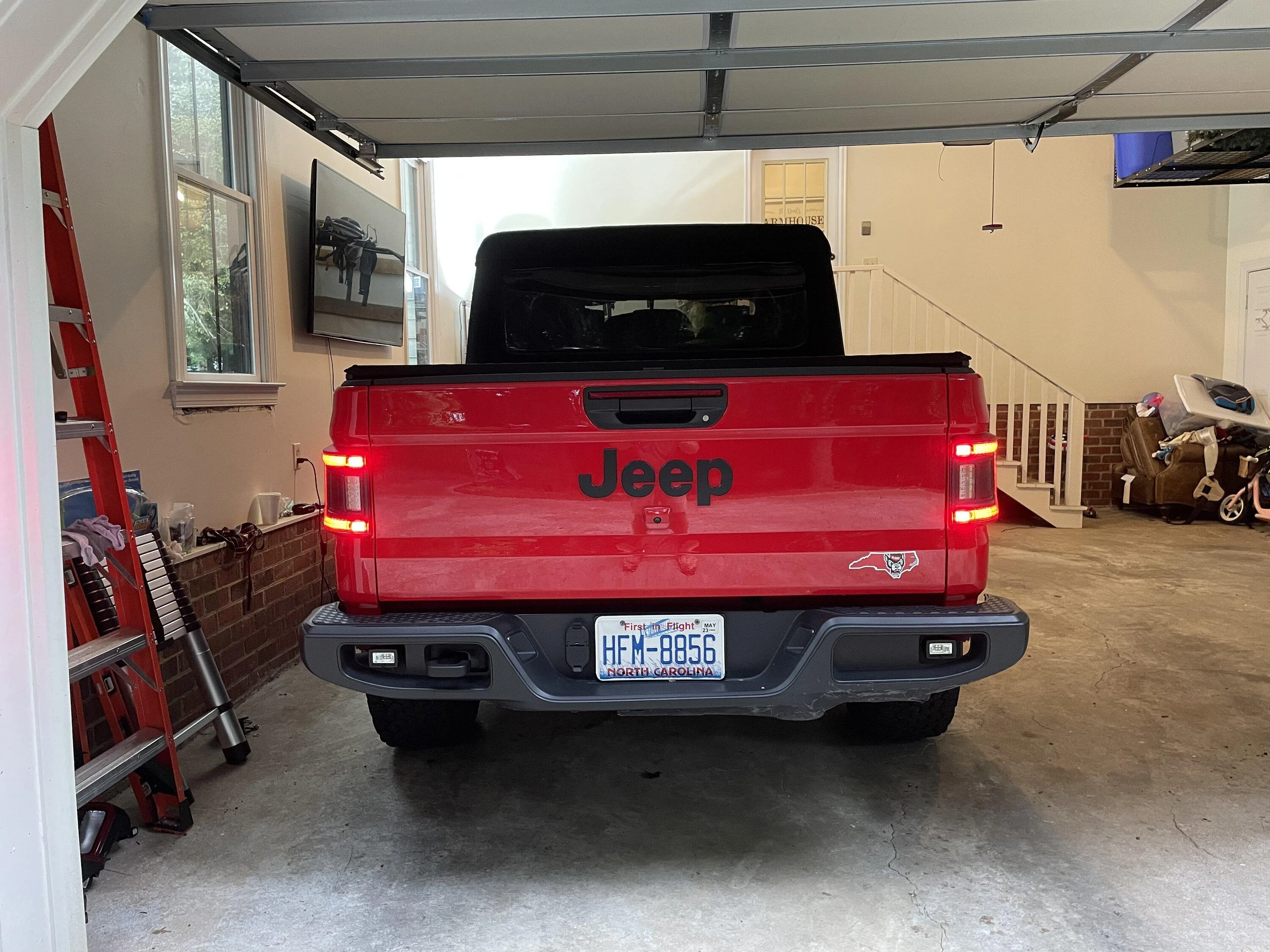

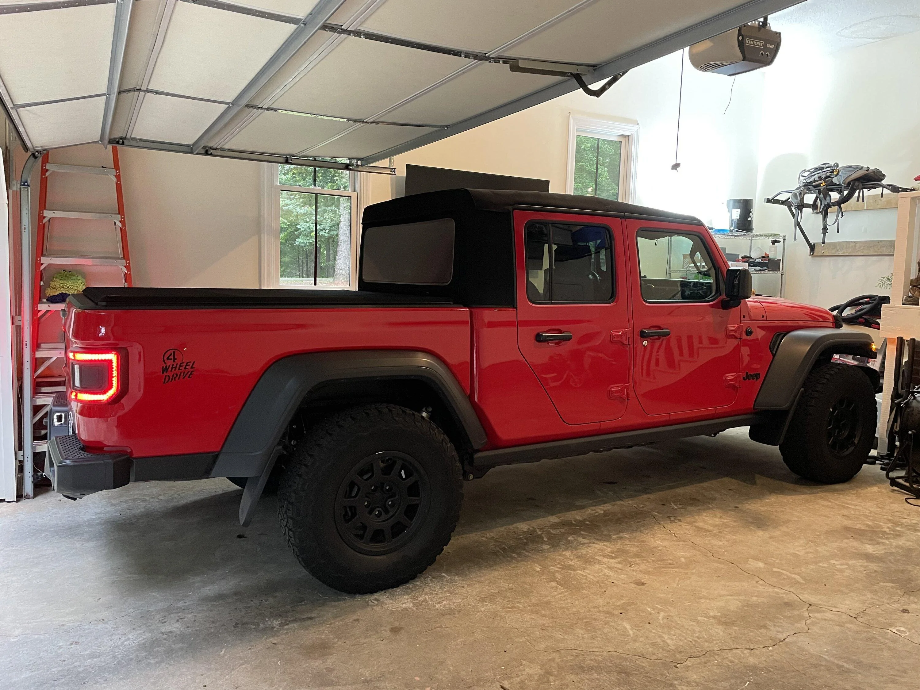

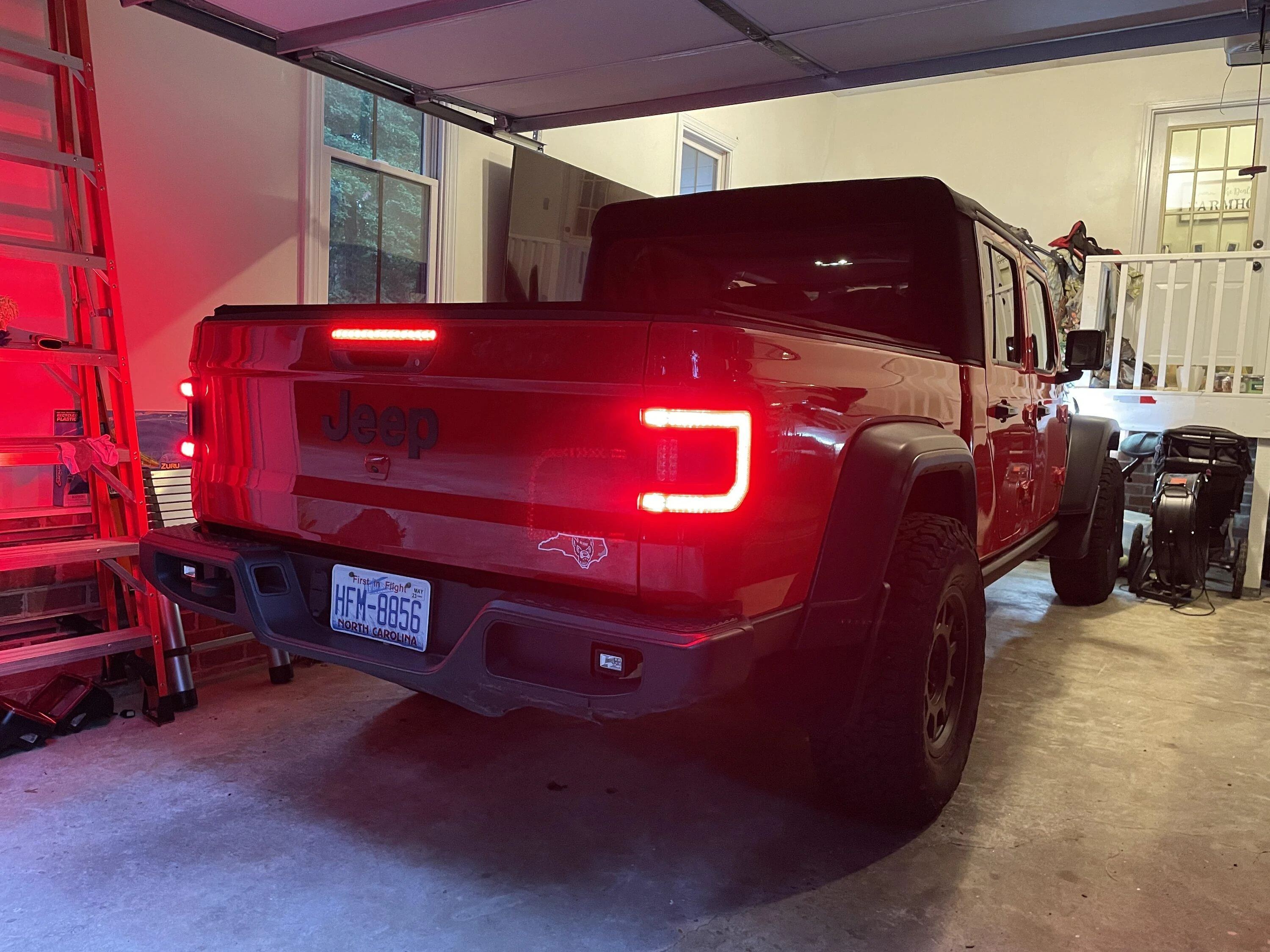

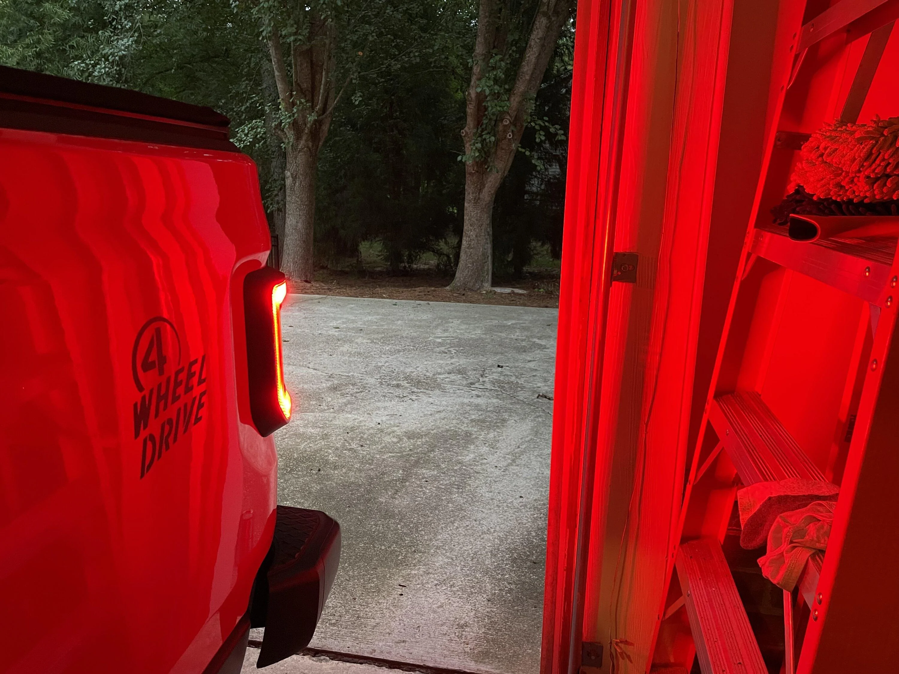

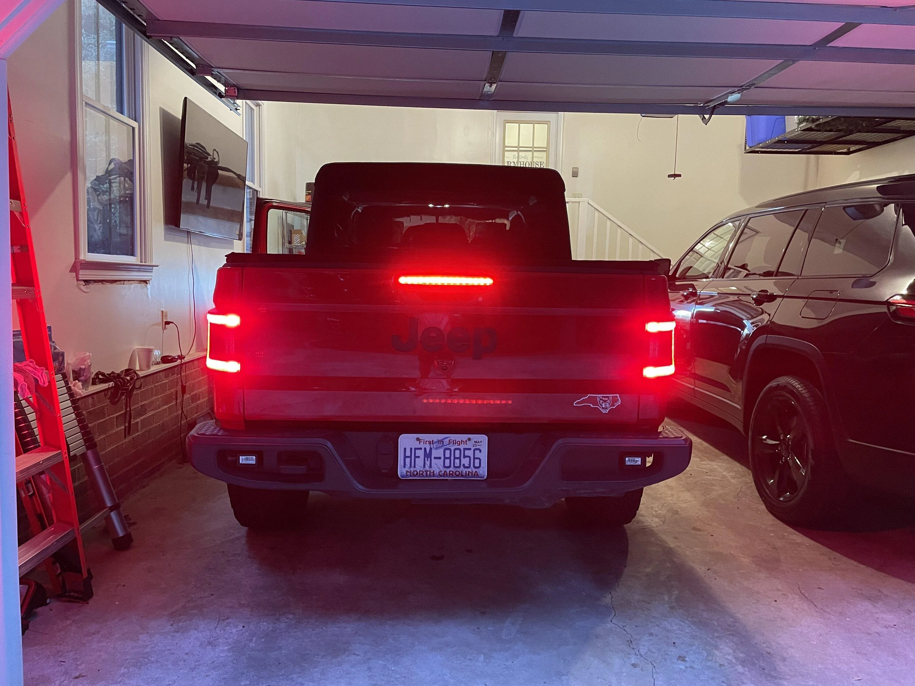

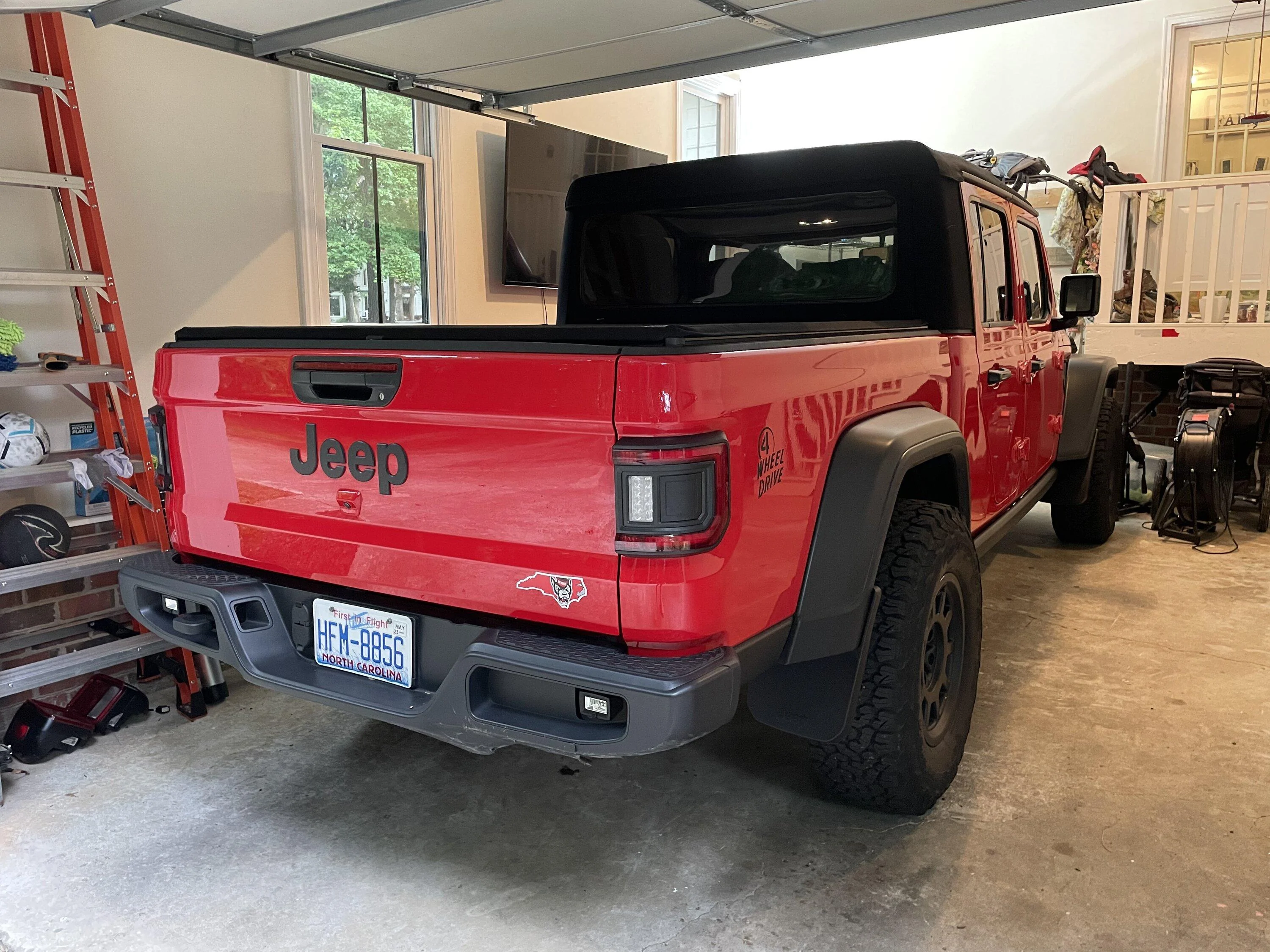

Sport S with halogens here. Knocked off a taillight on the trail, took the plunge, and got my oracles in and installed yesterday.
For the existing rubber grommets that hold the original taillight posts in, i just took a thin screwdriver and poked a hole through them. That was enough to let the oracle posts through and hold them nice and tight.
I used the resistors, and mounted each with one screw. I didn't see any double-sided tape or screws in the box, so that was the only funky thing. Luckily i had a couple that fit in the toolbox.
I'm not sure if these are a revised design or not, but the screws through the side of the bed attach to metal clips in the oracle taillights. I had no problem tightening them, and the fit around the bed lines is really good. I'm not seeing any gap to speak of.
Tested them and everything is working great - no led's out or anything. Granted this is on a halogen truck and i'm simply using the resistors. I haven't tried not using the resistors and switching to taillights "LED" in Jscan.
So far i'm really happy with the look and function and have had no issues at all. Will update if i happen to have any. But these look really modern and are very bright!

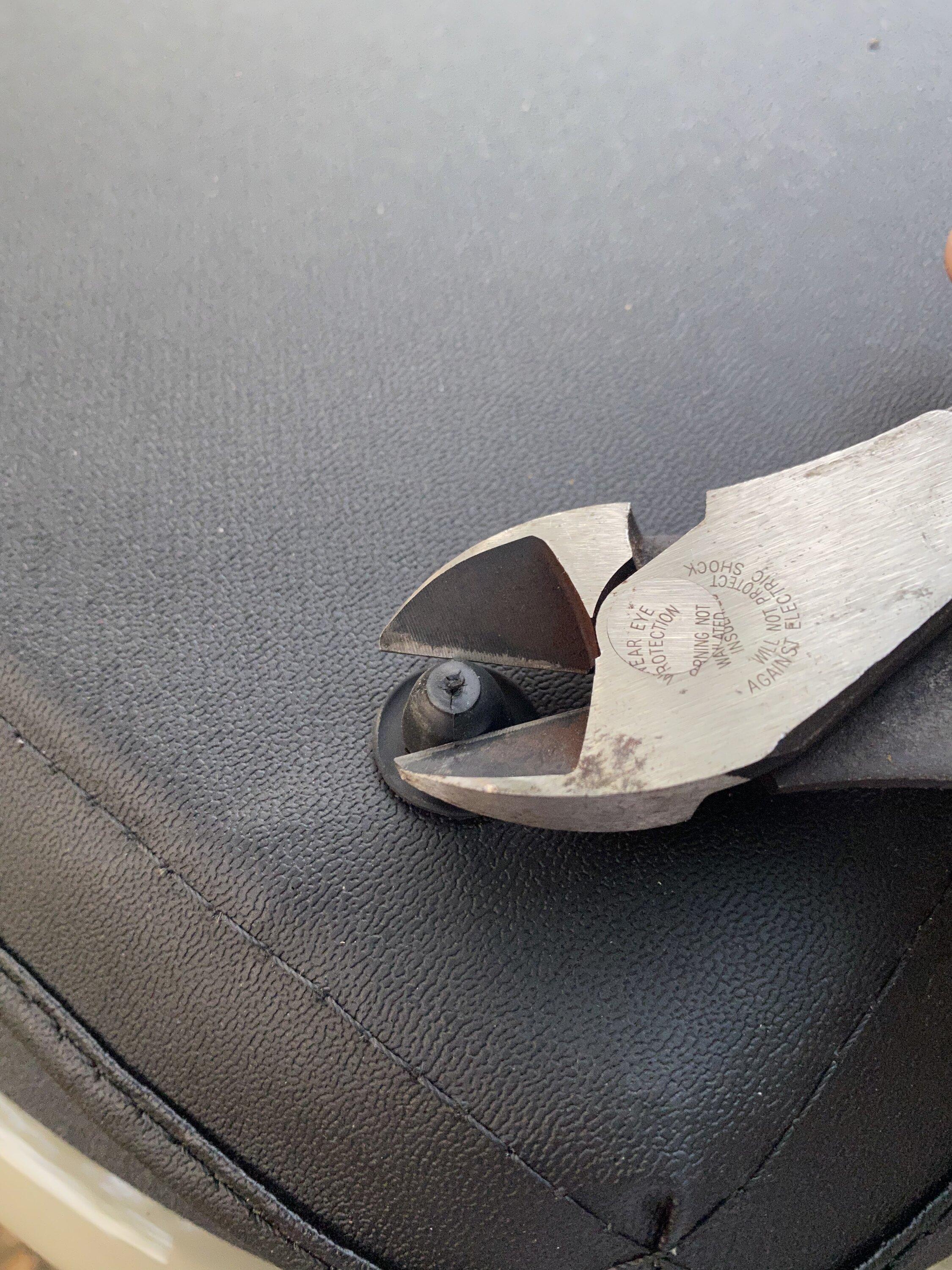

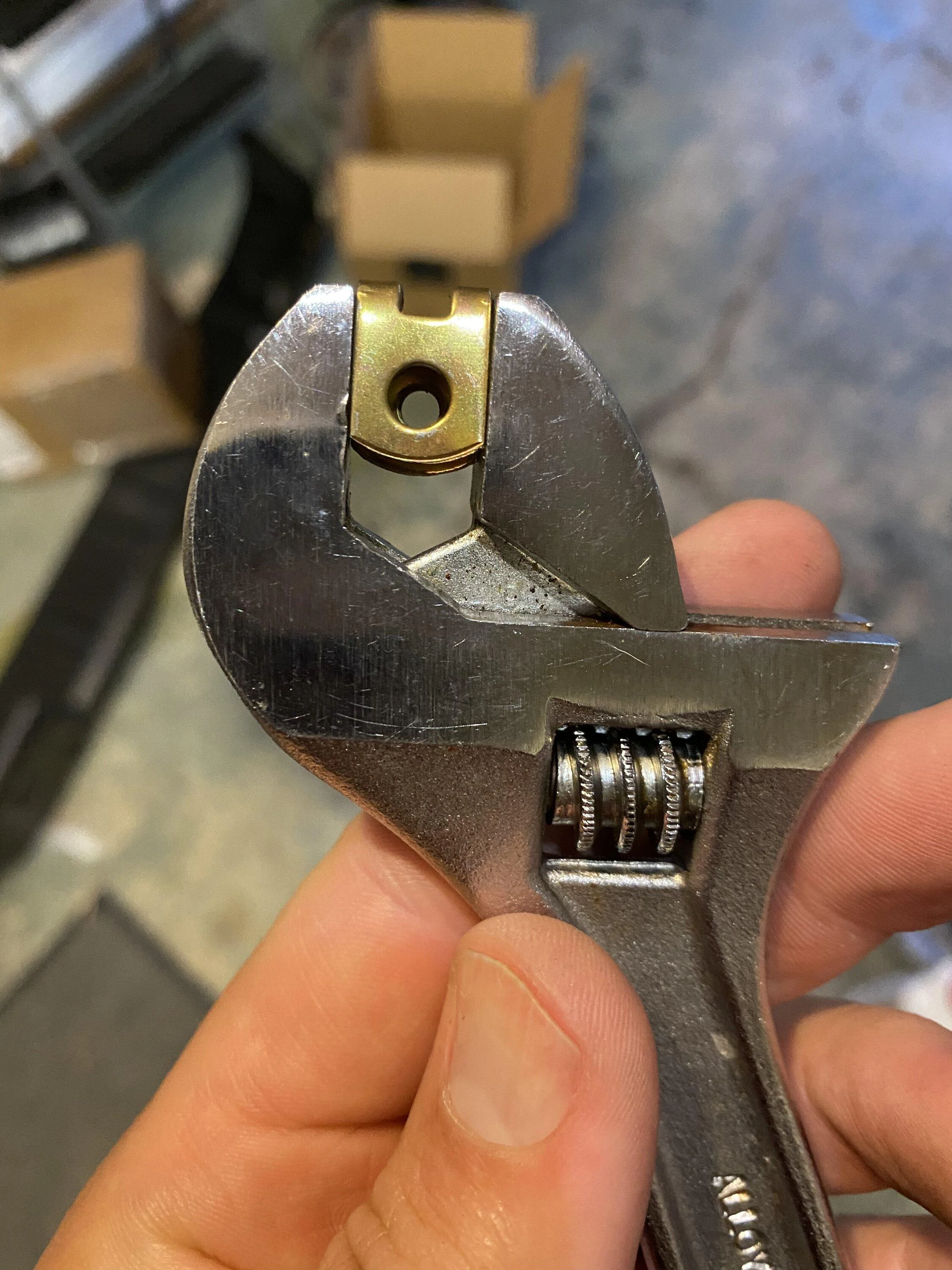

Two things I did to prevent having issues was:
Jeep Gladiator Flush Mount Tail Lights D67D6051-0785-4732-877E-CB164C52F464
Screwed the screws through the ubolts to ream them out without putting stress on the plastic mounting tabs
Jeep Gladiator Flush Mount Tail Lights 8059DBC1-96E3-4339-9BC7-BC2F8C675AF1
cut the end of the rubber tabs off with a set of pliers.

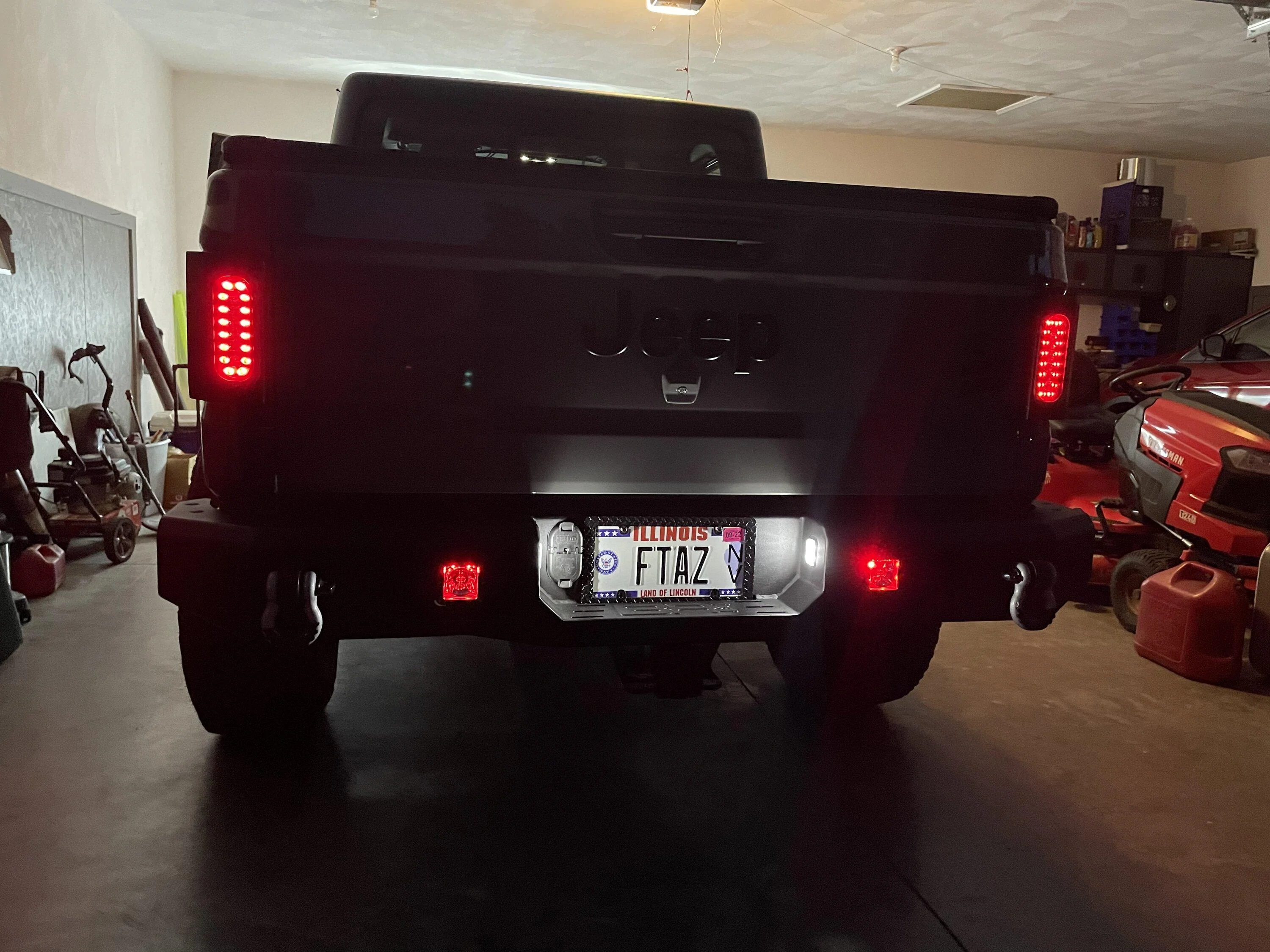

So I was finally able to get the Tazer to recognize the LED's and now my hyper flash is gone and no tail out warning. I went back into my Tazer manual and saw for LED turn signals to cycle from Halogen to LED to Halogen to LED (so 2 cycles) and the reboot. After reboot for sleep cycles it says to operate each turn signal for 20 seconds (20 second left and then right for 20 seconds) then do sleep cycle process (making sure you do not power back on until vehicle has gone dark for over 60 seconds) 5x. I did this and now no error. It was a long process and makes me question the Tazer a bit needing this many resets.sleep cycles but in the end it finally did what it was supposed to do. Hopefully those of you with a Taser will find this helpful.
I didn't do exactly what it said to do. Cycle tail led off and on Sleep mode once, full reboot, sleep mode again and then lunch. No bulb out message after my short break.
The extension harness was plenty long enough and the flush tail lights fit nice. Thanks to this forum, no mount tabs broke, this issue I had was expected and a resolution was presented.

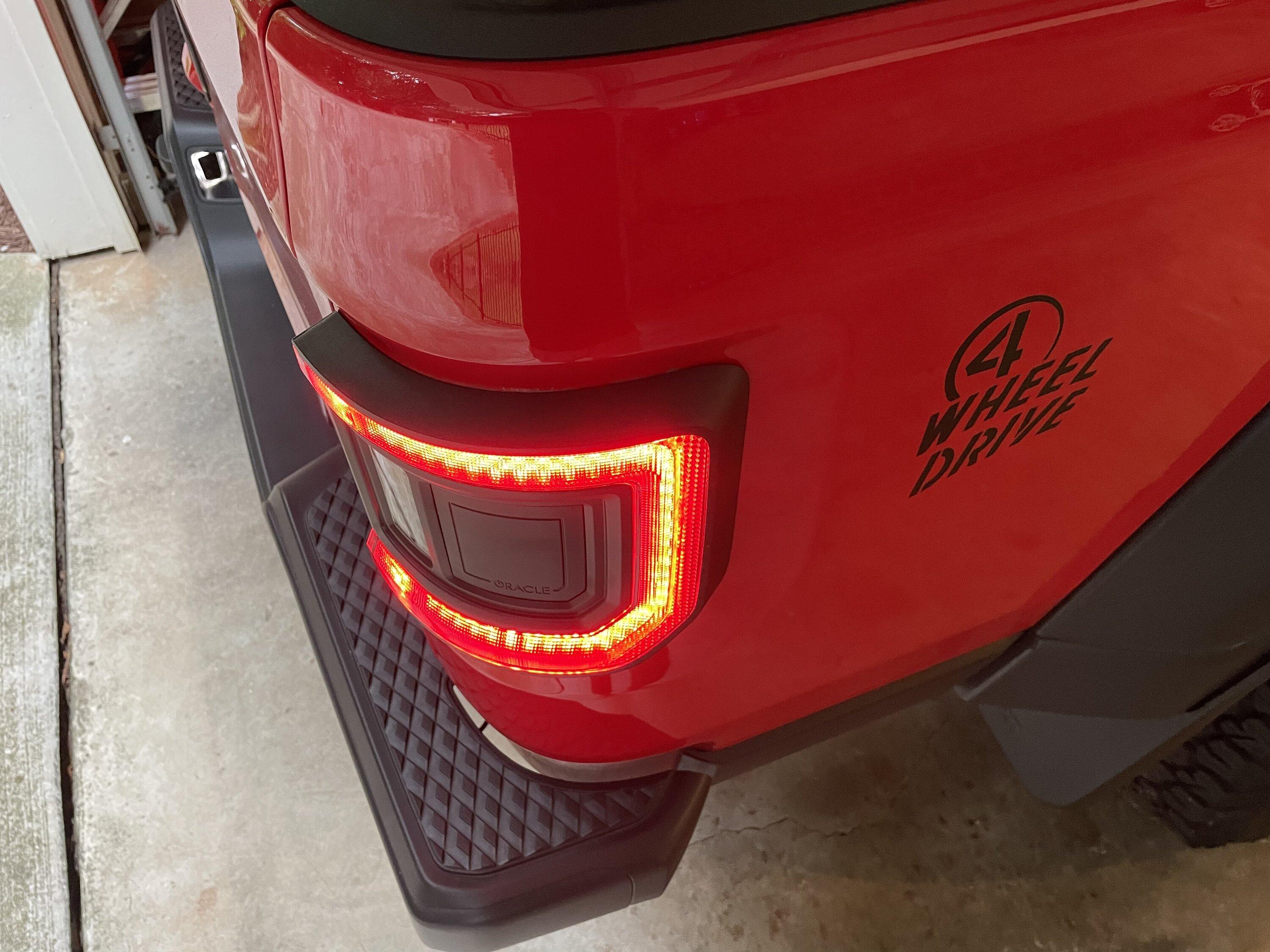

Update: Mine are still fantastic and wish i would have switched them a while ago. One thing i really like is when you use your turn signal, it flashes a bright led red light sideways beside the jeep so you don't get as much of the two vehicles trying to get into one middle lane issue. Nice safety feature. The oem tails just flashed rearward, so it was hard for other drivers to see that you were trying to get into the middle lane.
I had some day-after-install pulsing funkiness with the taillights that i remembered was an issue from replacing my main battery with a different (bigger) battery. My led headlights (previously no flicker) started flickering with the new battery, and it went away when i switched to "led" headlights with JScan, so i figured that the battery was probably not playing nice with the taillight resistors. I unplugged the resistors, went into JScan and changed everything in the rear to "led" and they work perfectly now going on a few days with no pulsing and everything functioning properly. If anyone is having similar issues and have had their main battery replaced, that may or may not be a factor. It was in my case, and it was the battery that was the source of the funkiness. Just needed a JScan adjustment.
But so far so good - the oracles are working great and really enjoying them.
