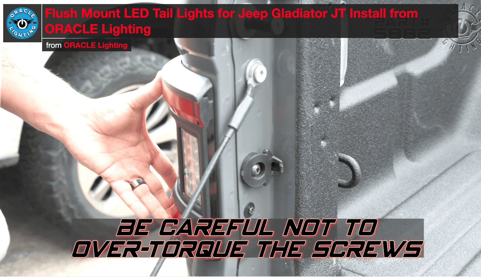

They then show a video of their installation prosses using a damn power tool in the video to do it and then blame those to who this has happened to (and where it may not be everyone it is a fair amount ) on overtightening even with hand tools.
Just to address your concern, the "damn power tool" you are referring to is a Snap On cordless Screwdriver so it has an adjustable clutch system to limit the torque delivered to the screw. A hand tool such as a standard socket wrench would deliver substantially more torque than the "damn power tool in the video" you refer to.
As for not wanting to share the "torque specification" of the screws- it a standard M3 screw which a quick google search shows the standard torque spec is 0.60Nm or 0.44ftlbs (5.28 inch-lbs)
You do know the Snap On cordless screwdrivers can output 200 in-lb of torque, right? So if you only used 2.5% of the tool's capability, how would anyone know what setting you've changed it to if you don't tell them? Your video showed you using a power tool that can deliver 40x the torque you say it should have and then say "you should've known we only used a tiny bit of that".
You guys need to get a handle on your customer service and social media presence. It doesn't even matter who's right or wrong anymore, your responses are a "damn shame".
Totally understand what you are saying, appreciate the honest feedback.
The video installation verbally says at this step "just sinch these up, don't over torque the screws" and displays a large text label stating "BE CAREFUL NOT TO OVER-TORQUE THE SCREWS"
Jeep Gladiator Flush Mount Tail Lights Screen Shot 2022-05-17 at 5.10.57 PM
I am in no way whatsoever trying to argue with you, I am honestly asking what else can we do to make this more clear? Honest question- We are happy to edit the video to help here.
By sharing this, are you saying you've worked with your engineering team to verify this is the recommended torque for these screws for your lights? The material you screw into (the plastic of your light housing that strips out/cracks in this case) might be much less than a general recommended torque value for a given hardware size that one would stumble across in a Google search.
@JP_Oracle, care to confirm? I think this is the value some of us would be interested in knowing.
To answer your question of "what else can we do to make this more clear?", there is a VERY simple answer: provide a torque spec, just like any reputable auto parts manufacturer does, if torque is a concern. If you've ever turned wrenches as a hobby or professionally, you'd know that any part that has a minimum or maximum torque threshold for performance/failure will have that specifically stated. And if there's a particular sequence that the bolts should be torqued in, that's noted too. Answer your question?
