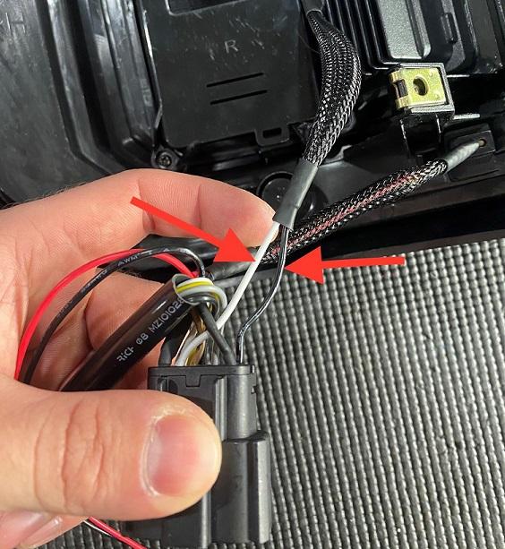

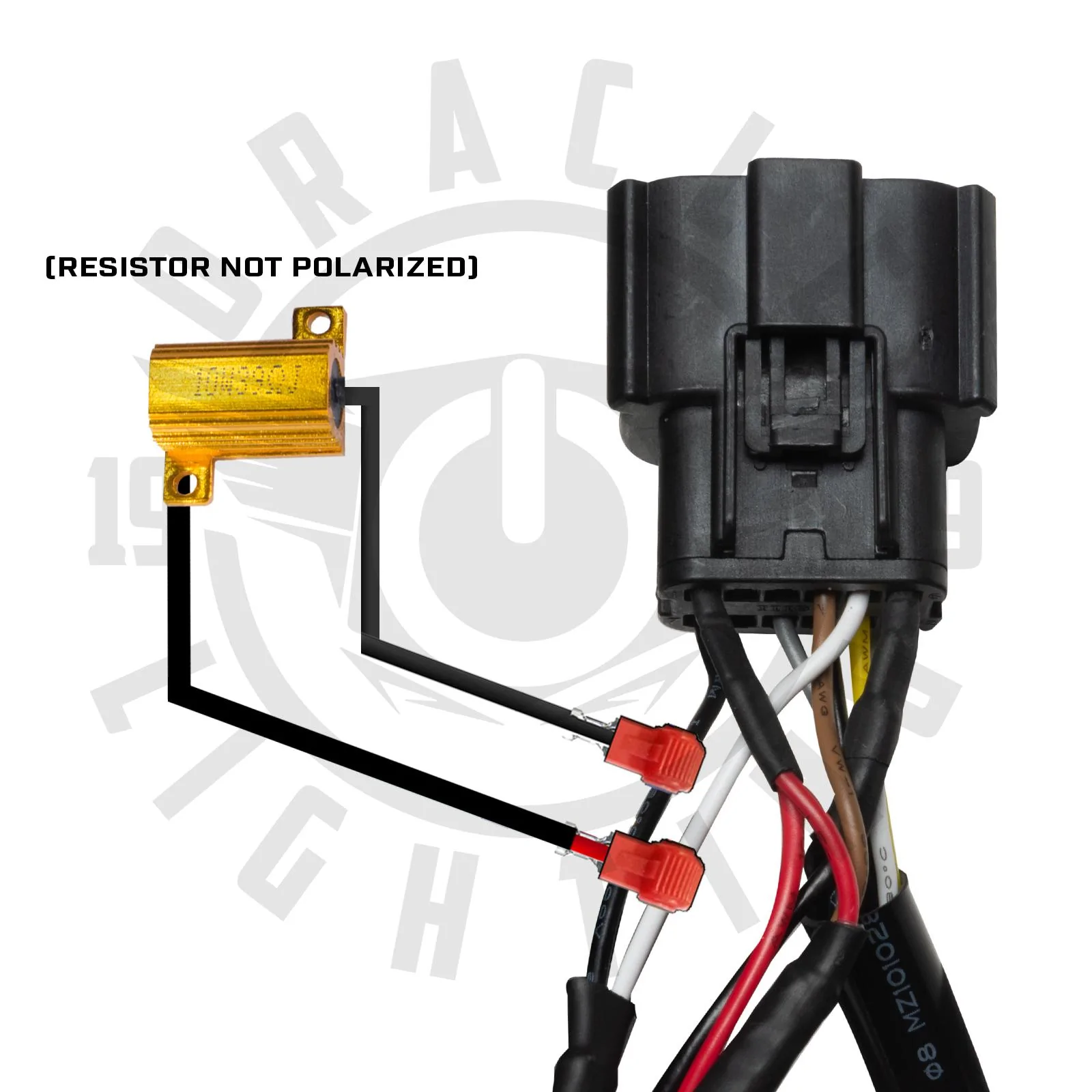

They actually come with instructions to wire them to your brake lights, which is wrong. Here's the correct way to wire them:
Essentially, you just need to tap one end of each resistor to the white wire and the other end to the black wire, on the ORACLE Tail Light harness. These resistors aren't polarized, so it doesn't matter which end goes to which wire. Here's a clearer picture as to where to tap those in on the tails:
