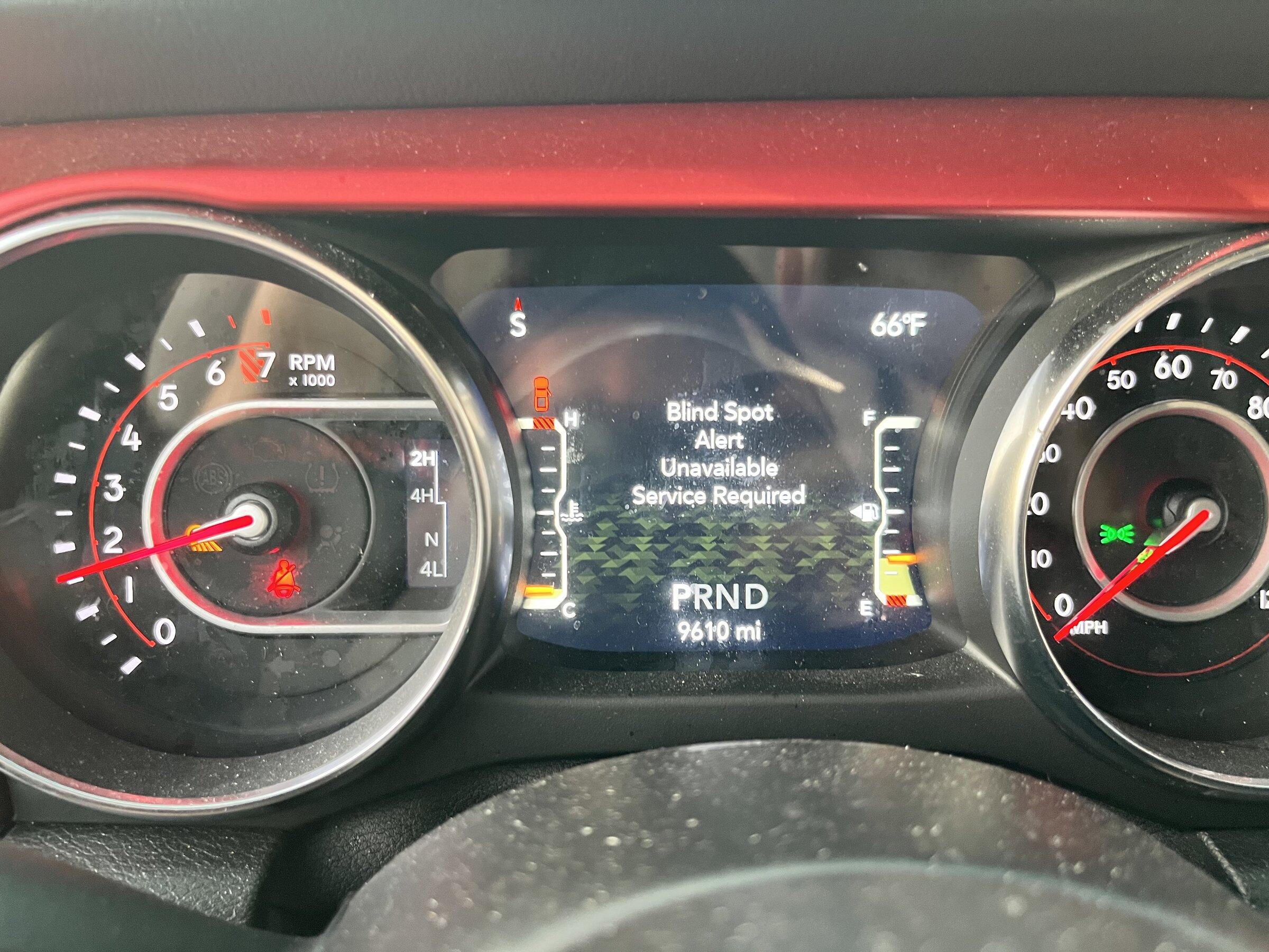

MrFahrenheit
Jan 6, 2020
478
796
Arizona
2020 FC Red Gladiator Rubicon
now this morning this popped up.
Another person had what I think is a similar problem and they found out that the pins in the BSM connector were not making proper contact.
i believe i just got the oracle tail light system up and running. i have been having a problem with the Blind side monitoring system as well as the tail lights not working and after some help from Justin at Oracle and some trouble shooting of wires and pins, i got all of it up and running. the problem that I was having was the pins that were in the connector for the bsm sensors were not engaging the pins in the sensors.
JP_Oracle
Peak Sponsor (Level 2)
JP
Jun 29, 2021
236
217
ORACLE Lighting
21 JTR
Check the seating of the contacts at the sensor connectors. Here's a video on how to unlock the wire release to push them back into place (Super easy):
