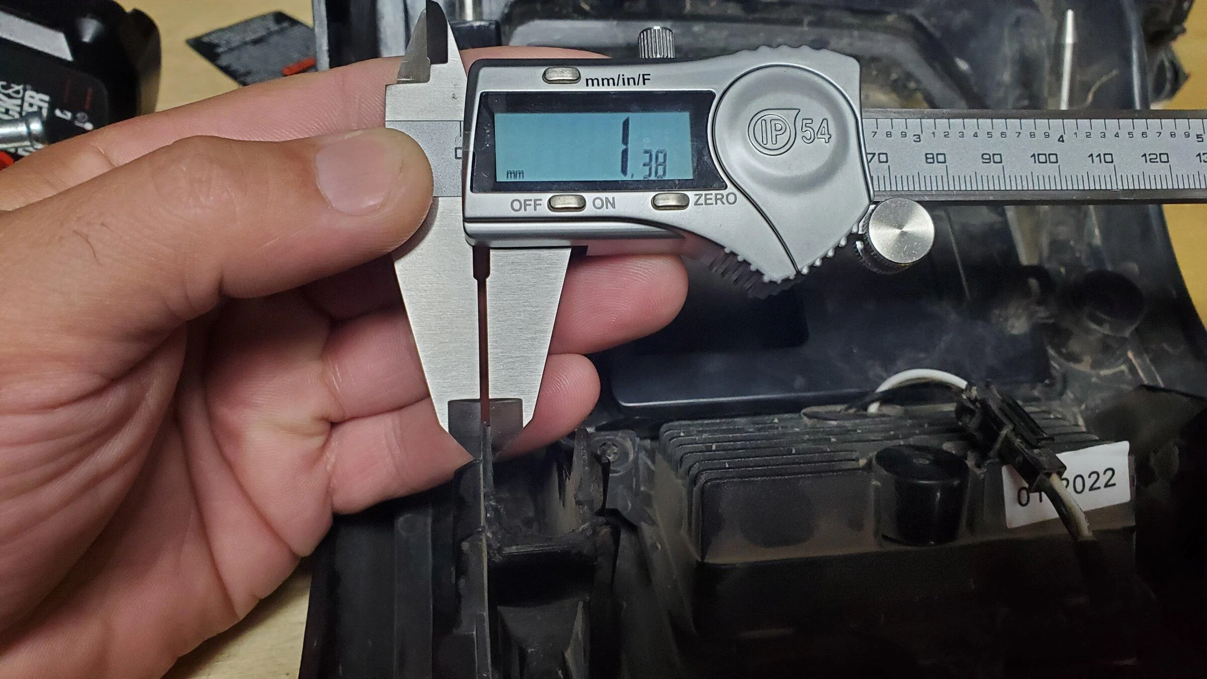

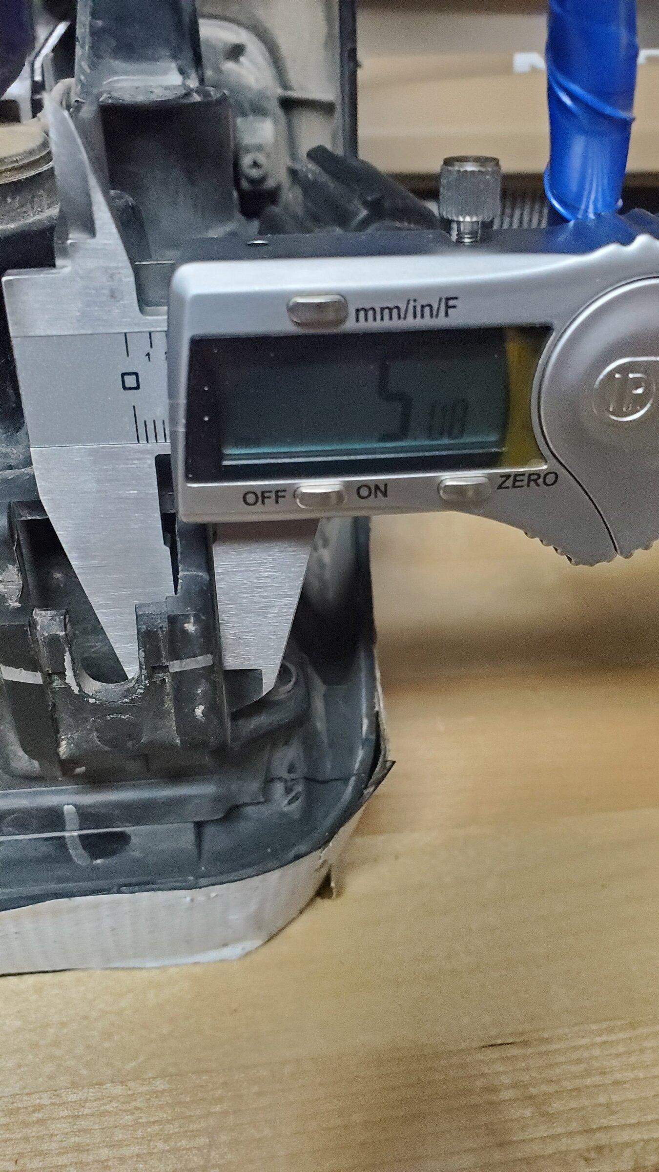

I do agree with you @ORACLElights. This is not a manufacturing defect. Rather it’s either a design flaw OR a brilliantly engineered way to ensure recurring revenue stream by charging your customers for replacement of these lights years into the future.
This is completely contradictory to Magnuson-Moss Warranty Act stating: “such warrantor must as a minimum remedy such consumer product within a reasonable time and without charge, in the case of a defect, malfunction, or failure to conform with such written warranty;”
Since you are unable to provide torquing specs or a scientific explanation behind this problem, I’ve decided to take a stab at it. The walls of the posts are only 1.3 mm think and are not reinforced or connected to anything on the sides. That’s right, 1.3 mm of thin plastic is all that’s holding the 5+ pound lights to the body of the Jeep through high speeds and vibrations of offroad. On top of that, the lights are not flush with the body leaving a huge gap for the wind to get inside and rattle the entire assembly. Over torquing, under torquing or just right torquing has nothing to do with it! In comparison, walls on OEM lights are over 5 mm thick and connected to the rest of the lights assembly on all sides for a nearly indestructible hold.
Good luck to those that have purchased these lights. It’s not a matter of IF but WHEN you will encounter the same issue.
Wow, should have started with these pics. No wonder they are suggesting to epoxy a nut on there, will probably be stronger afterwards. Might as well epoxy on some metal support brackets as well while you’re at it. Maybe it’s part and parcel to the slim fit, but long term durability seems questionable with only 1.3mm of plastic to contend with vibration and heating/cooling related expansion/contraction. No thanks, JTs come with enough gremlins from the factory, no need to add more with sketchy aftermarket parts no matter how cool they look.
