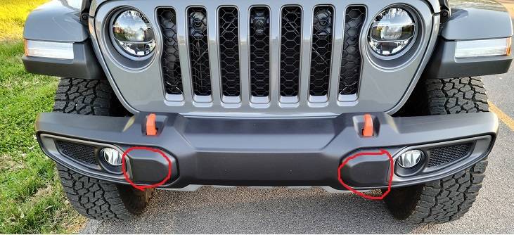

Has anybody tried installing the flush mount 3 inch cube lights or other lights of that type in the part of the bumper where the parking sensors would live in? My jeep does not have that option, and it seems like there is a decent sized cavity that would fit lights with a little room to spare. The flat spot in front of that cavity measures 3.5"x4.5", so it seems like it would fit without issue.
I may try it this spring, but I was wondering if anybody else had already had success doing this?

Interesting idea. On the stock bumper, there are crash cans behind that bump out.

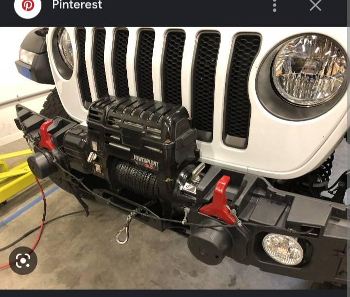

Jeep Gladiator Flush mount cube lights in bumper? Screenshot_20230128-185514_Chrome
That being said, the knock off steel bumpers don't have the cans in that spot. And the plastic caps are easily removable. I might try this idea. Haha. Thanks
