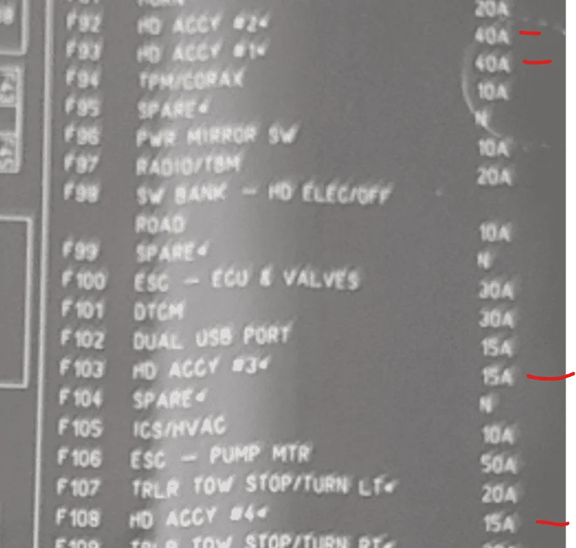

Aux 1 and 2 are fused at 40 amps
3 and 4 are 15 amps - plenty to handle most LED lighting.
Jeep Gladiator Adding lights to AUX switches. aux-switch-fus
