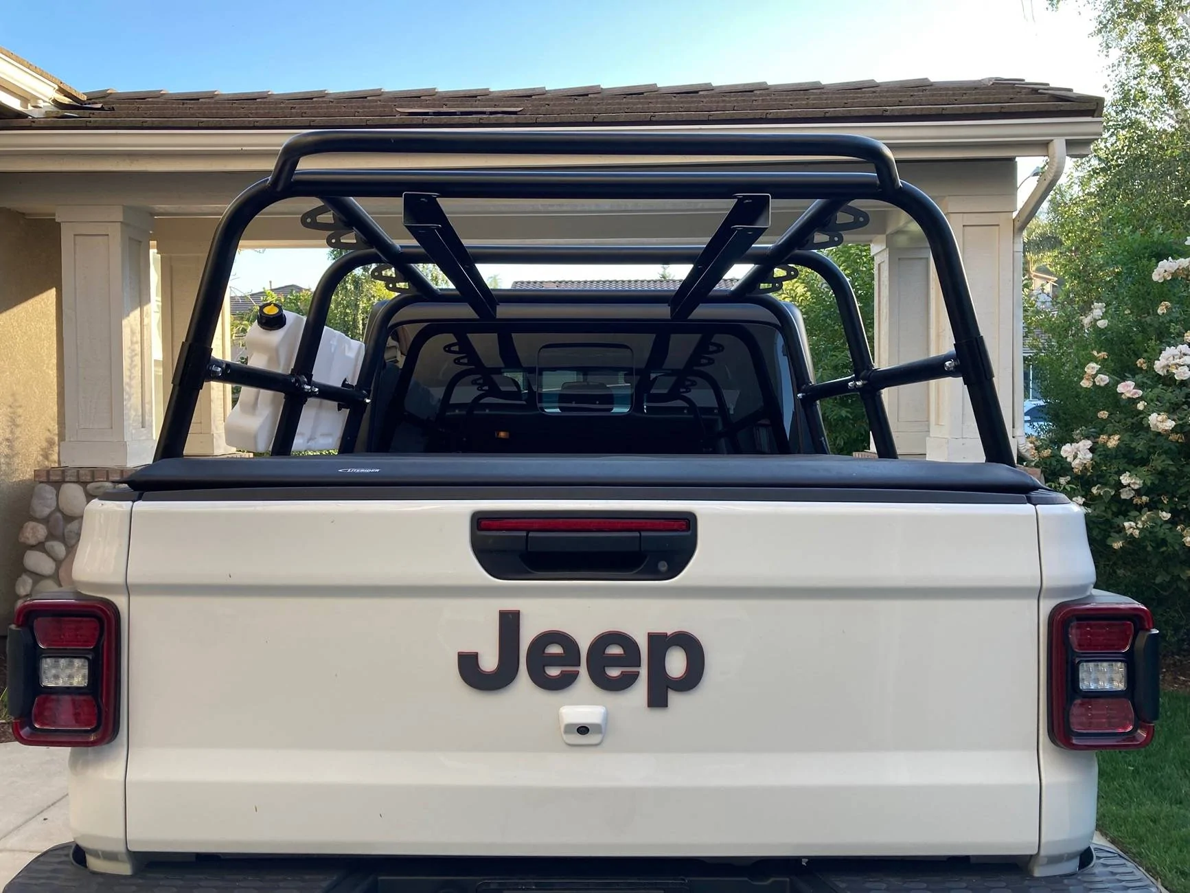

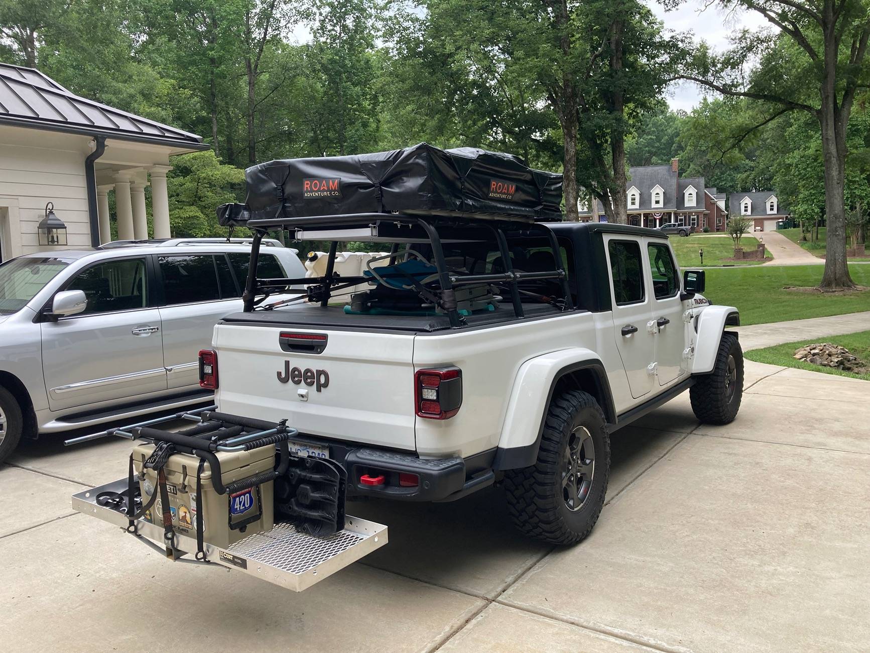

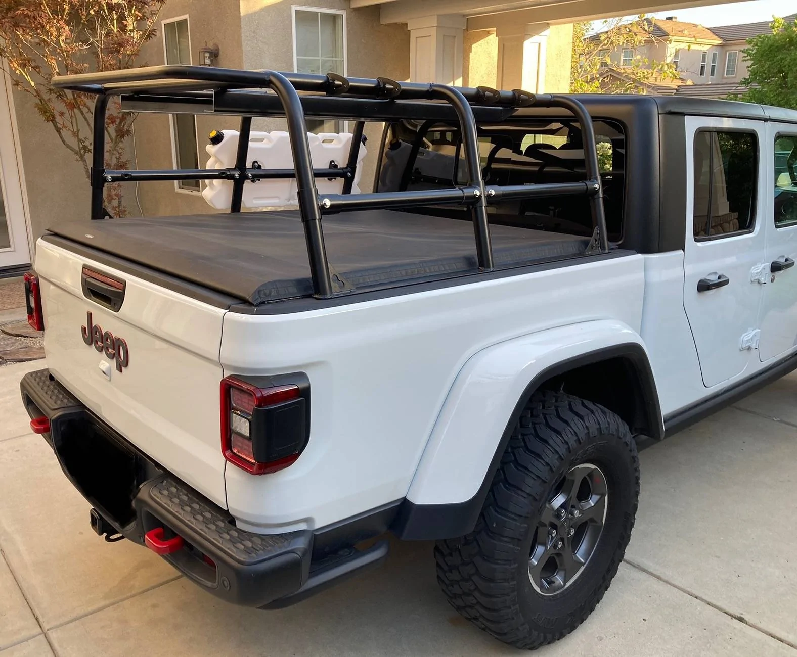

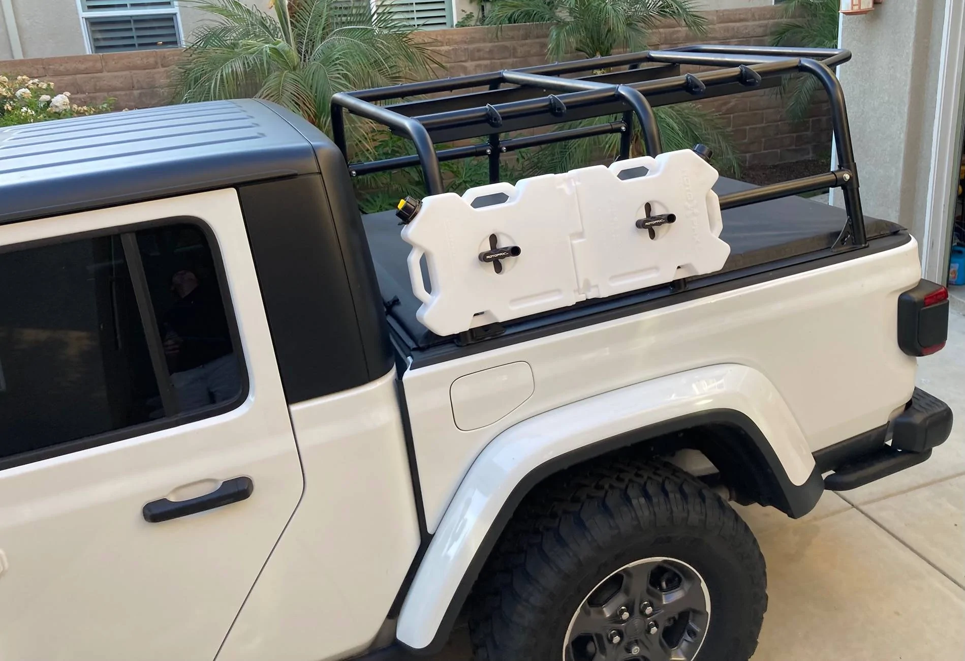

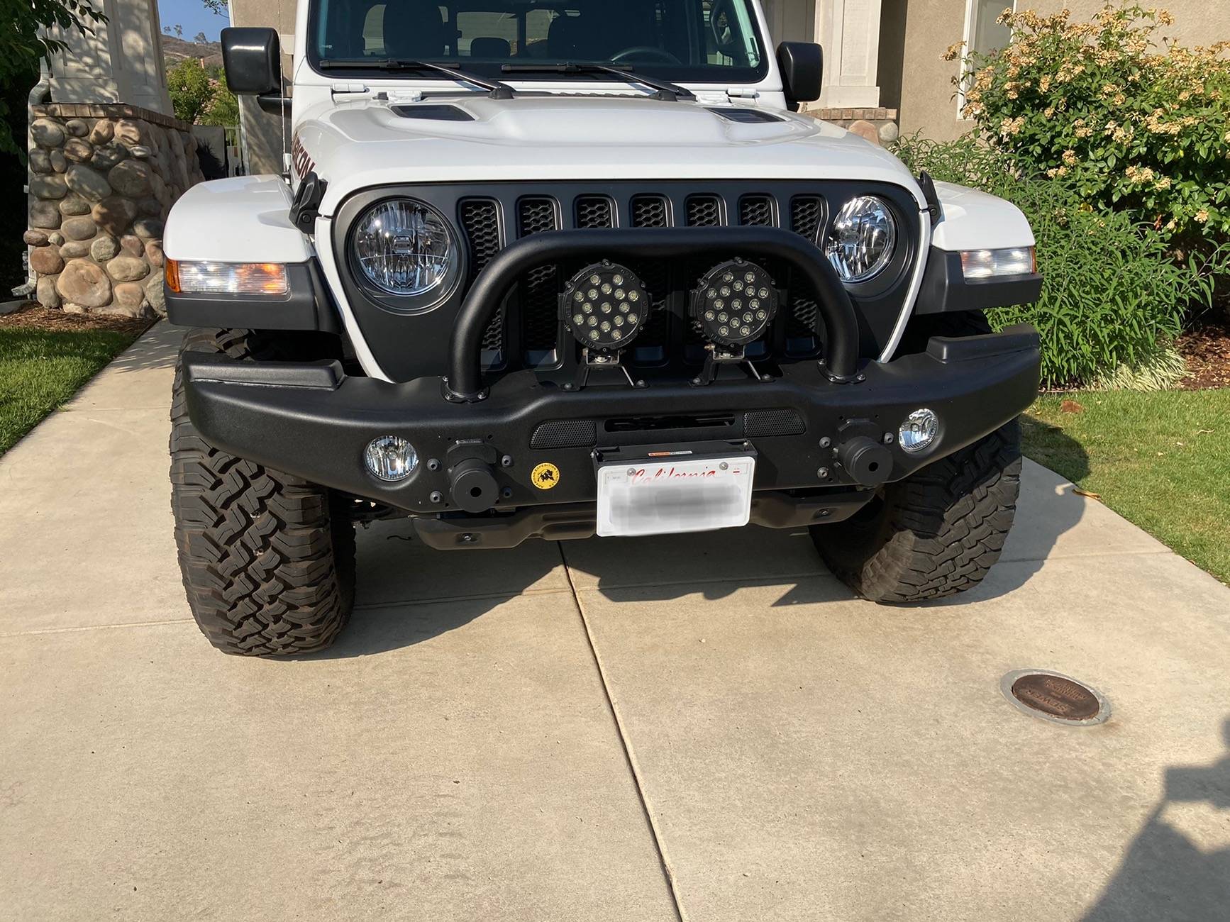

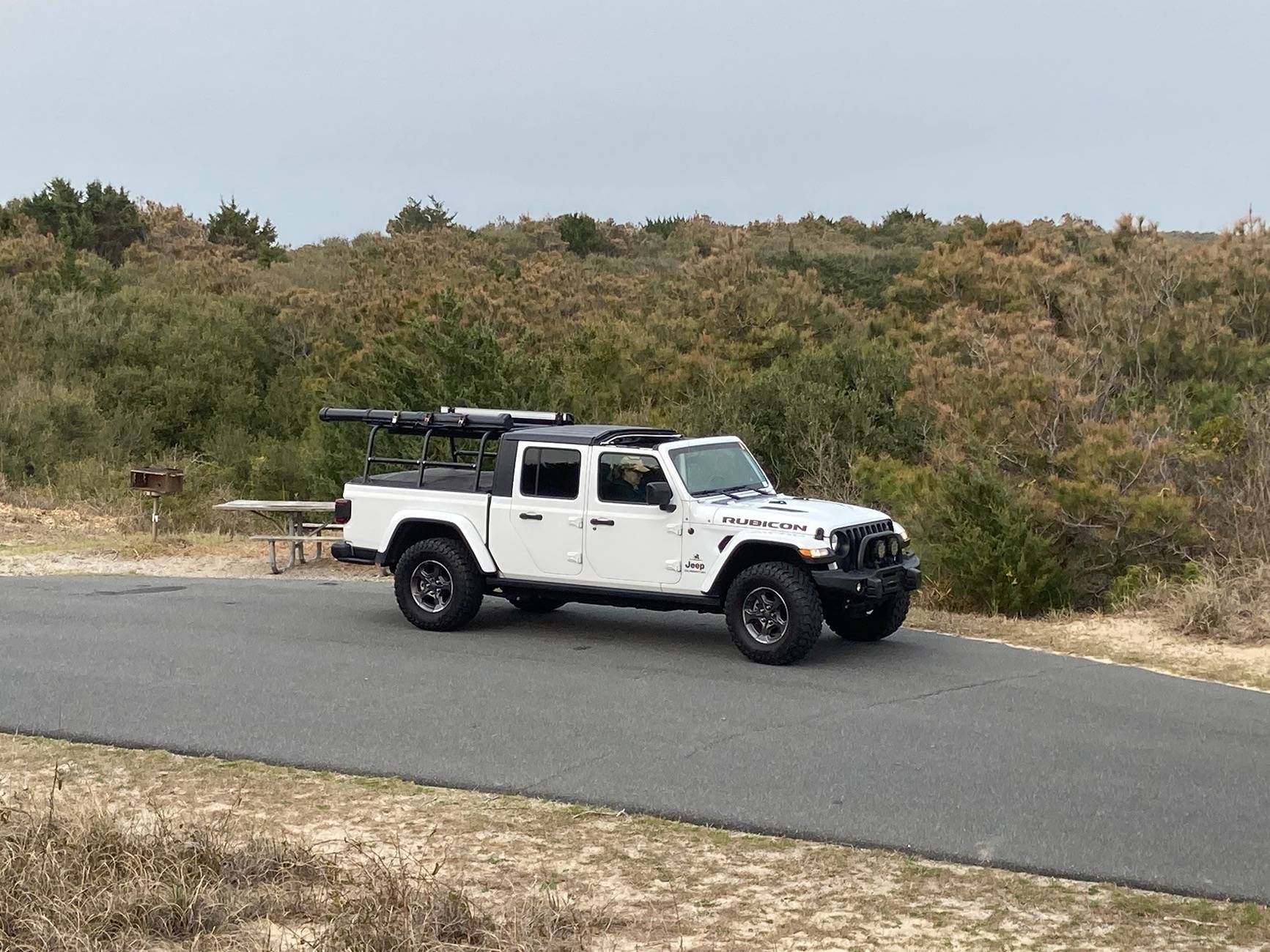

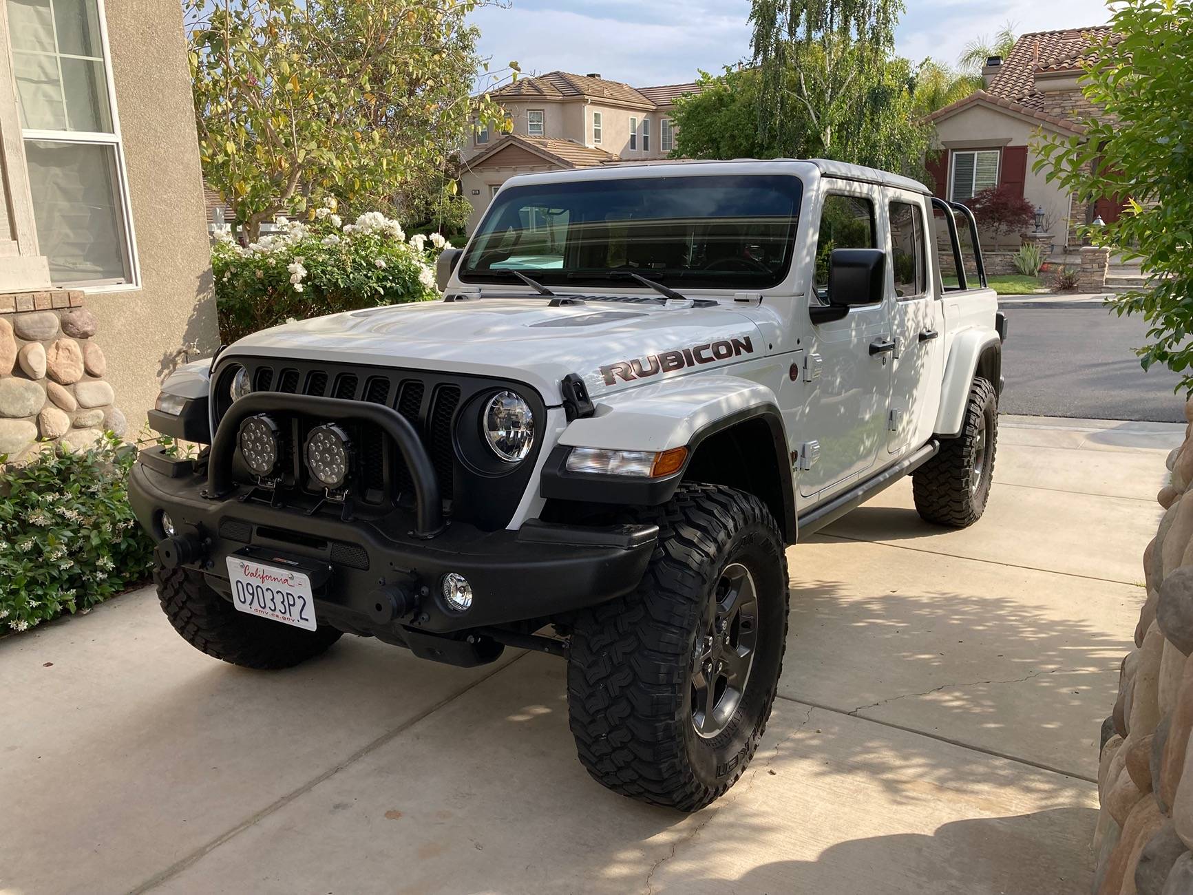

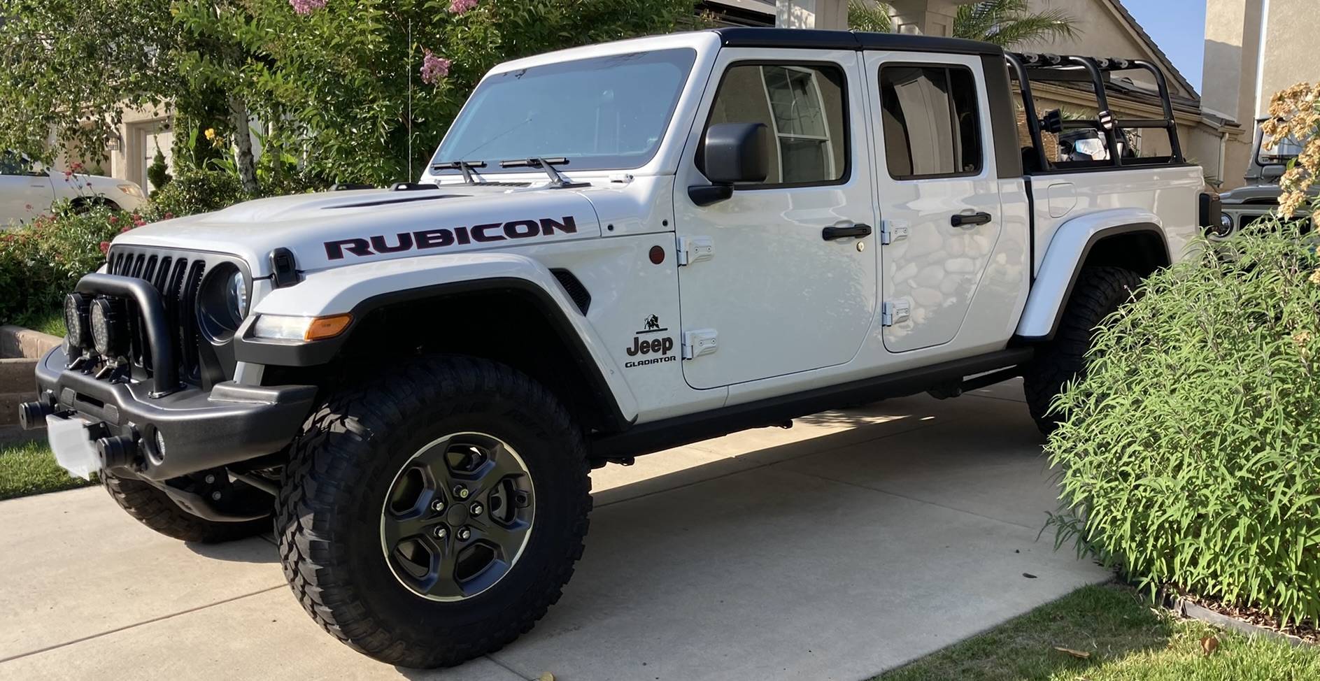

Pictures of the bumper, bedrack, and bedcover in use and in their natural habitat.

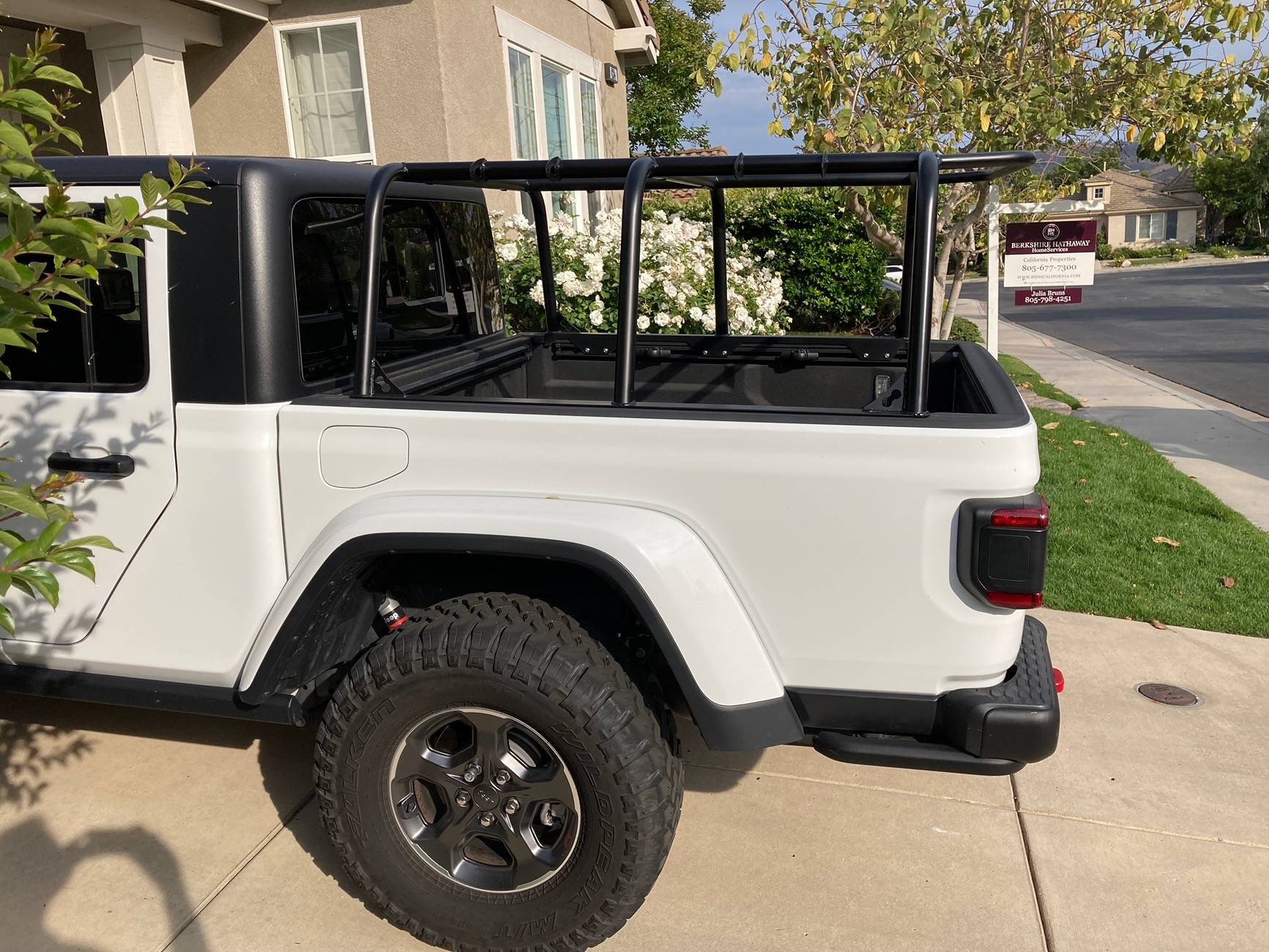

The bed rack lives on my Gladiator 24/7 and was designed (by me) such that it doesn’t hinder rear visibility in daily use. It also was made such that it could have items secured to it via ratchet straps (i.e., surf fishing pole tube, kayaks) either around the tubes or in the gussets added to each corner of the base of the rack.
It is easy to unbolt and remove from the Gladiator in <10 minutes but ONLY if you have the security key ratchet attachment.
The reason I designed and built this bedrack is absolutely no Jeep aftermarket parts supplier makes a bed rack this stout. None.
Jeep Gladiator AEV bumper, custom bedrack, & bed cover IMG_9173
Jeep Gladiator AEV bumper, custom bedrack, & bed cover IMG_0609
Jeep Gladiator AEV bumper, custom bedrack, & bed cover IMG_9127
Jeep Gladiator AEV bumper, custom bedrack, & bed cover IMG_9220

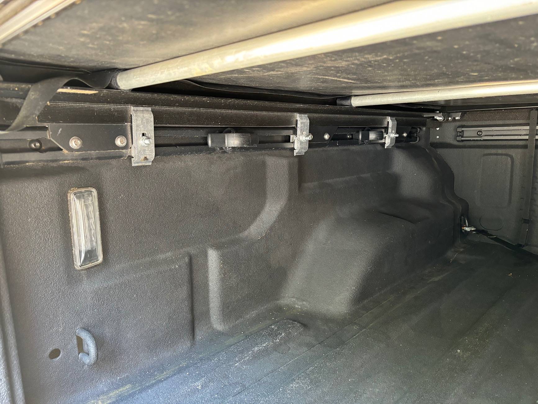

The bed cover works with the bedrack.
While the cover is a vinyl rollup type, you can stack light weight items on top of it. The cover is 99% water tight and lives on the Gladiator 24/7.
Unlike the metal accordion style bed covers, that retract down into the bed area, this cover rolls up on top of the bed rails. Fully rolled up you have access to ~90% of the depth of the Gladiator bed at the top of the bed rails…and 100% below the bed rails.

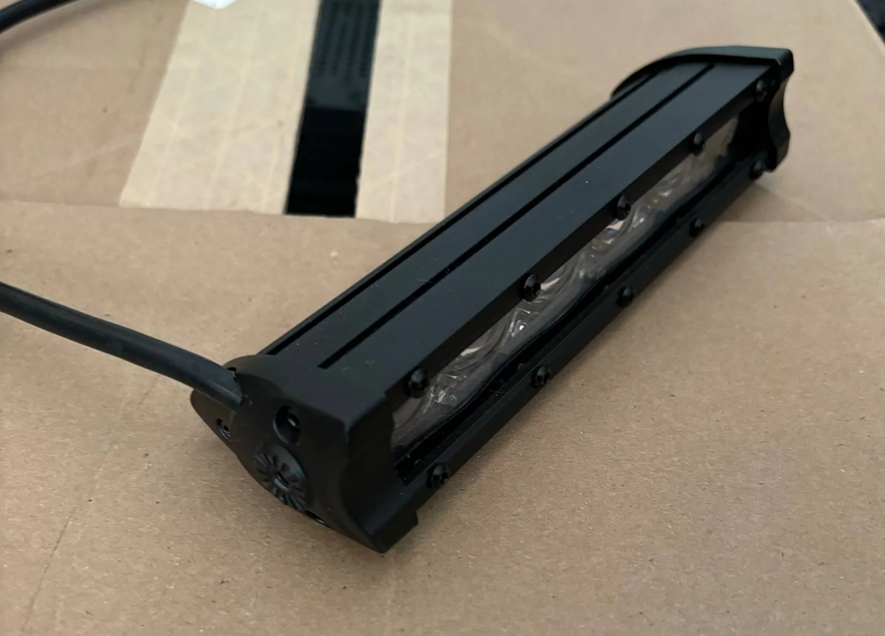

Very nice setup and great deal on the AEV.
What lights did you use for the rotating ones on the rack?

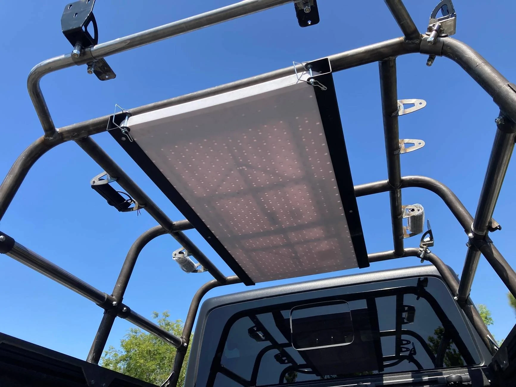

@BourbonRunner I’d have to look back at my receipts but it was something basic off Amazon so that replacement would be easy and quick if needed.
Jeep Gladiator AEV bumper, custom bedrack, & bed cover IMG_1529
Moto-Built light tab brackets were welded to the rack. That’s the key to getting them to rotate >180* into the bed area or out directly from the sides of the truck (similar to ambulance scene lighting) which is great for nighttime camp setup.
Moto-Built light tabs
