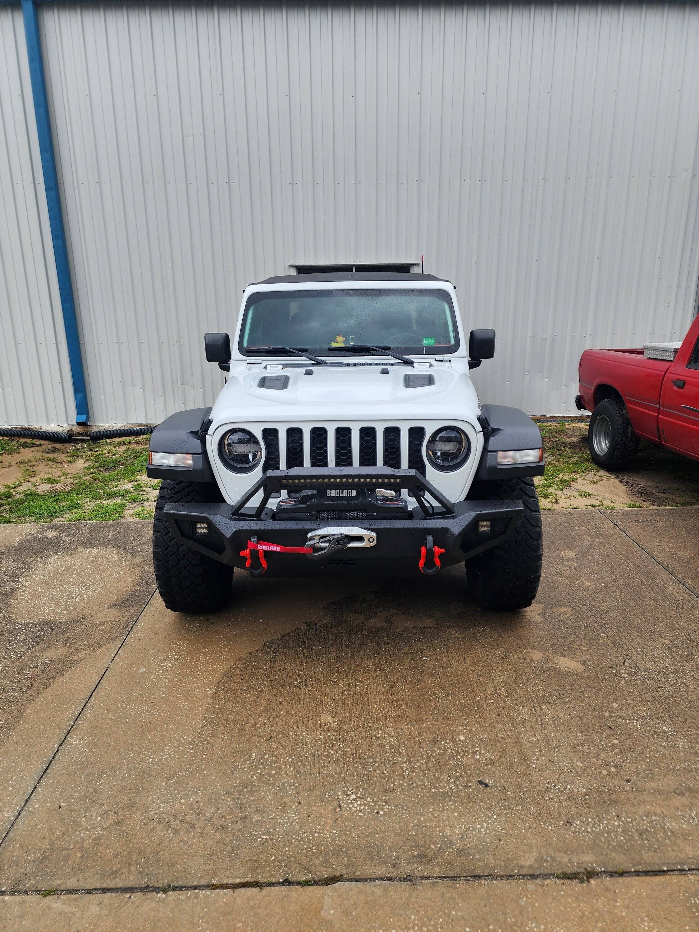

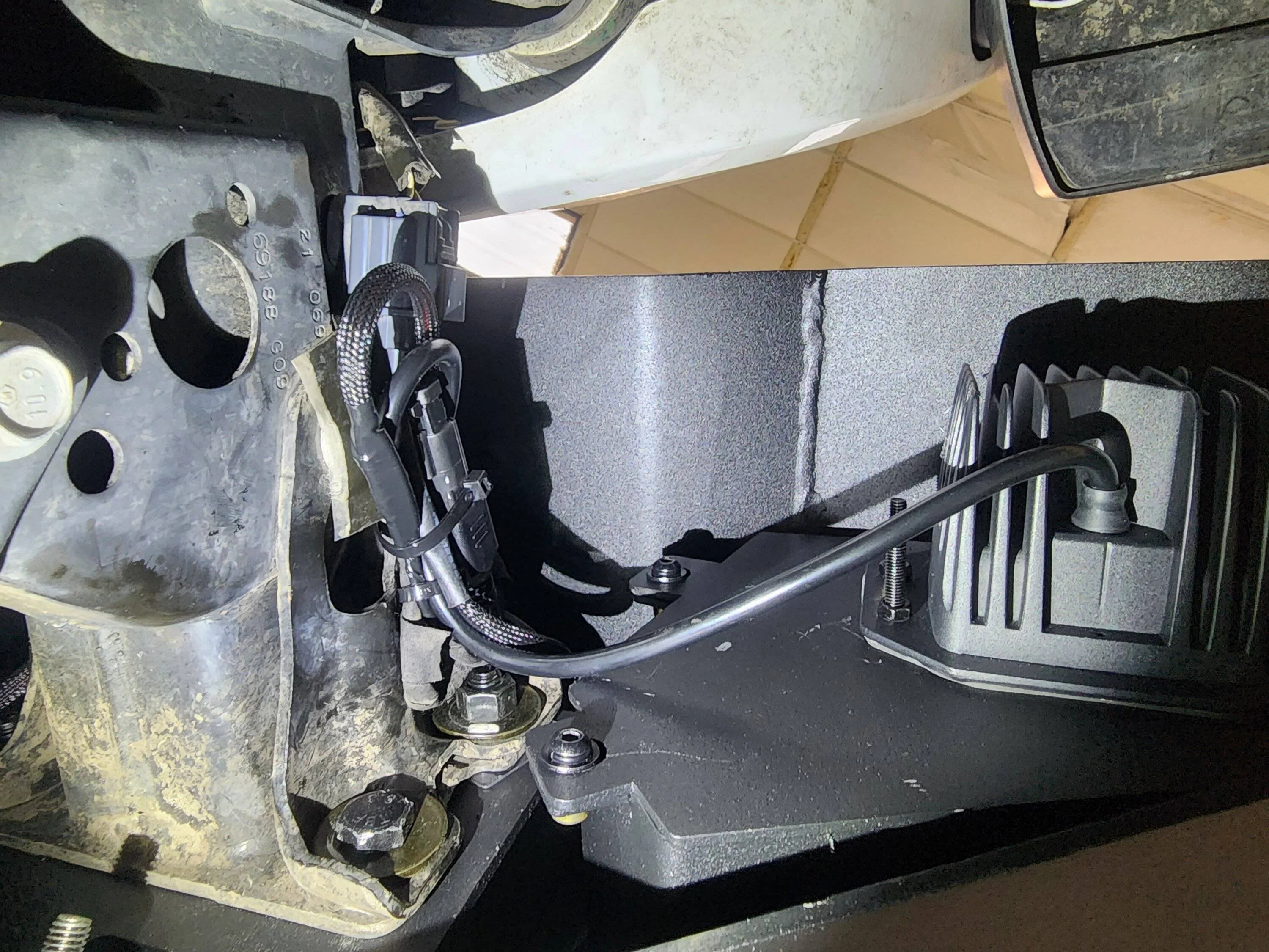

Sorry the pictures arent great, i was in a rush to finish last night and forgot to take pics along the way. I snipped the factory Fog light harness just past the cover plate on the right side where the harness split leaving about 3-4" on each leg. Then i cut my RC fog light harness leads to approximate lengths .
I found the factory harness far light wire had 3 wires (one yellow 2 black) and the closer only had 2 wires (orange and black) The factory connector back to the frame has 3 wires, black orange and yellow. For whatever reason it looks like the ground wire from the connector went all the way to the far fog light then ran a new wire back to the close light. I ended up just twisting the 2 black wires on the far light side together into an environmental splice so they'd provide ground all round. Heated up the heat shrink connectors then covered it all in electrical tape for good measure.
First picture is everything tied up but you can see the factory gray connector and the smaller RC LED connectors. Second is the new bumper and third is everything on at night. The light bar was wired into a seperate aux swich, but the fog lights use the factory button. I'm pretty pleased with the result. After tying up loose wires the skid plate from rough country hides everything away nicely.
