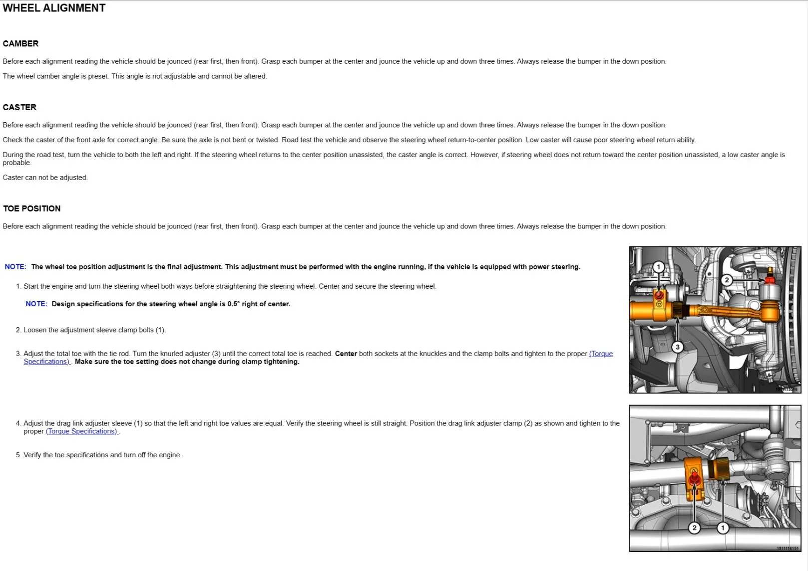

The only thing that can be changed with all stock steering is the toe.
Easy enough to check and adjust if needed.

No. I mean the offset and the off center weight probably did affect your camber some, but it's still not adjustable in the stock setup.
You can set toe without the wheels on the vehicle at all.
