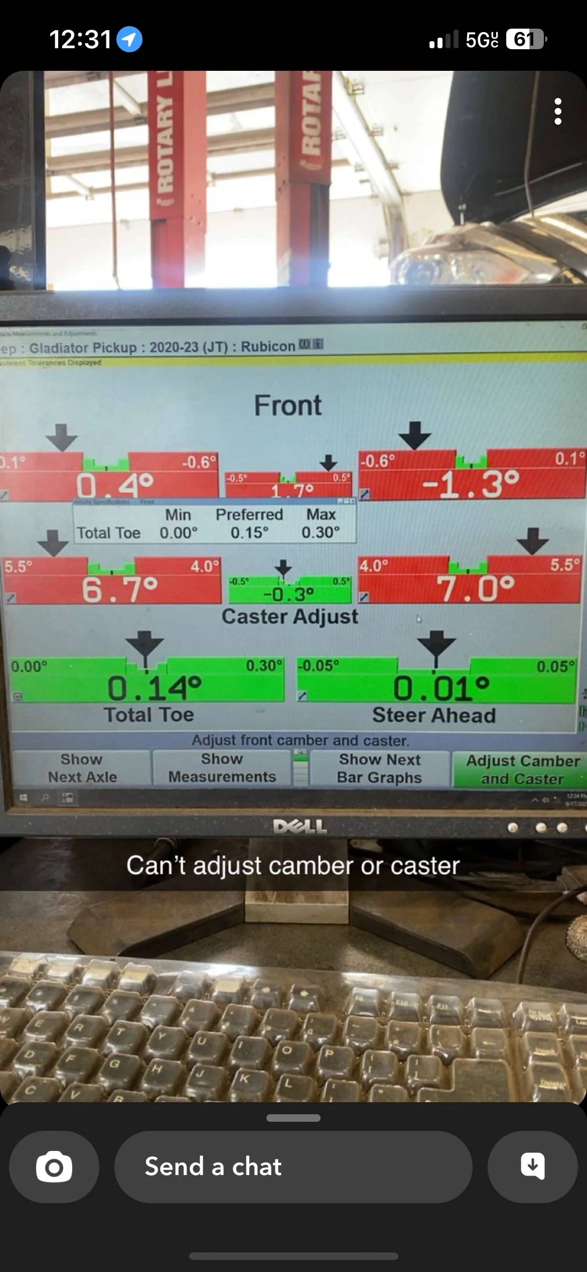

So I am running 3in lift on 35's with Rancho geometry brackets. I got core 4x4 control arms on the way. But not sure if I need them. Gladiator seems fine but like some opions.

Depends on if you like the way it drives? Caster is above spec which I personally don't like, but you might feel different?
What's up with your camber?

Fabtech say set to factory specs , but everyone with lifts say run 6fegree caster

Running about a 6 degree caster on my 22 Rubicon and its better (more docile) on the highway.
But that's just how it feels to me.
Edit: should have been said minus or negative 6 degrees.
