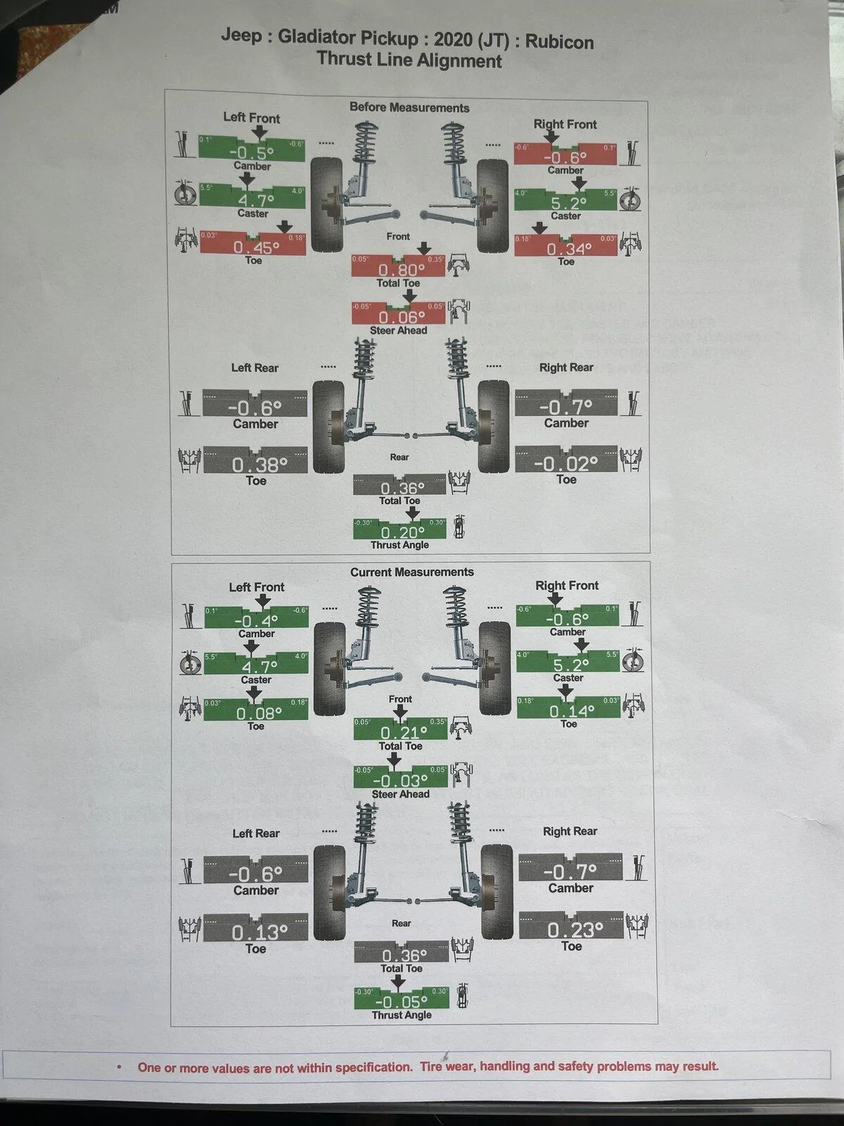

An update. I have tried re centering the steering wheel. That did not help. I tried the fuse pull trick as well. That did not help. Its a super odd feeling. It is slightly more exaggerated at slow speeds. I'll paint the scenario than upload some videos. At a stop. Clutch in. First gear. Start moving. Steering wheel starts to rotate left until the top center of the steering wheel is at around 10 o'clock. After this is stops. It stays consistent in that same spot. No matter if you speed up, slow down, or keep the same speed. You turn the wheel back to center, it again rotates back to the 10 o'clock position. I checked all my bolts, nuts, axle centering, etc. I understand my castor is a little low and I will fix that, but traveling at 3-5 mph shouldn't be fast enough for castor to have enough leverage to effect the steering THIS much.

My stock Mojave has had a slight pull to the right since driving it off the lot. Messed with tire psi on the factory AT’s and with the new wheels and KO2’s. Took it in yesterday for the first oil change and the tech drove it and said they can’t do anything about it. Never put it in the alignment machine. @JeeP Cares, here I come. ??
