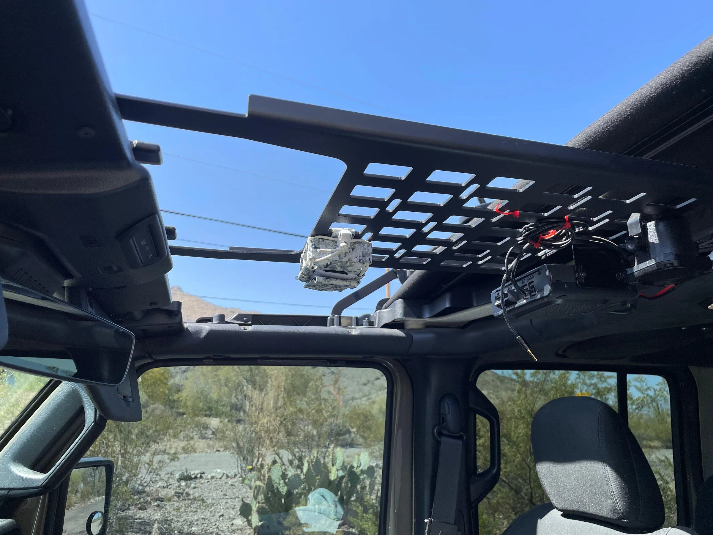

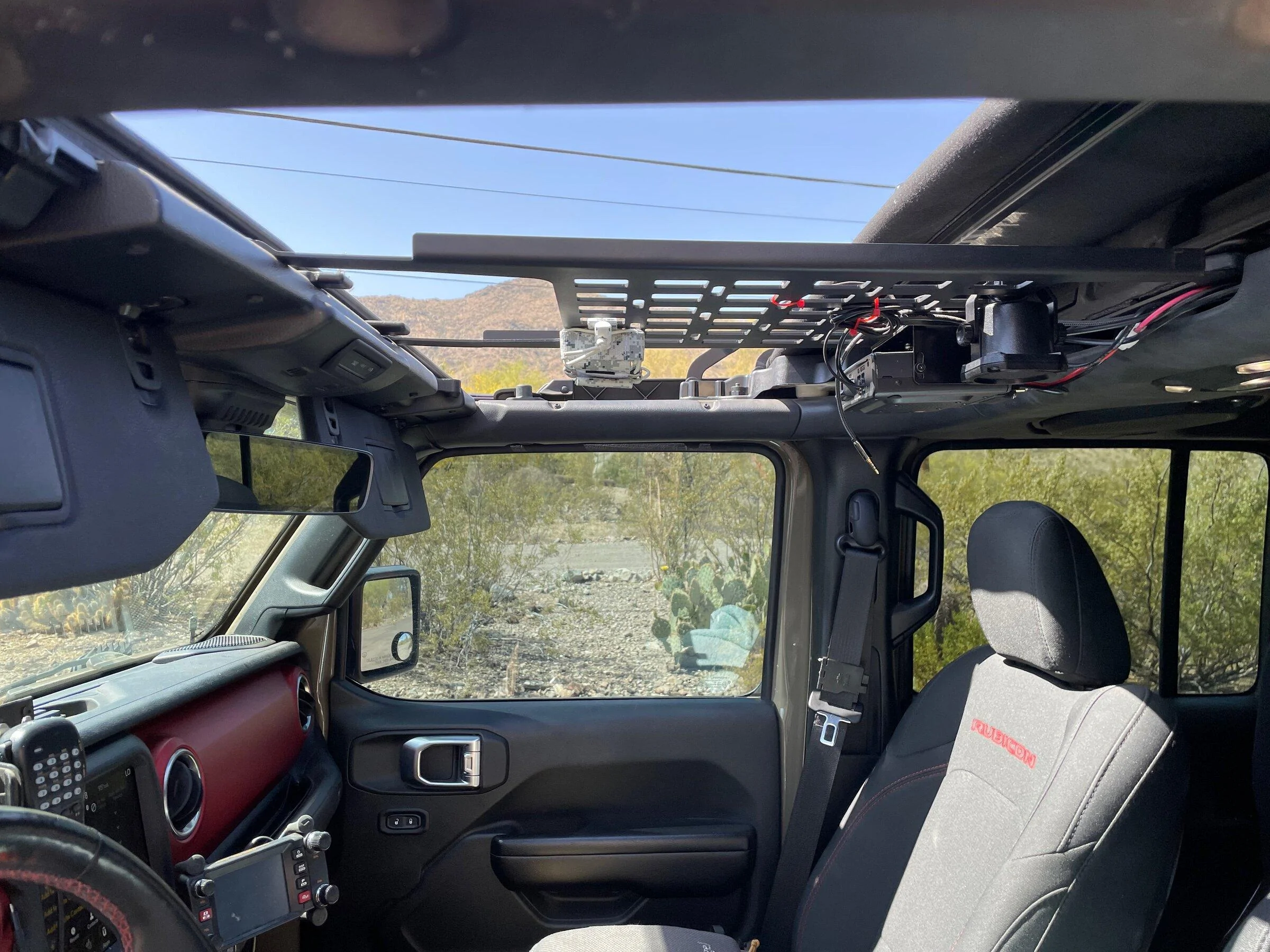

I dont have the same overhead molle system you posted, I have one that only goes from the windshield to the hardtop. If i can find the mfg i'll post the link, i dont remember who's it is. I also have the Sunrider and the pair do work together.
However, i did need to do a bit of 'modding' to get the Sunrider mounting hardware to fit. I'll try to post some pics later today.

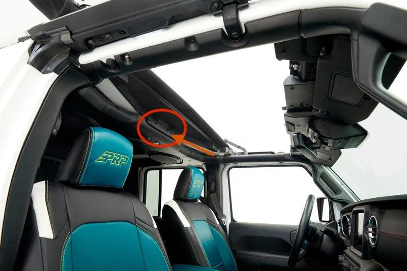

There is a piece of Sunrider hardware that mounts to the part of the hardtop that stays on the Jeep. So, you remove the Freedom Panels, now you have the aft half of the hardtop still on the Jeep, in the forward section, in the middle, is where the Sunrider hardware mounts. That is also where the molle systems mounts. I found a stock pic and have circled the piece in question.
If memory serves me correct, I had to remove some material from the Sunrider hardware to get the molle to fit in the correct location for mounting. The hardware is a hard plastic, imagine that. My molle panel was designed for the stock circled section to integrate with the molle install. The Sunrider hardware is not designed for anything to integrate. But, being Jeep folks, when has that ever stopped us from integrating anything to anything?
I'll see if I can get some decent pics of my set up this afternoon.
Jeep Gladiator American Adventure Lab Overhead Molle with Bestop Sunrider Sunrider
Hmmm if I recall correctly, my method of making it work was a box knife and a mallet🤣

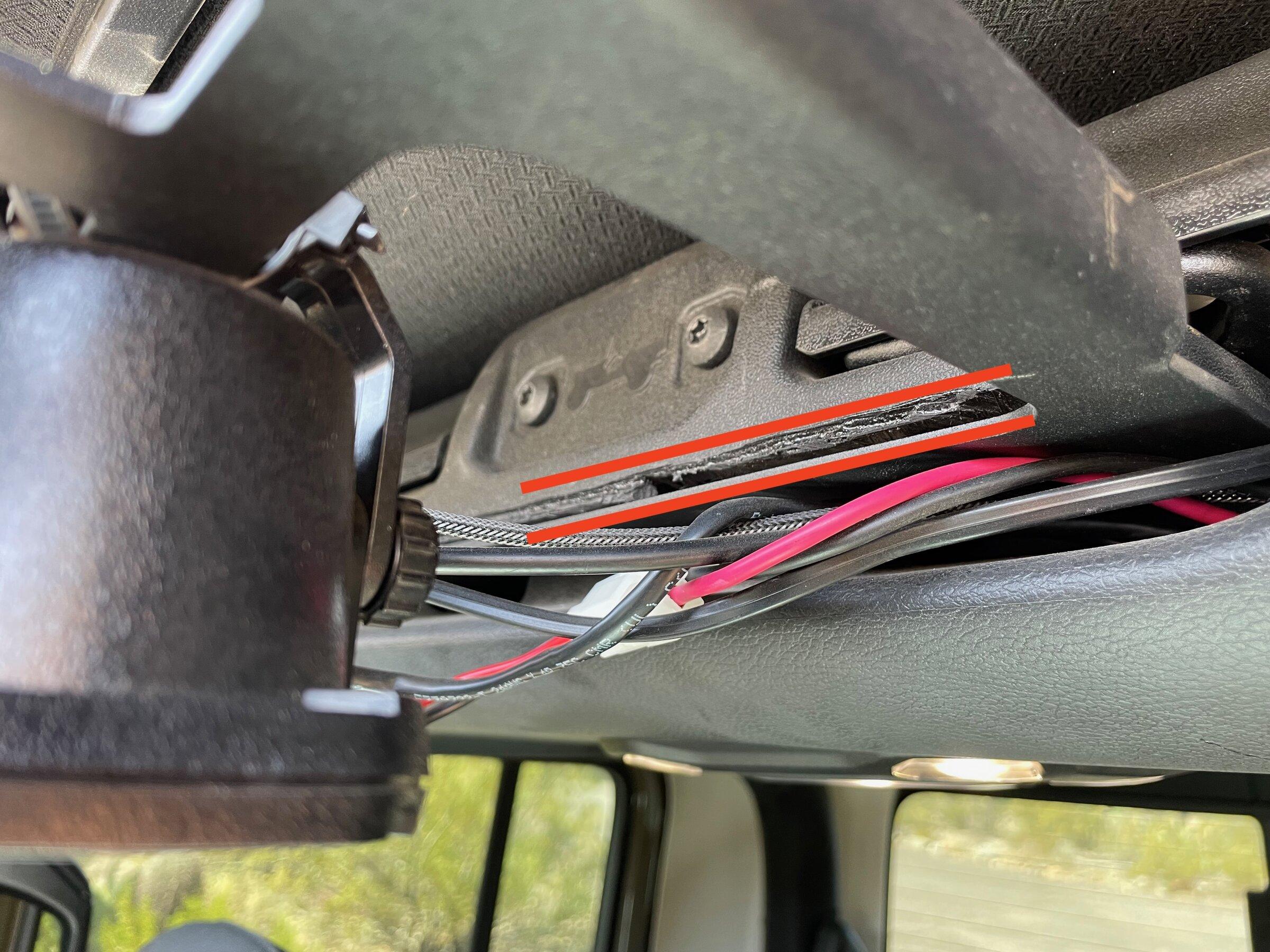

Actually I just remembered what I had to do, I had to cut about 1/3 of the plastic insert that came with the sunrider top for the middle rear. I believe my overhead panel was the JCR overhead molle panel.

Selfmod, oh yeah! A mallet was involved in my 'mod' also.
I used a dremel and went through a couple little discs. Obviously, when working with plastic, it's a fine line between cutting and melting.
The JCR is the rack I have also.
https://www.jcroffroad.com/product/JLOMP-PC.html

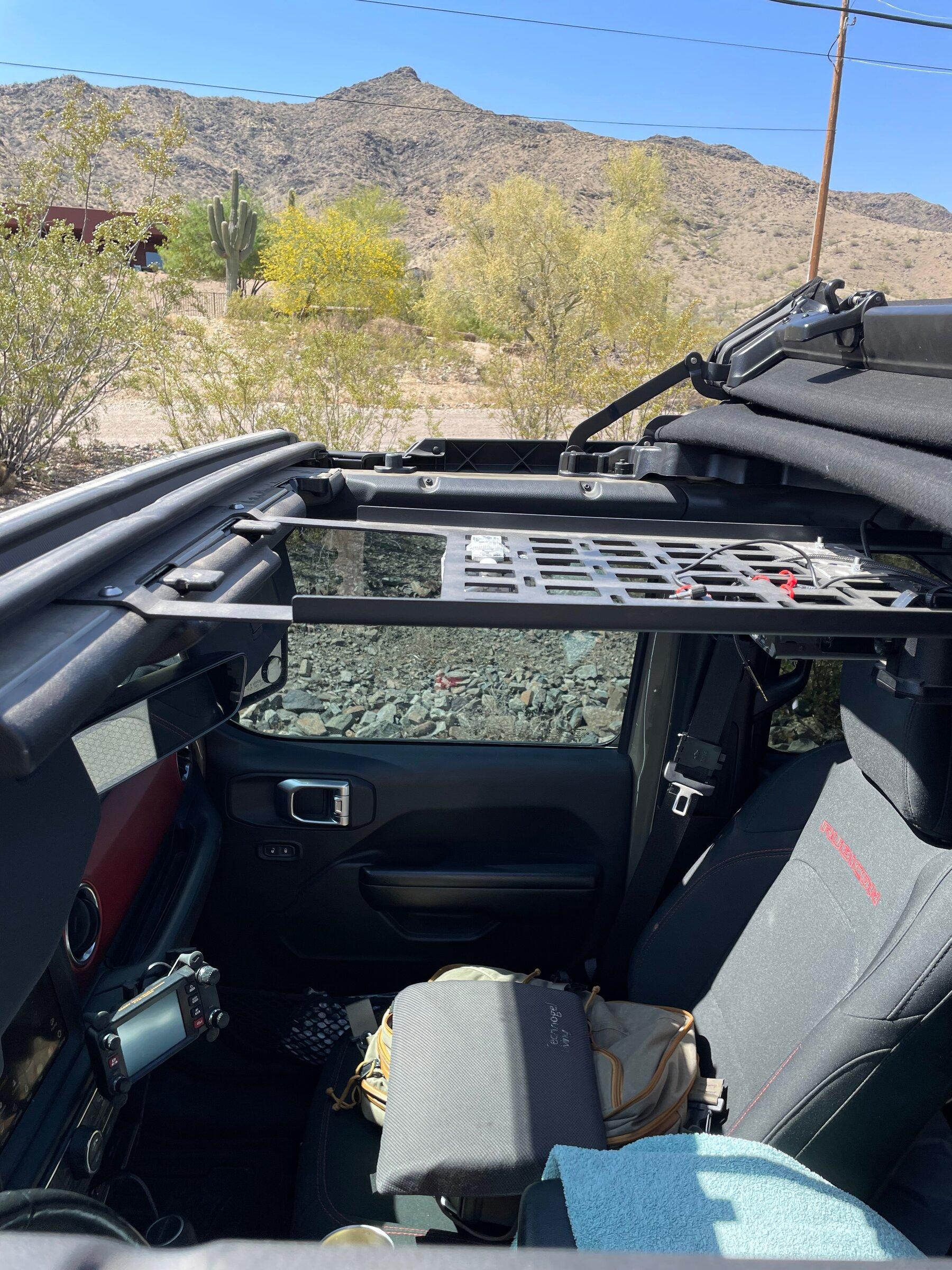

The AAL molle looks cool, but i really question the usability of the rack that is directly overhead. i did hang my CB from the JCR rack but i hated having the cord hanging below eye level. For me it was too distracting. I can tell you that there is no way I could have anything over my head or in front of and above my head in this truck. There is just not enough room. Right now I have the body for my ham radio hanging, an external speaker for my CB and a molle pack for another couple radios i carry. My .02 cents.
If you look between the orange lines you can see that the plastic has been modded. I was a little nervous about cutting on this piece, hoping it would not hurt the strength of the part. I've done a few road trips now, zero issues.
