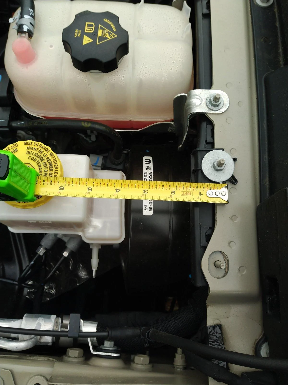

Has anyone installed a relay box? If so which one and where did you install it? I ordered this waterproof fuse/relay box from amazon and I couldn't find a good place to mount it in the engine bay.

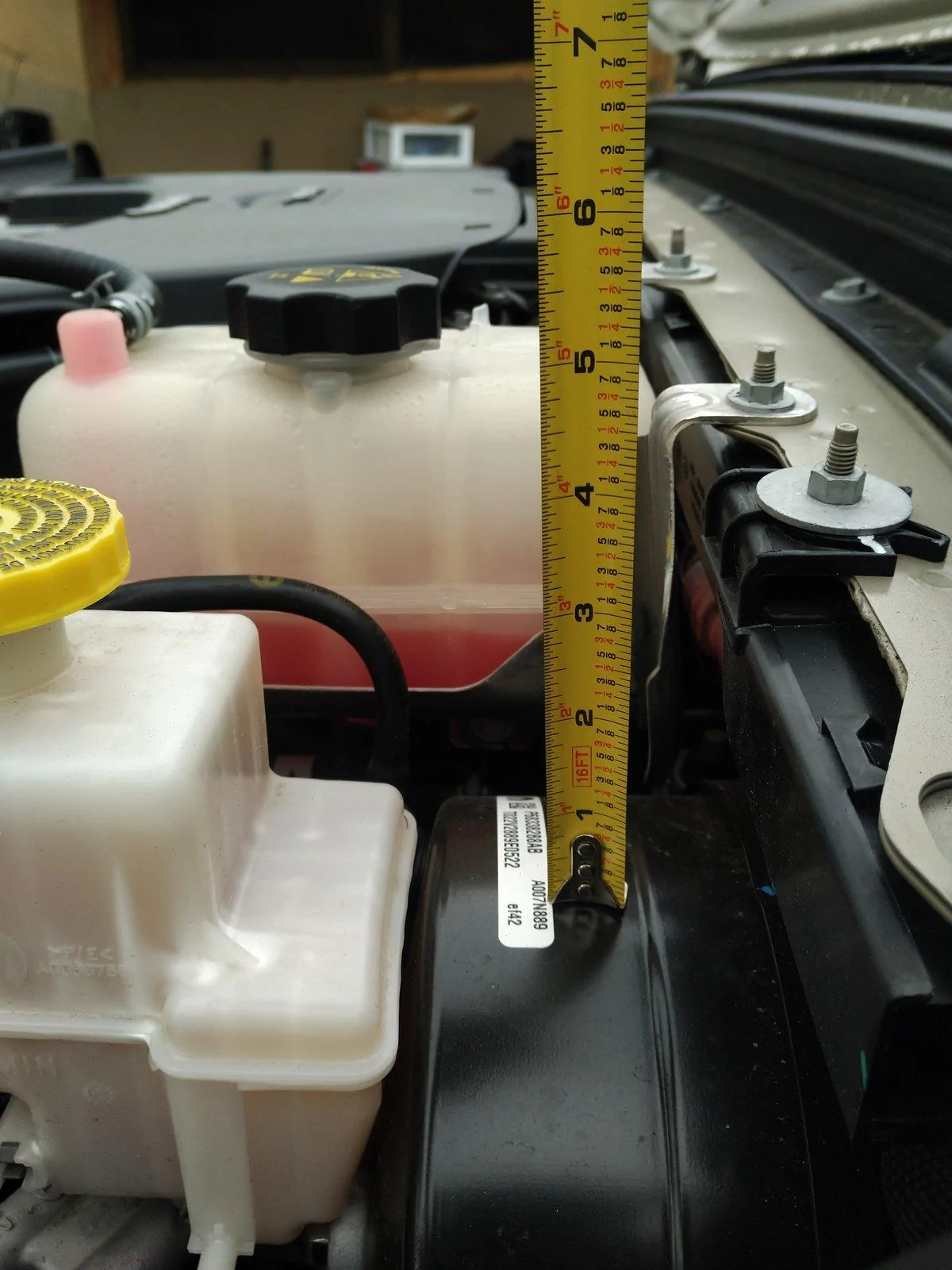

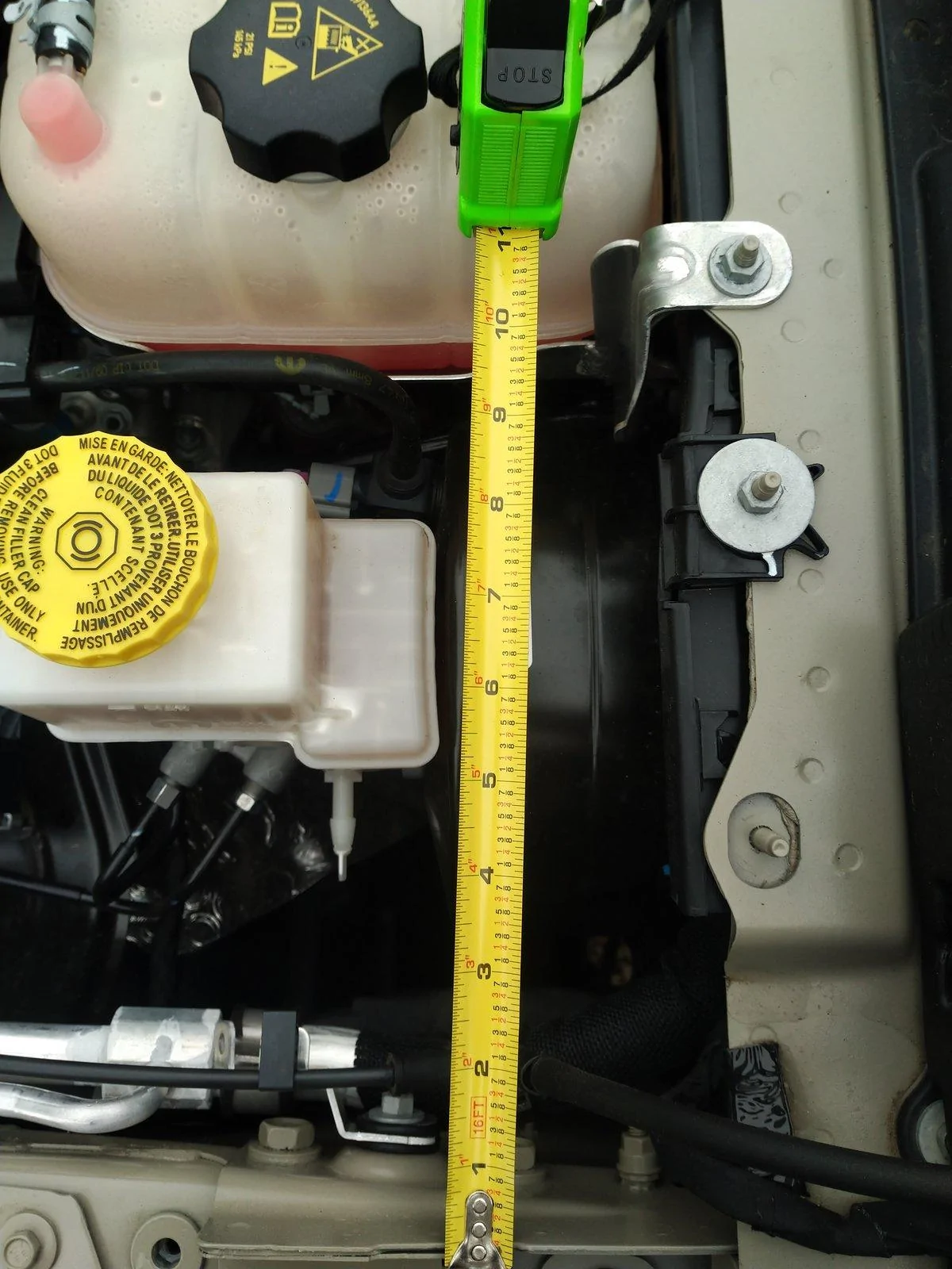

From some measurements I just eyeballed, you could make a bracket (s) and mount above the brake booster and have wiring *box" access to run wires though too. Remember the hood don't set down right on top of engine. So that area might be worth looking into. Aluminum flat stock is not to expensive and easy to bend to shape with a vice but try to have at least 3 ( tri-angle ) attachment points to stop vibration and metal fatigue if you do.
You are right it does fit nicely there... Thanks!
Hopefully I will have time to work on the mounting bracket this weekend, will post pictures of the end result.

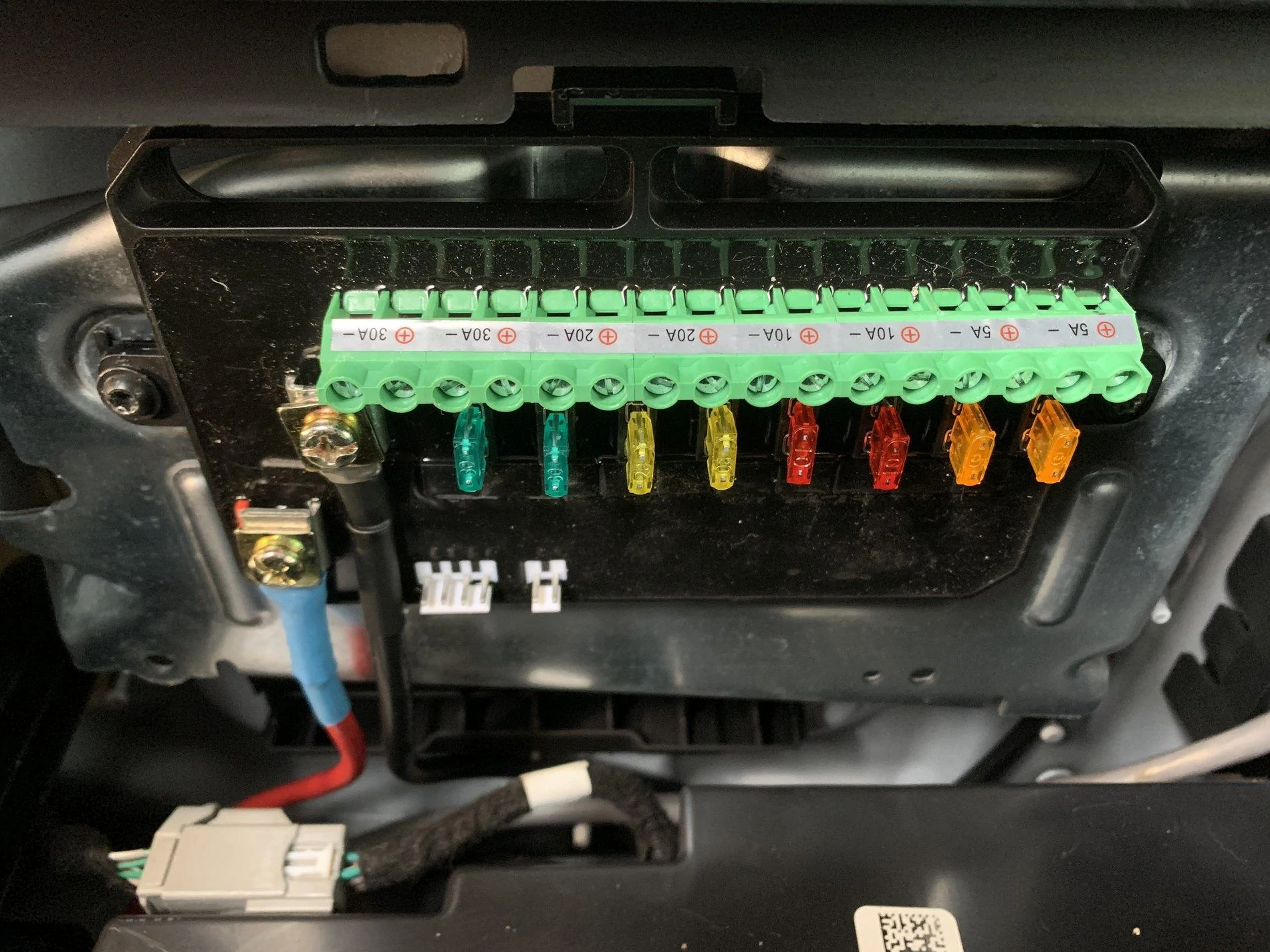

I ended up getting a complete kit on amazon. LINKY
WAAY cheaper than the SPOD!

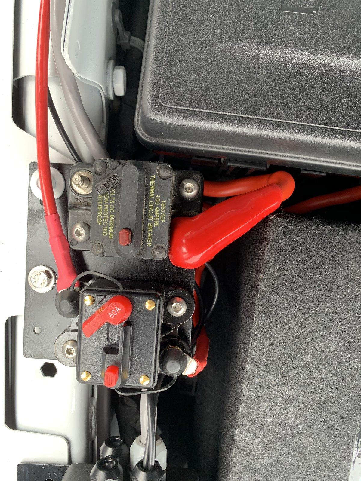

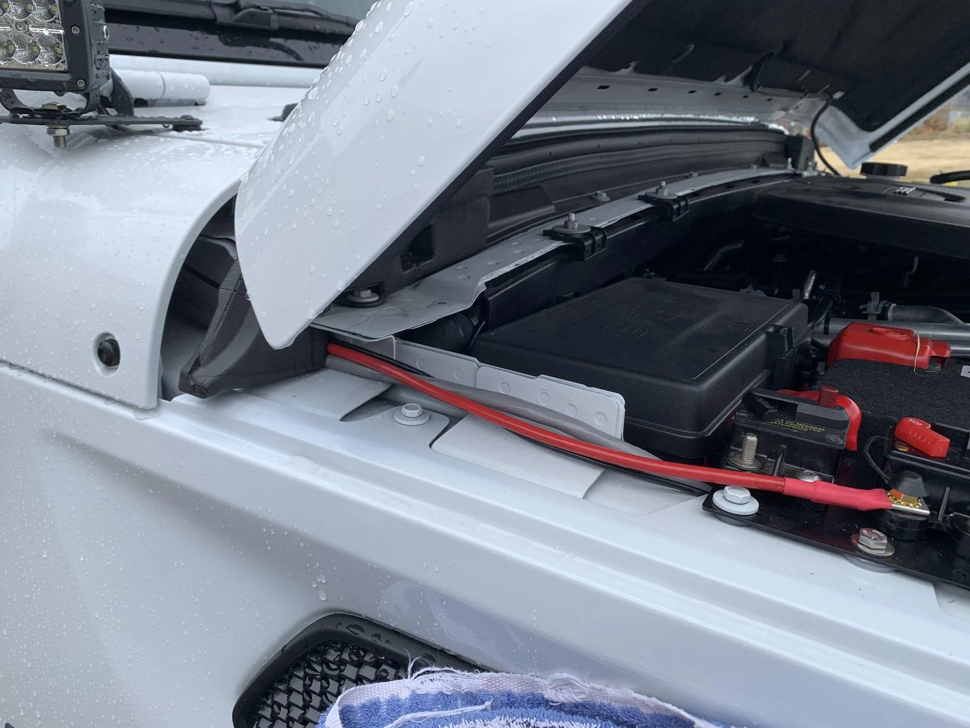

Installed the main breaker next to the battery.
Jeep Gladiator Anyone installed relay box? IMG_0269

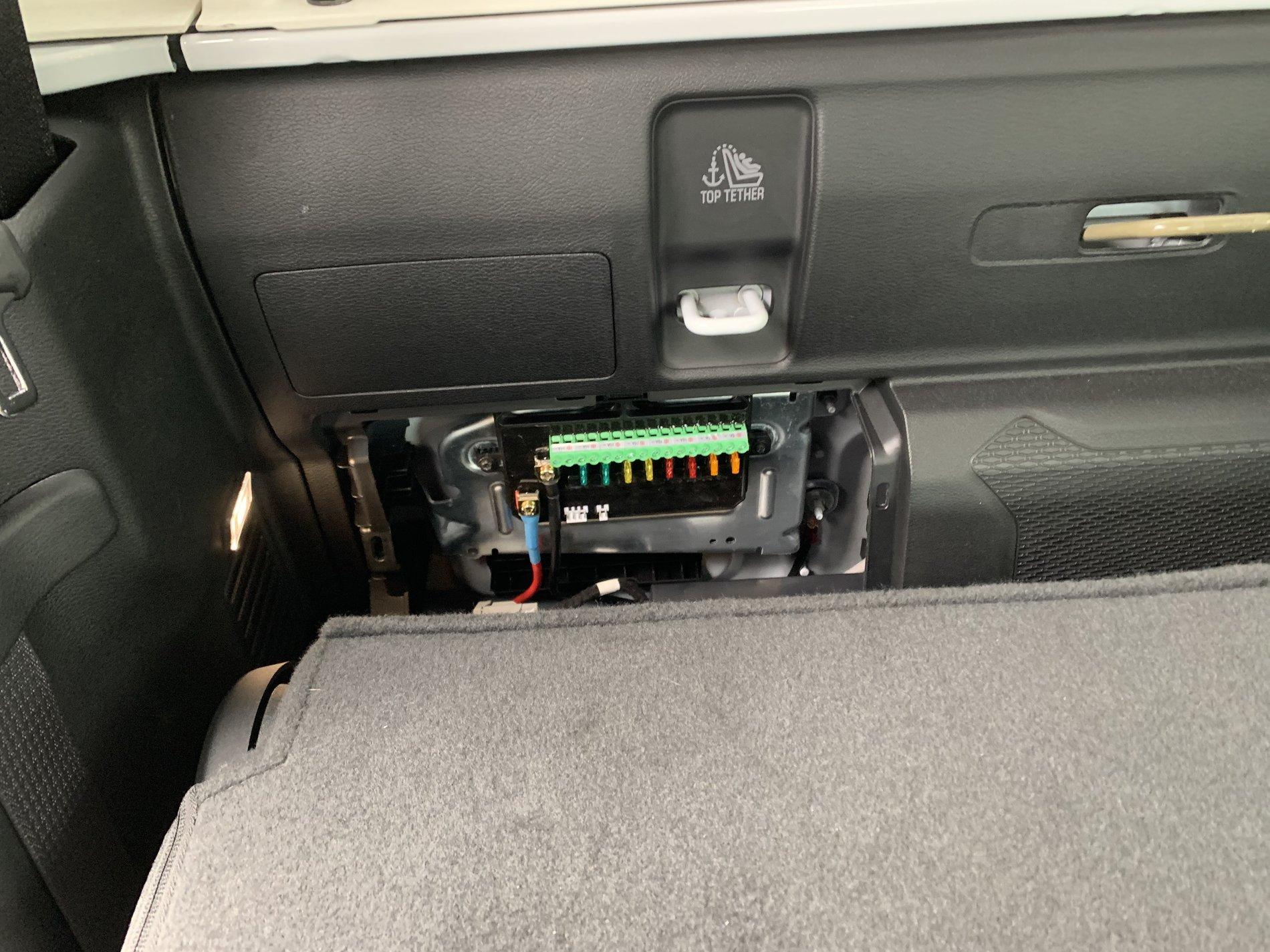

Installed the SSR/fuse panel behind the passenger side back seat, had to lose the plastic bin though.
Jeep Gladiator Anyone installed relay box? IMG_0272
Jeep Gladiator Anyone installed relay box? IMG_0271
