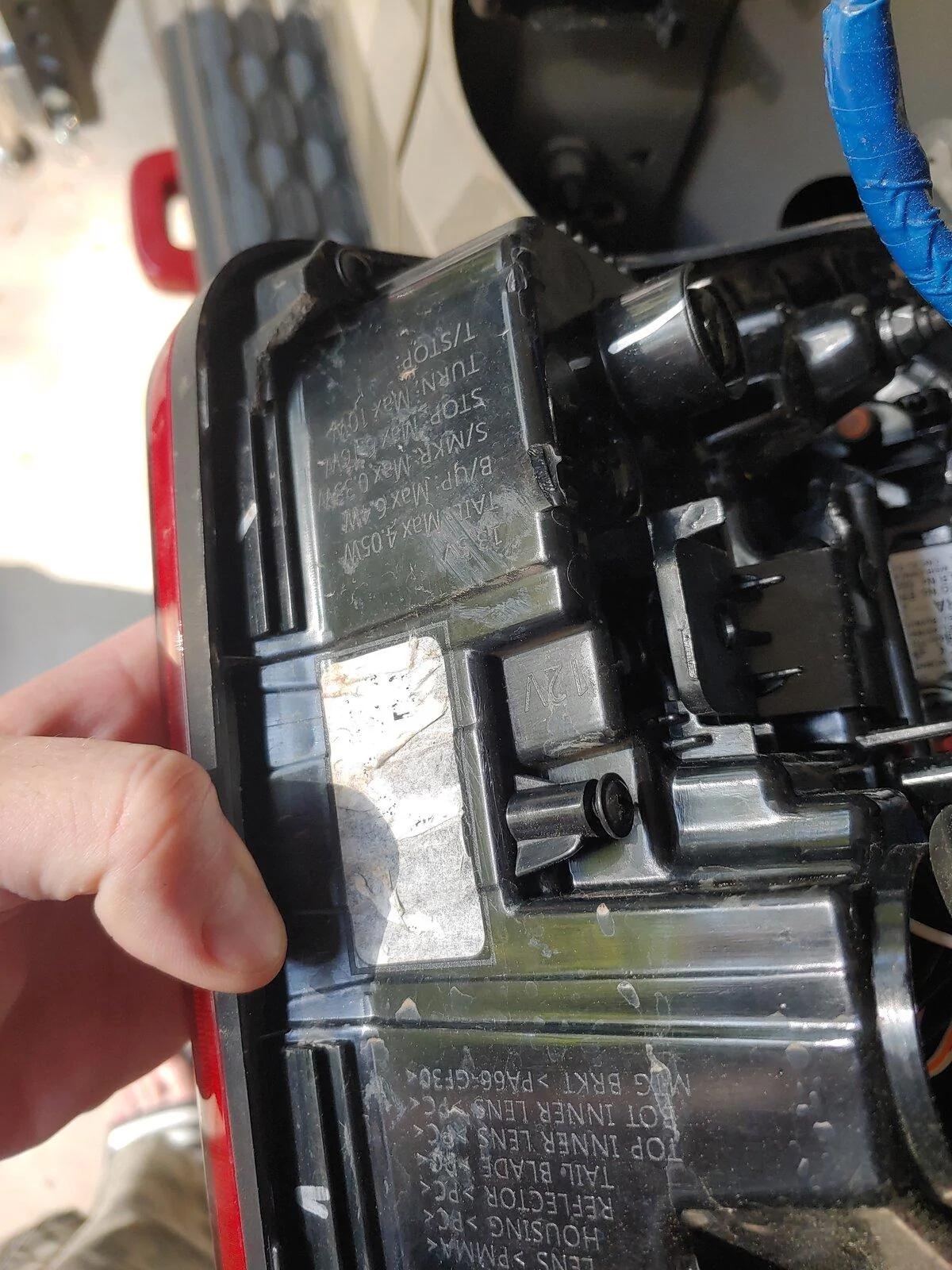

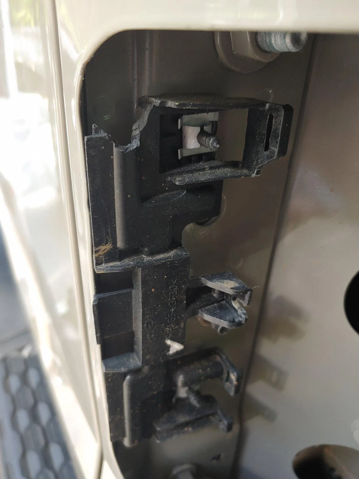

Hi guys,
Tree jumped and took my passenger side tail light out. Basically, I slid in mud and scraped off tail light. The tail light is all in tact, however plastic hooks on the light assembly and on the body of the jeep have brock off. Since it is a "fully loaded" tail light with all the bells and whistles it is too expensive to change the whole light. Hence, I thought since actual light assembly is good, maybe I can change those brackets?
Anyone done it or know what parts to order?

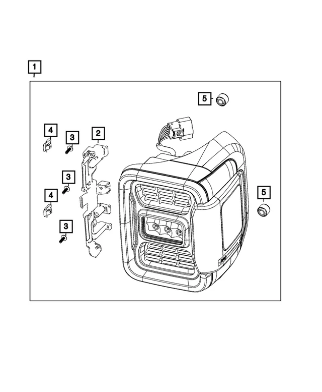

Hello, i have exactly the same problem, for the both lights falling on the street yesterday...
I have found this picture on mopar web site, it is of course the part "2"

I believe I found the ref:
68518252AA
for the right side, and
68518253AA
for the left side
