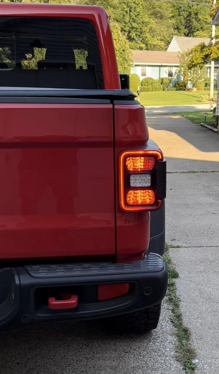

Hello friends, happy new-ish owner of a used 2020 JTR with 42k miles, so warranty is out. A kind person stopped me the other day to let me know my right rear tail light was flickering. On the ride home, I did notice flickering reflecting off a car behind me. Once home Jr. and I tried to replicate the flickering and could not. However, it's clear there's trouble. See image...
The one 'segment' is out (top right) and the bottom right of the surround is dim.
1. Is my research correct that fixing this requires replacing the entire assembly?
2. If yes, seeing how the assembly is ~ $500... Has anyone had good luck with aftermarket LED tail lights working well? Any recommendations? Saw some on Amazon with good reviews that are slightly more than half that for both left and right, and even have "motion", similar to my Mach-e, so that's a plus.
Any insights or advice would be much appreciated, thanks!
