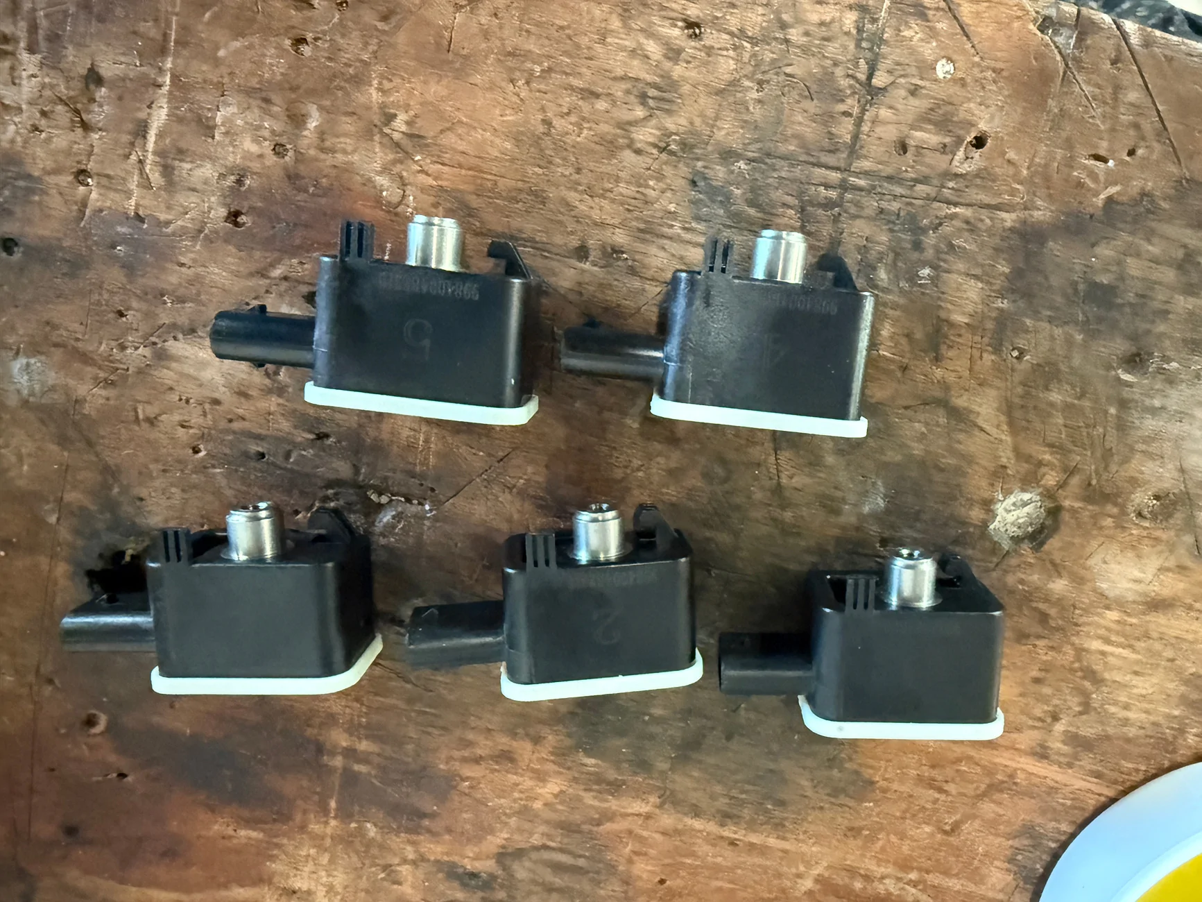

Jeep Gladiator AUTOTECNICA Locker Sensors - Are they potted? IMG_5910
They come in a set of 5 just like the OEM ones also. I tested all 5 on my JT with the locker light blinking - Interestingly, 4 of the 5 worked! (turned off the light) - Only #4 didn't turn the light off.

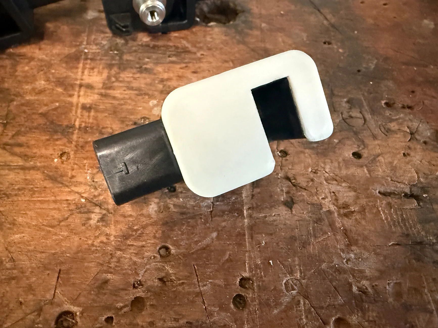

Jeep Gladiator AUTOTECNICA Locker Sensors - Are they potted? IMG_5838
The top caps on these units are not translucent like the OEM ones are (which allow you to see the oil intrusion).

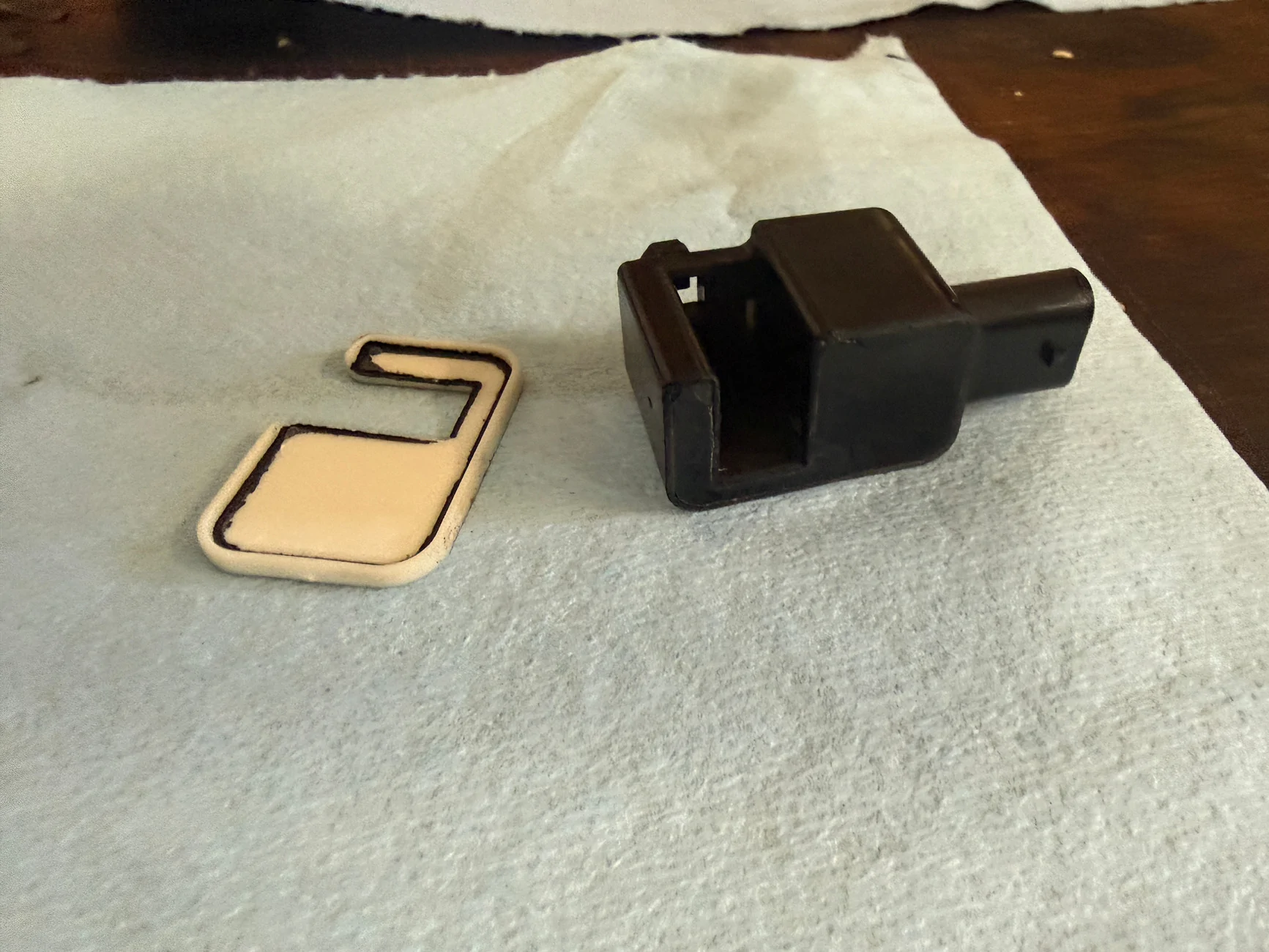

Jeep Gladiator AUTOTECNICA Locker Sensors - Are they potted? IMG_5839
Prying the top of reveals a nice layer of black epoxy! It's sealed so well, I'm not sure why there is even a cap on it.

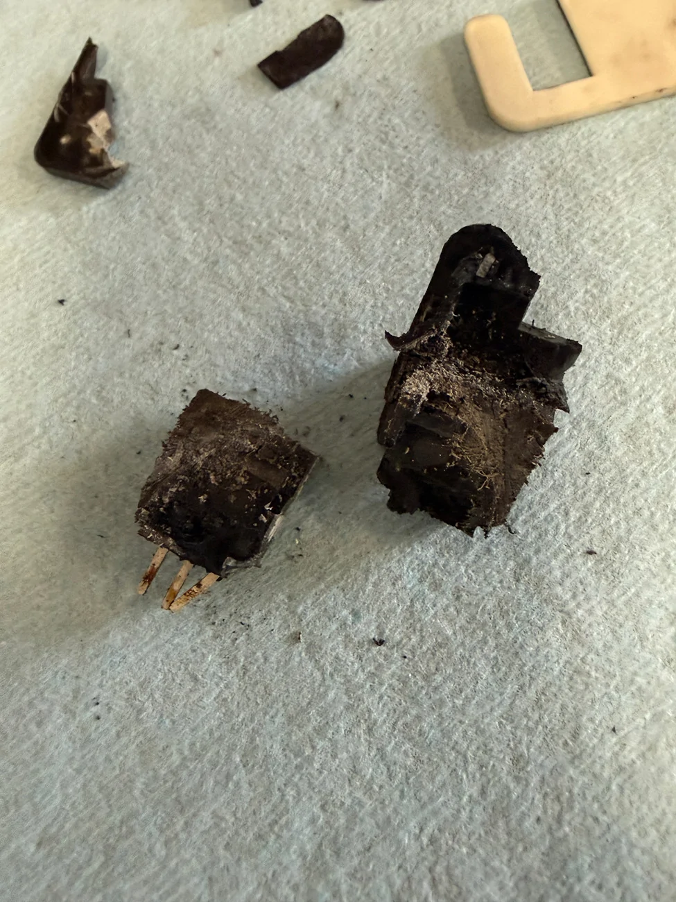

Jeep Gladiator AUTOTECNICA Locker Sensors - Are they potted? IMG_5853
Further disassembly shows the circuit board fully encased...
Jeep Gladiator AUTOTECNICA Locker Sensors - Are they potted? IMG_5856
My conclusion is that these units are better than the OEM units, and at ~$80 from RockAuto, this is a much better solution than the Zlocker bypass cable, as you get back the original OEM functionality for a cheaper price AND you get the added benefit of having to change the diff fluid!!
