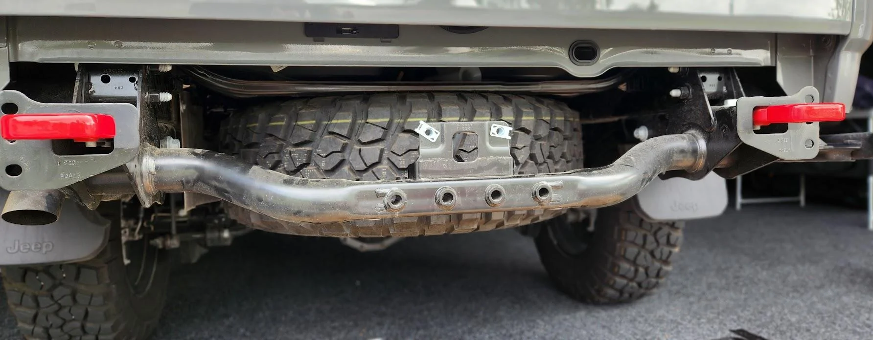

Hi everyone, does anyone know if a hitch receiver can fit on the bar I got on my rubicon? I ordered the curt 13434 ... too quick and after removing the bumper, I just realized that there is no way that it will make it :) as the flat plate isn´t on that version... I want to avoid to replace the whole bar... it seems that there holes have a purpose... but knowing Jeep, it must be a funny one :)
Thanks for your feedback.

It looks more like the setup of the wrangler JL with something like this
https://www.amazon.com/dp/B08V5RWMB...p_csd=d2lkZ2V0TmFtZT1zcF9kZXRhaWxfdGhlbWF0aWM

You just want the receiver. It bolts to the bar as pictured. See if the one you have lines up. May be a different receiver for Rubicon, but I just looked at mine and it’s similar. Ask forum member @AllMoparParts.com to verify fitment.
Jeep Gladiator Bar with 4 holes on Rubicon 1666954007273
fredjeepgladiatornz26
Fred
Oct 10, 2022
New Zealand
Jeep Gladiator Rubicon 22
Thanks, I don't have that plate present on the picture, the bar on my rubicon has the reference Mopar 68358469AA
Mopar comments it as following: Rear trailer hitch WITHOUT receiver. For export models only
I took measures and the one with the 4 bolts must fit, so I will give a try and let a note here in case someone faces the same issue one day.

We just put one on my brothers JL Rubicon. It was a tight fit but after the holes lined up, we torqued it down and he was ready to go. Hope it works out for you.
Blade1668
Darrell
Jan 7, 2020
3,273
3,160
N. AL.
Something to notice is "Export" so there can be some odd differences.
Not any helpful information for you but might cut ridiculous answers and comments. :like:
JRobes
Oct 27, 2019
947
1,505
South Dakota
Enginerd
I think you're on the right track, and need to now bolt on the additional aftermarket hitch.
Personally, I'd just remove the base hitch you have currently installed and replace it with the proper US spec one designed for the gladiator (like what @Summitsearcher posted above).
If you decide to continue to piece it together with multiple parts, make sure each component meets or exceeds the tow rating in your door jamb so those components don't reduce the vehicle's towing capability.
Another option: if you keep an eye on local marketplace listings sometimes members post their OEM hitches for sale for cheap if they needed to remove theirs for a new aftermarket bumper or bed bob project.

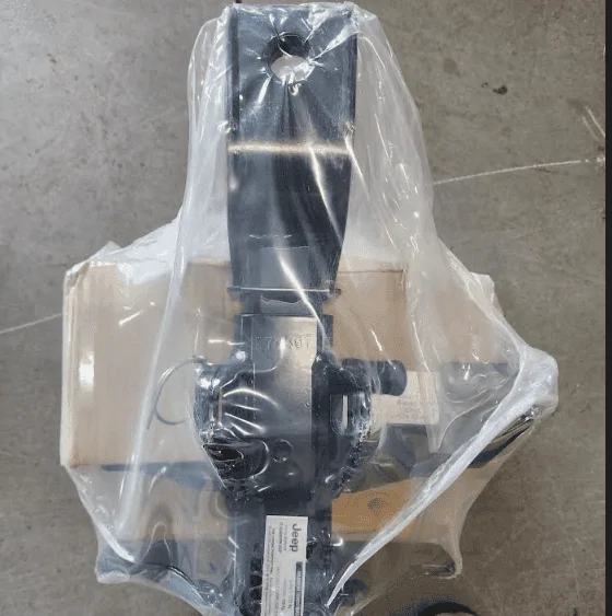

Another update here for the export rubicon (Oceania, Australia/New Zealand), it seems that Jeep narrows the choice of options to.... only one :)
Dealers are selling the part 882200JTTB - tow bar fitting the OEM bar...
Jeep Gladiator Bar with 4 holes on Rubicon Towbar
So customer must be ready to pay NZD 1800 for it... hum not yet ready here :)
On a positive note, that OEM bar looks strong :) as the hitch has the braking capacity of 2700 Kgs

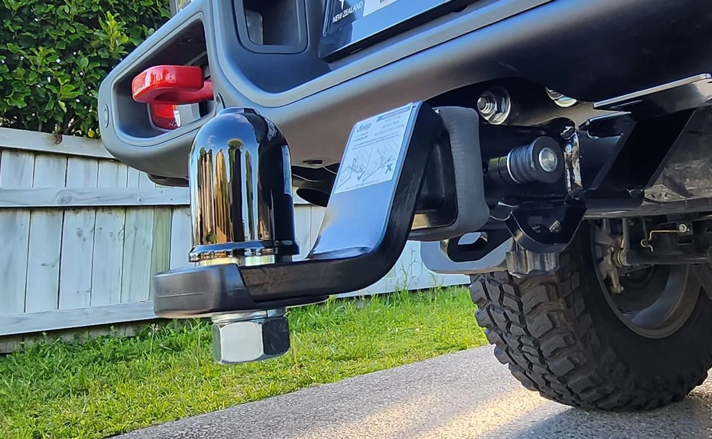

Just an update, I finally bought the OEM hitch they sell for the APAC regions, so 5 minutes to install it and I don´t expect to have difficulties to plug in the OEM wiring harness.
