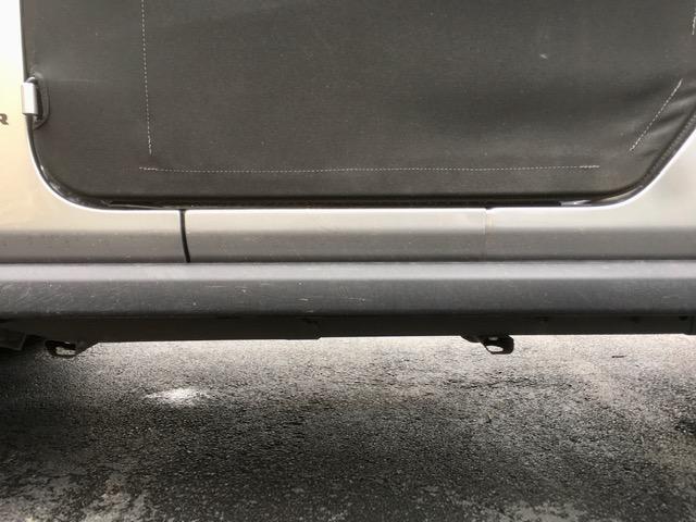

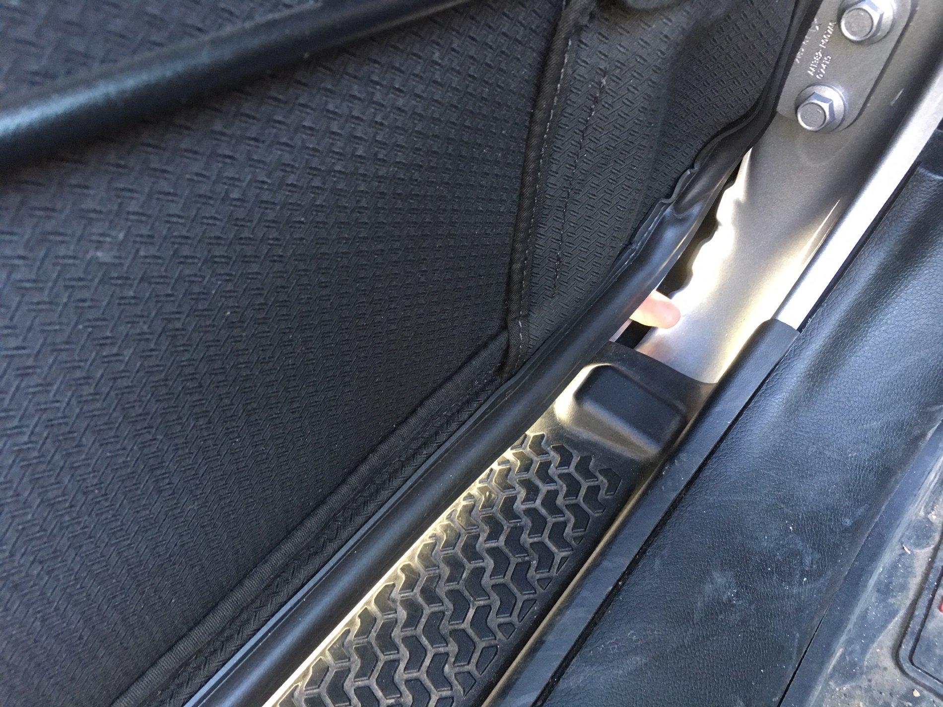

Thanks, J&D, but I tried this. If you look at my pics, the door seams were parallel with the door edges. I adjusted the door as low as it would go. While that helps align the latch, it cocked the door at an angle and failed to get any of the gasket to seal. There was more than one problem.
First, the hinge pins were welded too low in the Bestop door frame. I could place a finger (without pushing through the gasket) between the bottom of the door and the body when it was closed. I could see sunlight shining through.
Jeep Gladiator Bestop 2-Piece Full Fabric Doors, Front JL SKU: 5175017 2202F552-C4B0-49B8-9442-4626EE5E2D12
Jeep Gladiator Bestop 2-Piece Full Fabric Doors, Front JL SKU: 5175017 6CF7D909-517C-48DE-9AAB-F70B9293EEF0

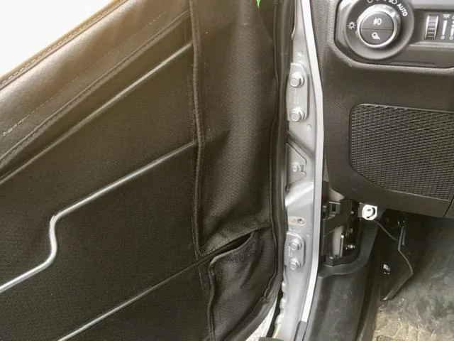

Second, the door’s frame/gasket didn’t take the Jeep’s hinge plate into consideration. It was binding and requiring me to force the door in a significant distance.
Jeep Gladiator Bestop 2-Piece Full Fabric Doors, Front JL SKU: 5175017 9570E14F-018D-472A-9706-538D58D0E208

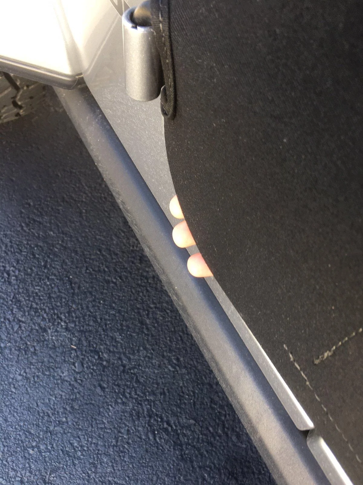

Third, the radius on the front lower corner doesn’t properly fit. This pic is mine, but I’ve noticed it on another owner’s pic (on this site). The door is shut and my fingers are through the gap. They didn’t force through anything.
Jeep Gladiator Bestop 2-Piece Full Fabric Doors, Front JL SKU: 5175017 34DB4F8A-8800-4C06-AD6B-CB80FC0D8541
Again, I wanted these to work. I’m mechanically inclined and this is my 5th Jeep, so I’m confident when I say the level of modification required to make mine fit was a problem with design and/or manufacturing and was not going meet my standard. I honestly hope mine were a defect and yours work out for you.

I hear what your saying...and I'm not a best top rep or anything....but considering how far off mine were...i was happy they got as snug as they did. I definitely have some gaps...and places water will get in....but what I do is use the factory doors from sept-april...then put on the soft doors, pull out all the carpets and pull the floor plugs. I know water will get in, and it will drain out. There is no other way to go doorless in less than a minute...and they all fit in the bed so you can bring them with you. I have the tops bent so they are snug now....the only thing I am waiting for is some highway driving to see if the front corners lift away from the frame. Sorry yours don't fit better.

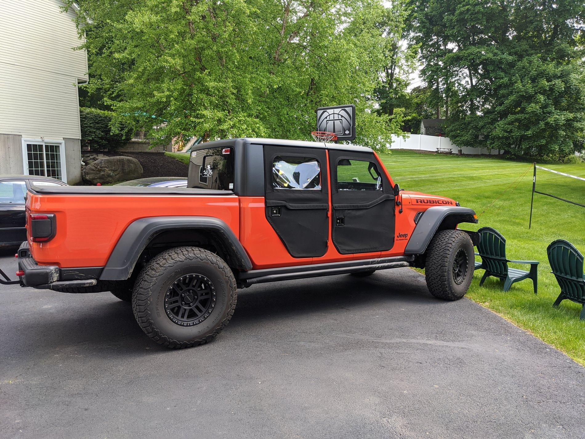

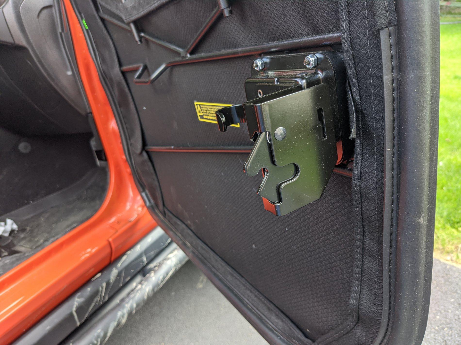

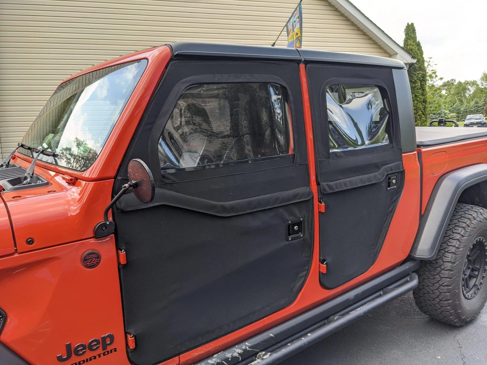

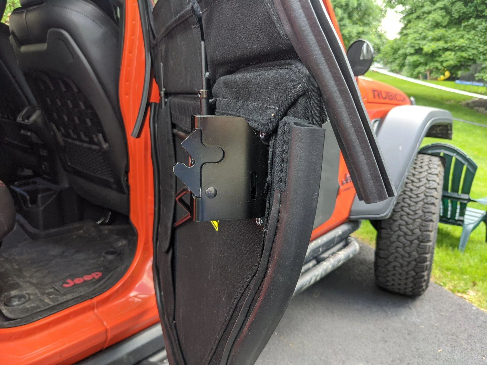

I can provide some info from my experience with soft doors. I had them on my JK for 6 years every summer and hated them, but I loved them because they served a purpose. I prefer to ride w/o doors as often as possible and I'm not about to lug around 4 x 80 pound doors every time it's nice out. The soft doors pop off and throw in the garage, or in the trunk of my Gladiator. Here are some experience info for you.
- If the latches are off by 1-1/2" like the photos., switch the left and right latches and they will be fine. My fronts were aligned but the rears I had to switch. Possible typo in manual
- Remember to loosen the 2 nuts behind the fabric to adjust the doors so they fit in the bottom as good as you can get them. Make sure to do this w/o the top half installed and the latch bolts loose. Spend the time doing this to make the best seal and alignment.
- Buy pipe foam insulation from Lowes and cut sections to wrap with zip ties on the metal bars of the doors which will cut down on the flapping noise.
- The top corners of the front doors will flap and pull out on highways. I tend to play with bending the top halves in once in a while to cut down on this. If I'm going on a long trip I'll bring bungee cords to attach to the top corners on both sides and pull them in.
- If you get them adjusted pretty good you will rarely get water on the floor
- If you lay them down put yoga mats between them to prevent scratching the isinglass.
- Keep sweat pants in the Jeep because if its cold out and your on a highway you will get a cold breeze on your left leg.
The best advice I can give you is get them setup perfectly and then try to drive w/o doors whenever you can. I assume if you bought soft doors it was for the convenience of taking them off quickly. I recommend leaving doors off for as much of the summer as possible and have a blast cruising around with no roof or doors like a Jeep was made to do.
-Mike

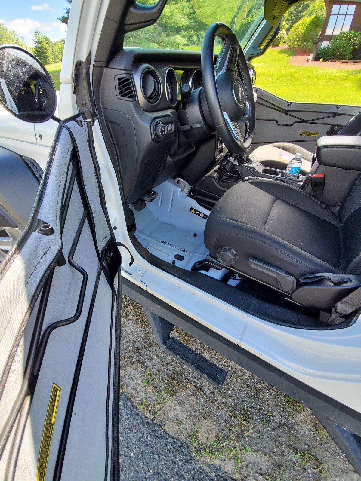

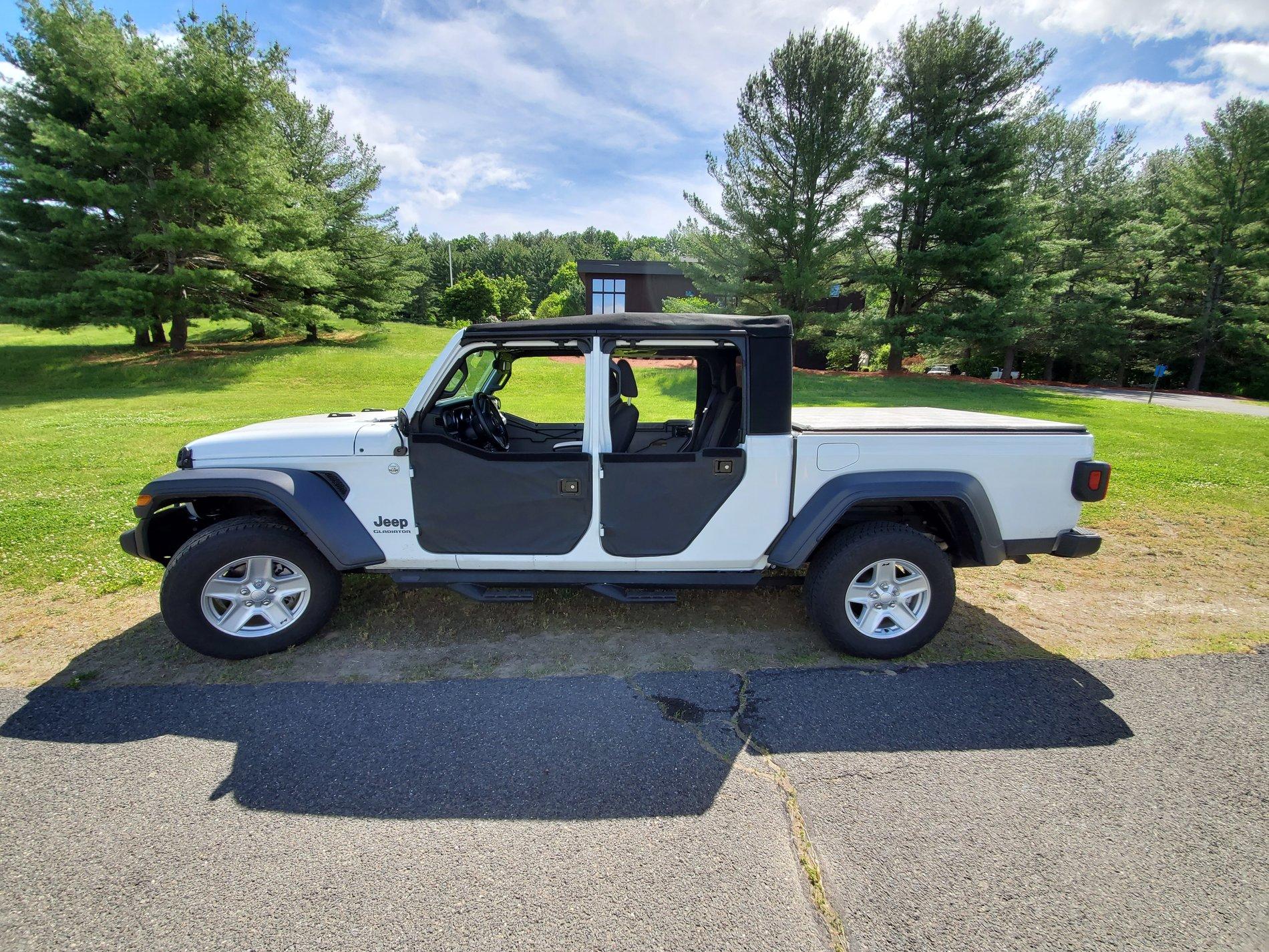

Thats strange, I took the drivers side out no problem...no need to remove anything....and my floor is painted white...mind you with the factory soundproofing the paint is already coming off.
First real hard rain last night and I actually got no water inside...that surprises me with all the little gaps.

Yes, it is white. I will say, in my 2012 sport, the sound proofing almost looked like welds on the floor...this one is like a gummy substance, I sticks to my shoes...so im not really sure what to do with that.

So thats what that stuff is, lol. I was wondering what that was. I ended up just putting my weathertech mats back down so I don't even really notice or miss the carptet. Drove with the doors off today, no noise difference. Will need to try with the doors if I ever feel they need to go back on, lol
