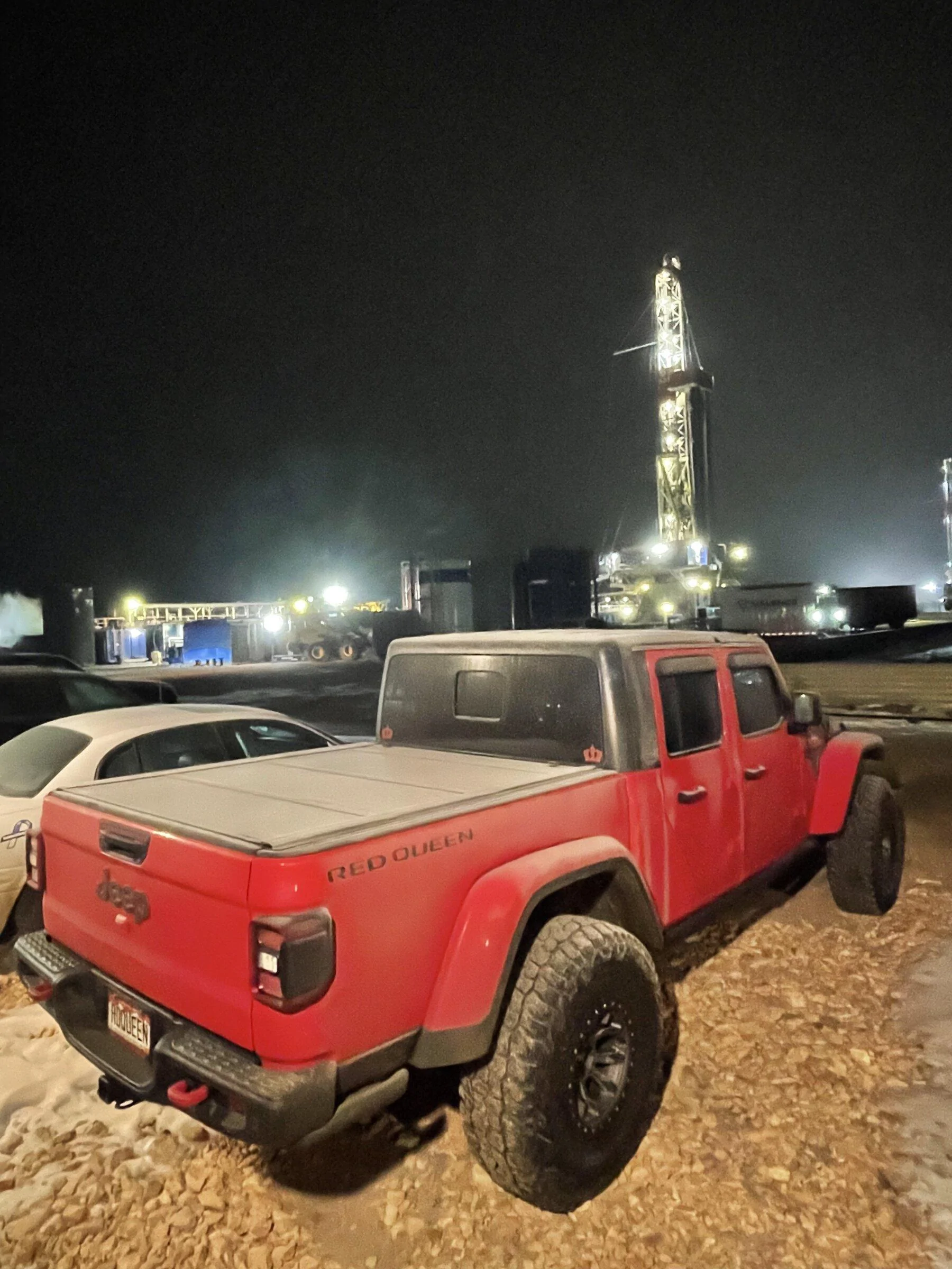

If you want the least amount of poke and less crap on your vehicle while driving on normal roads do the 0. Personally I say 17’s are great off road cause you have more tire in between you and rocks but have seen people with 20’s do just fine. The -18 offset is gonna make them stick out… I have -12 and they are more than a inch out and yes … I have rock chips everywhere. And… I don’t have issues on trails due to how wide the vehicle plus tires is.
As for lug nuts, yes gorillas are great but one thing to know is not to loose your key… it’s a nightmare to get another. I have basic spline nuts and they do fine… also… if the rims have a cap, you will have to maybe even use open lugs… consult a dealer first to know 100%
Nice... thanks for the info. Looking again at the wheel specs, the wheel with 0 offset is a 6 bolt pattern, so the only option we Jeepers have for this wheel is (17/18/20)x9.5 with -18 offset. Glad to hear your -12 has not been an issue on trails. I am also looking into mud flaps to help with the rock chips.
From your picture that almost looks like more poke than the 2 inches i've heard for this wheel, but it could just be the angle?
I am using @Bulldog10 and @kbros builds for inspiration, I don't know how to tag here, but hopefully quoting will do it. 2" seems like a lot of poke... but I LOVE the wheels. I'm just a little concerned about getting into a situation where, if I was just a couple inches narrower, I could have cleared the obstacle.
