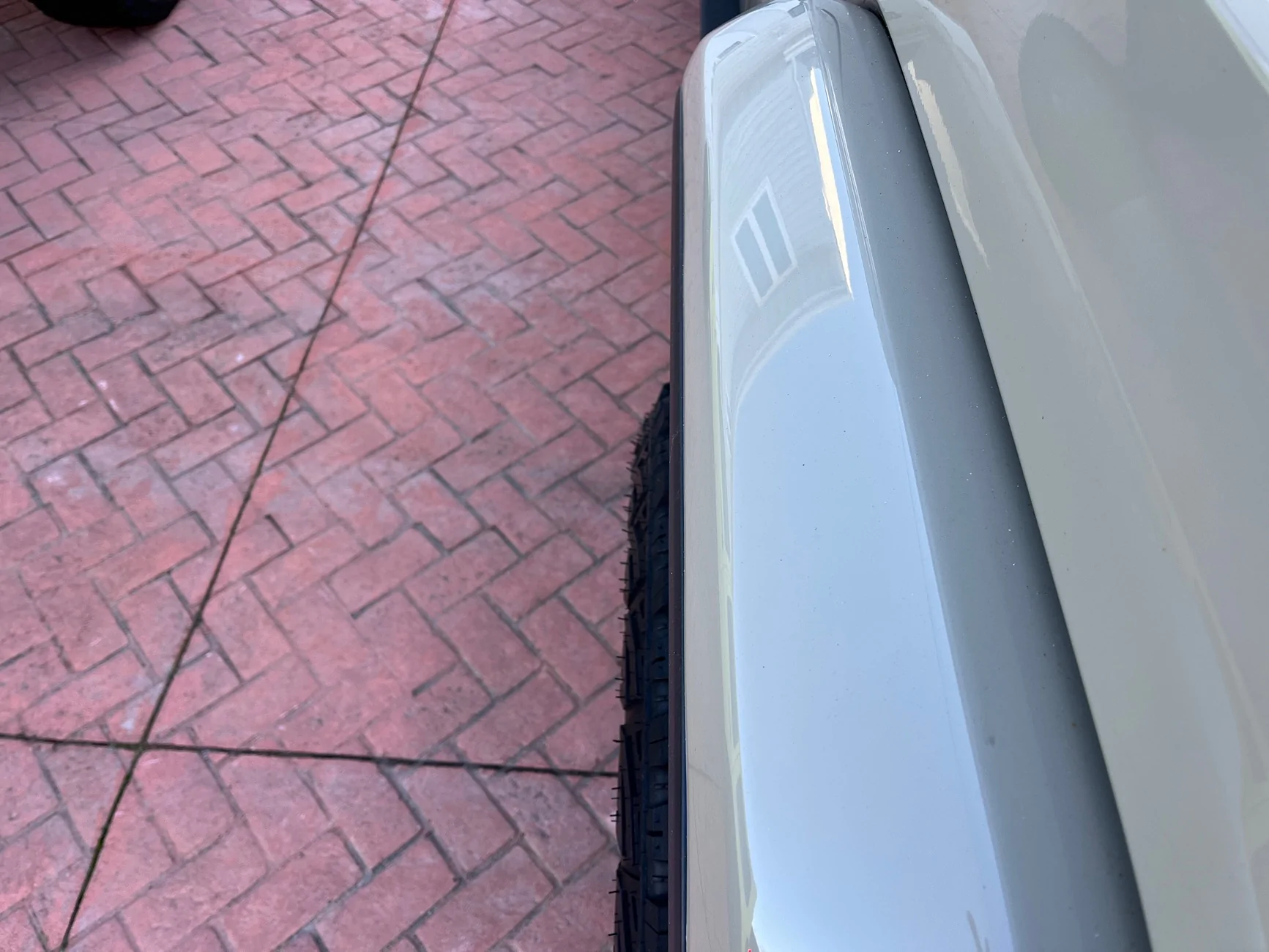

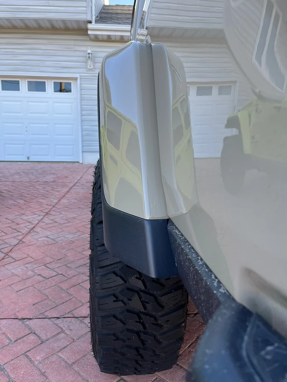

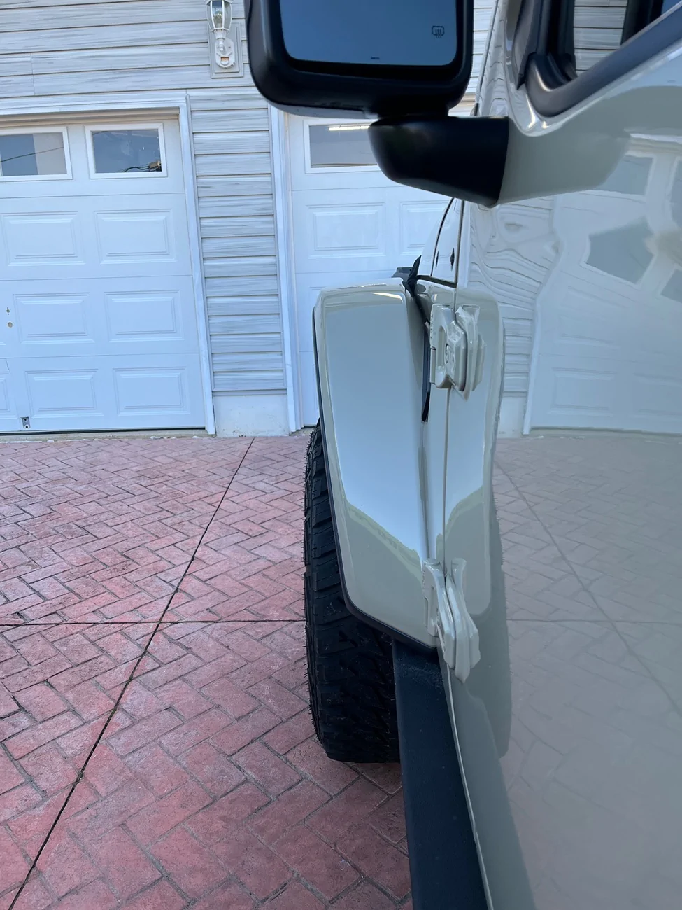

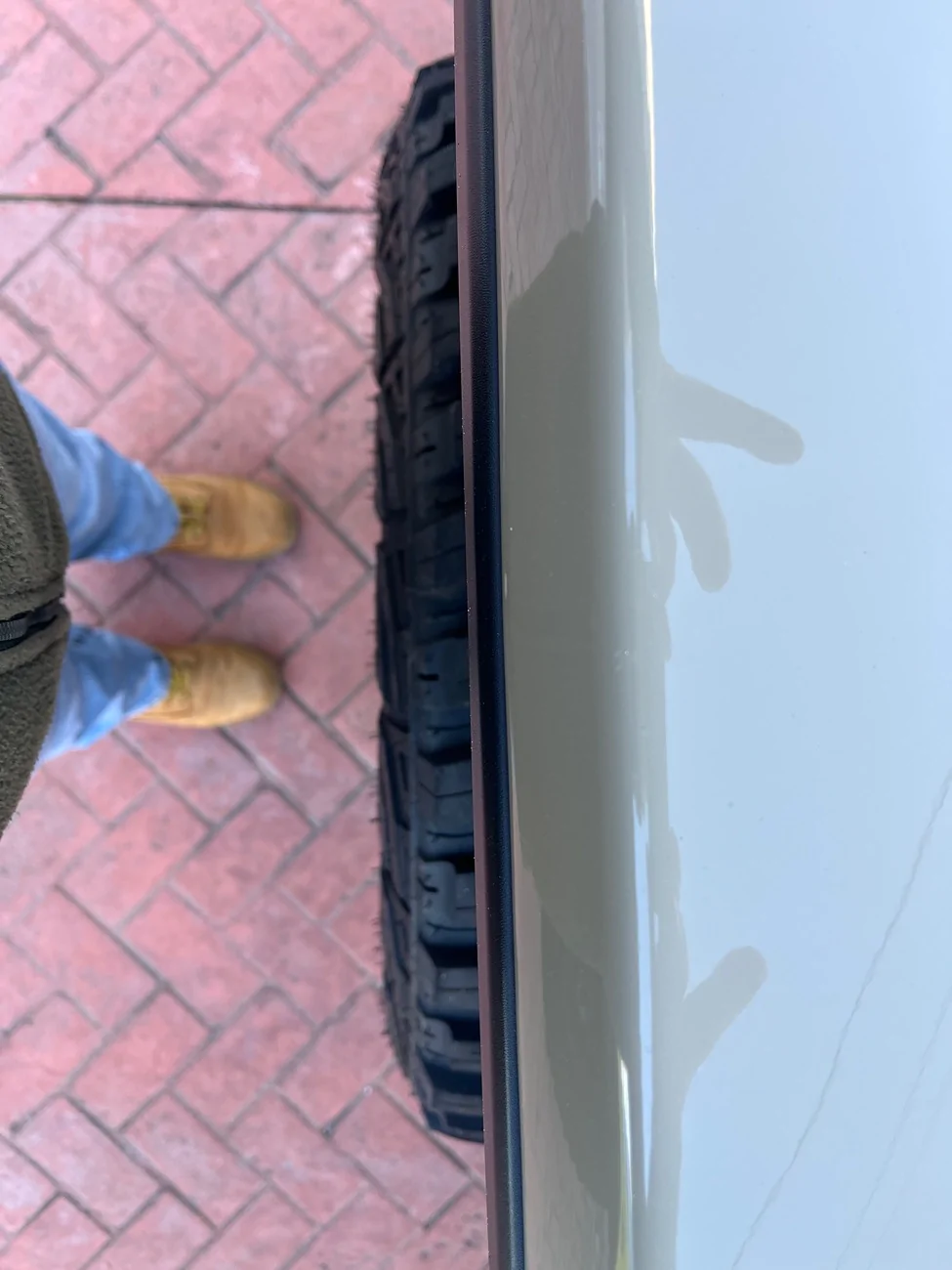

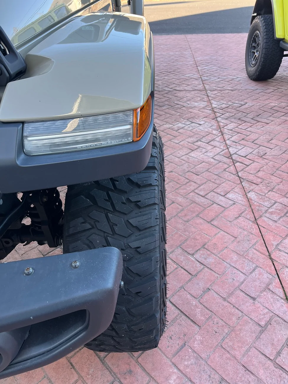

Give me a few minutes and I will take some pictures of mine showing how far they stick out…

When I measured these with a straight edge, they were 1.25” past my fenders.

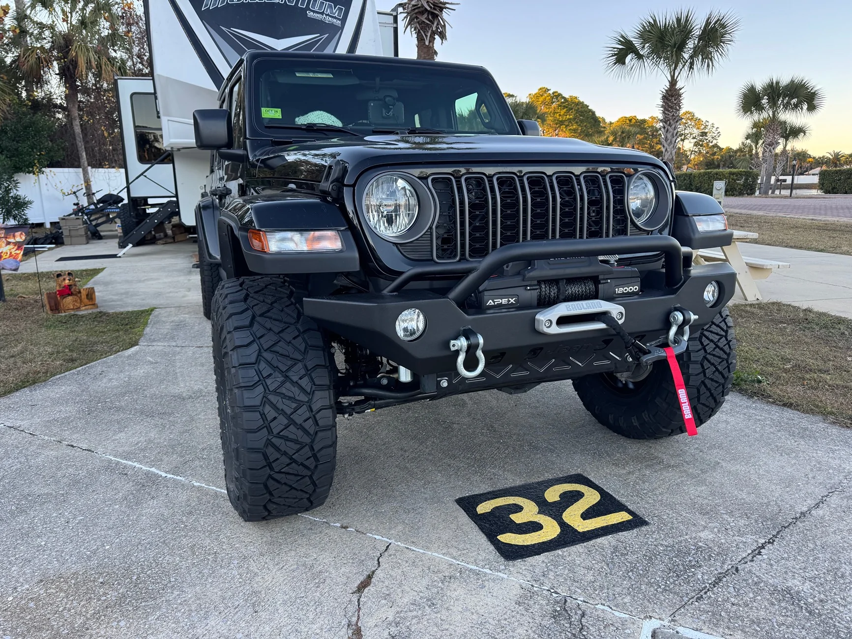

17x8.5 zero offset so 10mm in from here
