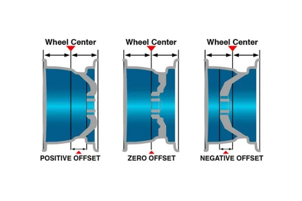

Draw a line through the center of the wheel. That's 0 offset. +10mm moves the entire wheel inward 10mm. -10 would move it out.
What you need to keep in mind is if you're going to wider wheels and wider tires then that needs to be factored into the calculation to see the true difference in clearance change to the inside and poke to the outside. You can find the measurement for your stock wheels on this forum and other places. Between the two you can accurately visualize any wheel/tire size and offset change.
Jeep Gladiator Offset Question - what’s +10mm mean 1780164531088-u

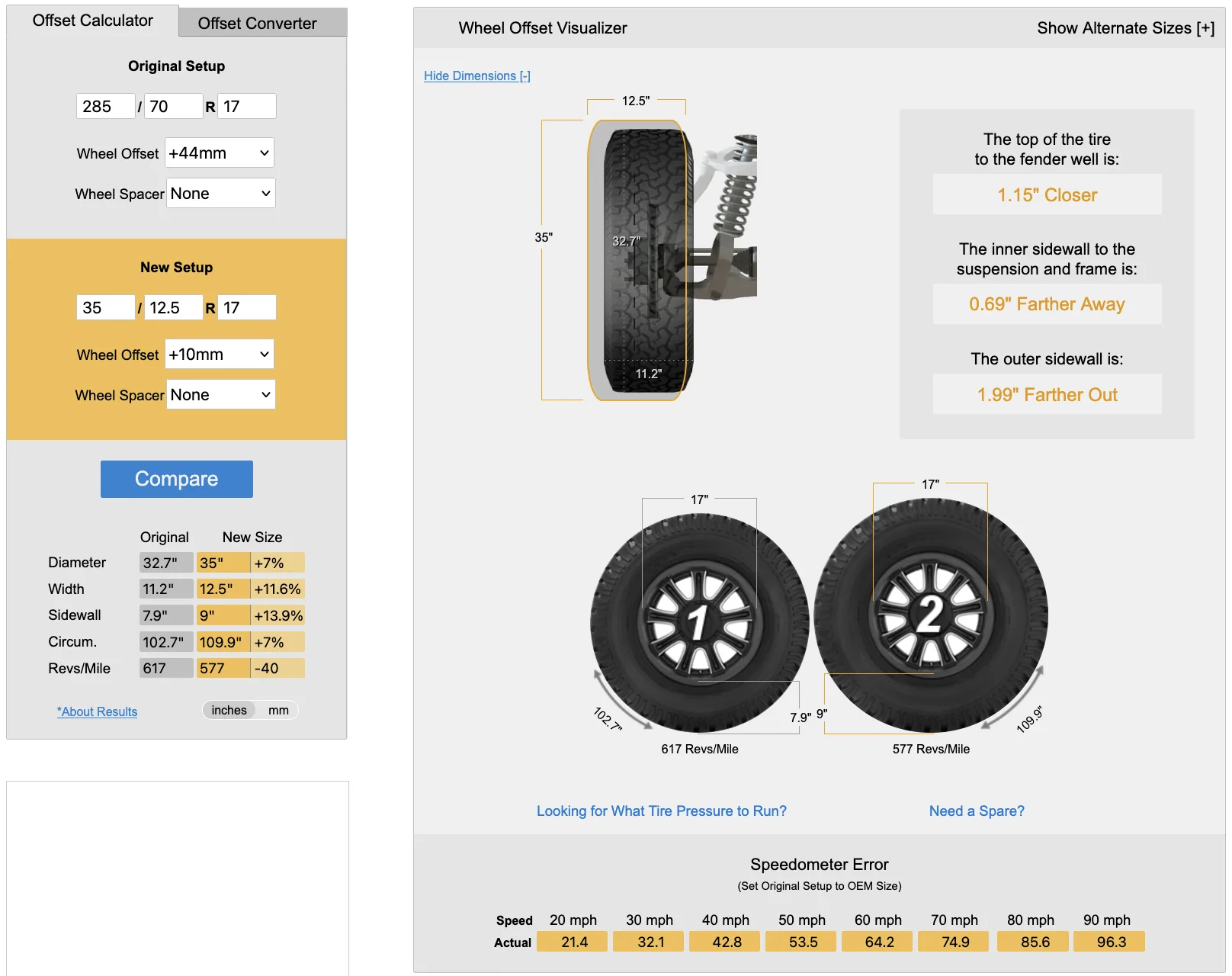

This page may be helpful.
Plugging in your stock tire size / wheel offset and what was given as the new tire size and wheel offset yields:
Jeep Gladiator Offset Question - what’s +10mm mean Screenshot 2026-05-30 at 3.42.11 PM

The graphic is great!

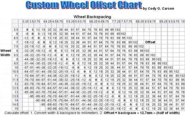

fyi
Jeep Gladiator Offset Question - what’s +10mm mean Offset%20backspace%20chart

Thanks all for the information. That page was clutch! Thanks for posting that. Unfortunately i had to pass on the wheels that were posted on market place. A great price, but the tires on them were "new" with a DOT code of 2013.
