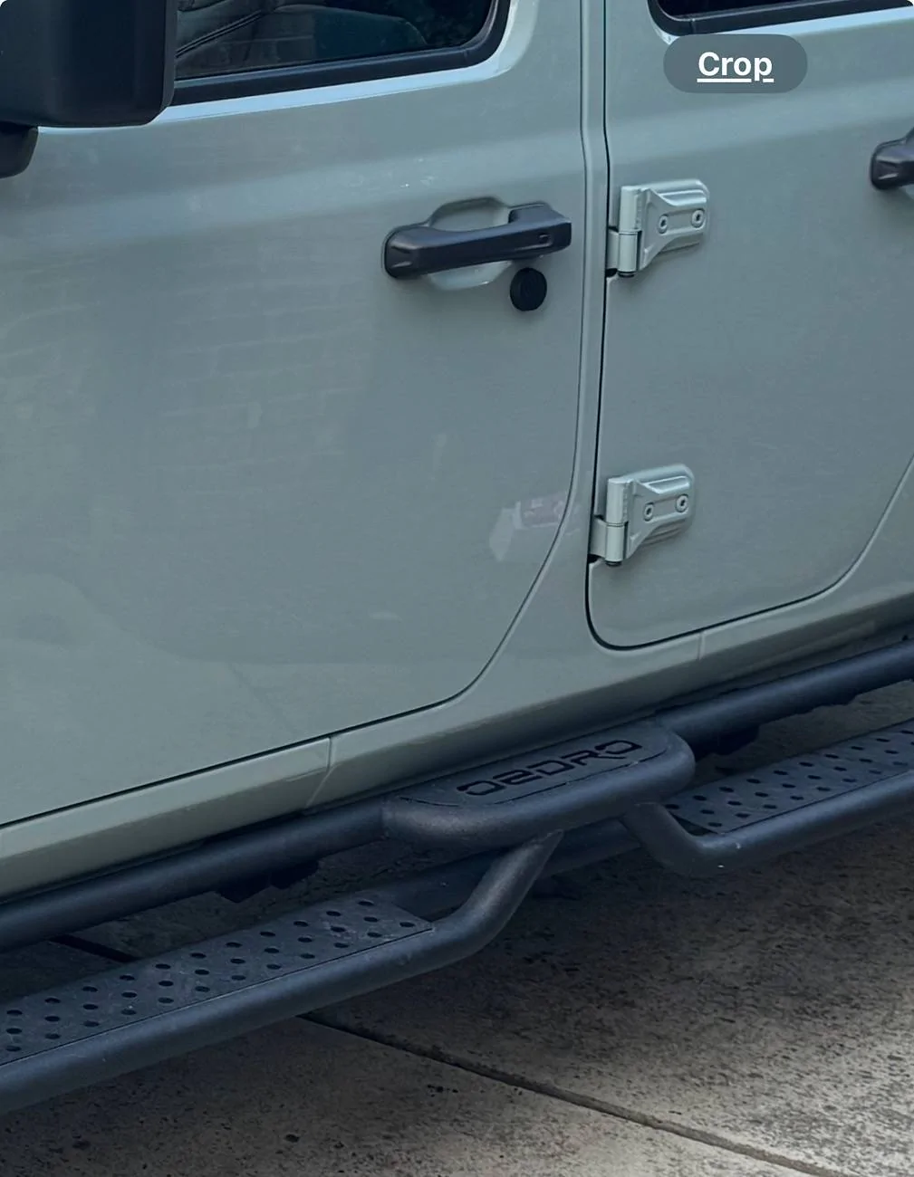

I bought used and it had after market OEDRO two stair running boards. I’ll have to check when I get home, but I think you’re right though this one uses 4x bolts to attach.
I think I found the answer if I do need them:
M8-1.25 x 30mm
My current rail.
