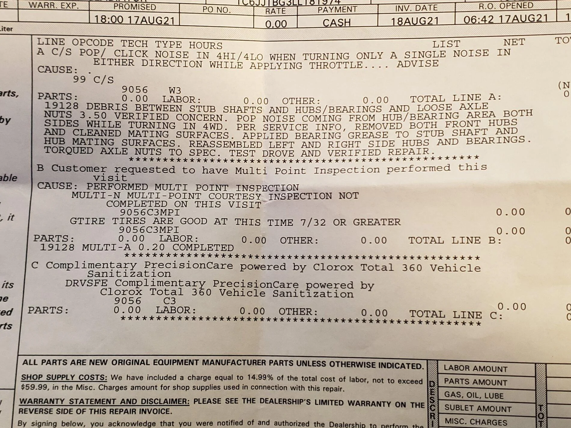

I'm having a similar issue. I tightened the ball joints but that didn't fix it. My issue is only in 4wd.

I just took mine in as well, I'll be sure to share what they find.

Went and picked up the truck today and the popping/click noise I experienced is gone. Verified myself before I left in a patch of gravel I found. The description on the top is verbatim what I wrote on the night time drop off form.
Jeep Gladiator Brand New 2021 Gladiator Rubicon | Makes loud clicking noise on incline/decline/turns 20210818_201628
