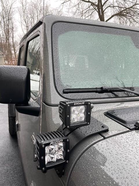

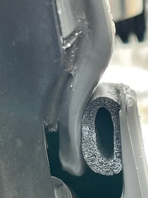

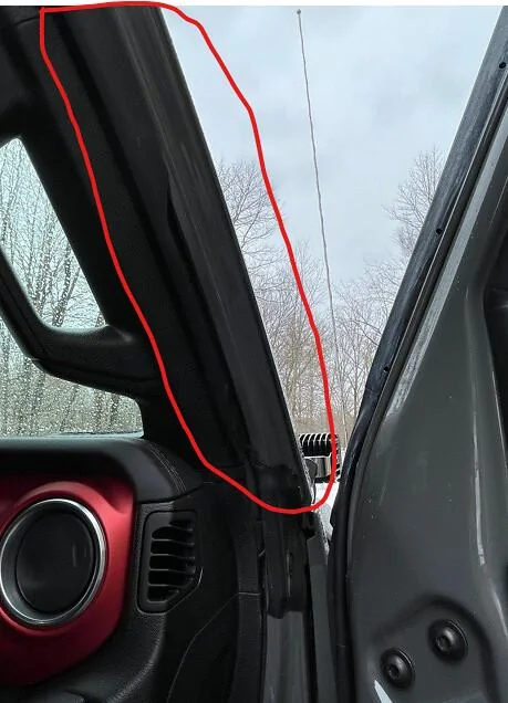

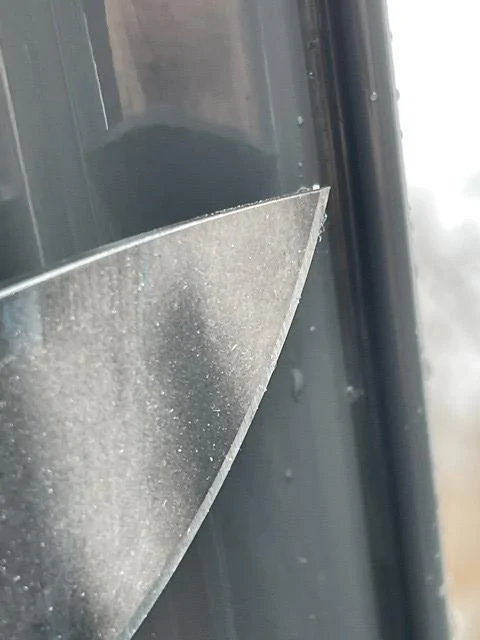

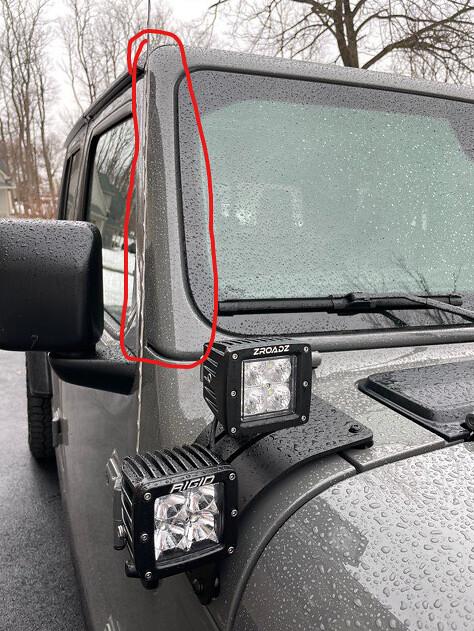

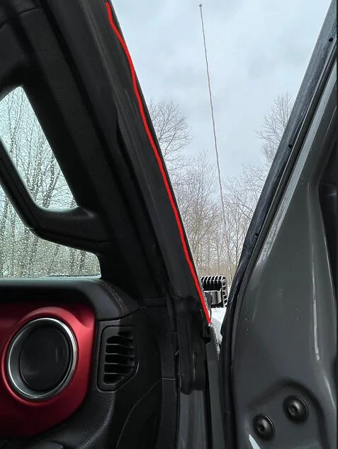

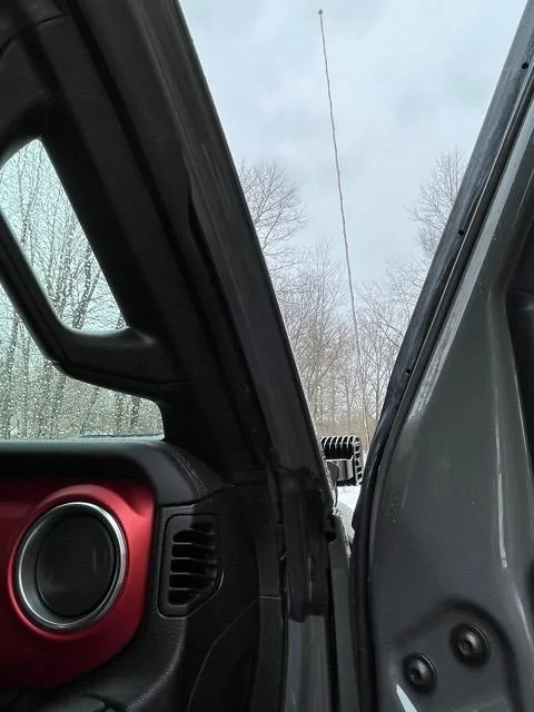

So here are the pics. Most of the pics just show the different sides of the A Pillar (The long red line shows the seam where you can see the sealant and in the last pic the point of the knife is a close up of the seam that is pretty much the only visible location of the sealant they put in. The way it was explained to me was that the cavity was not filled adequately with insulation from the factory and the air entered through the hood area. Once the cavity was filled the noise went away. I hope this helps.

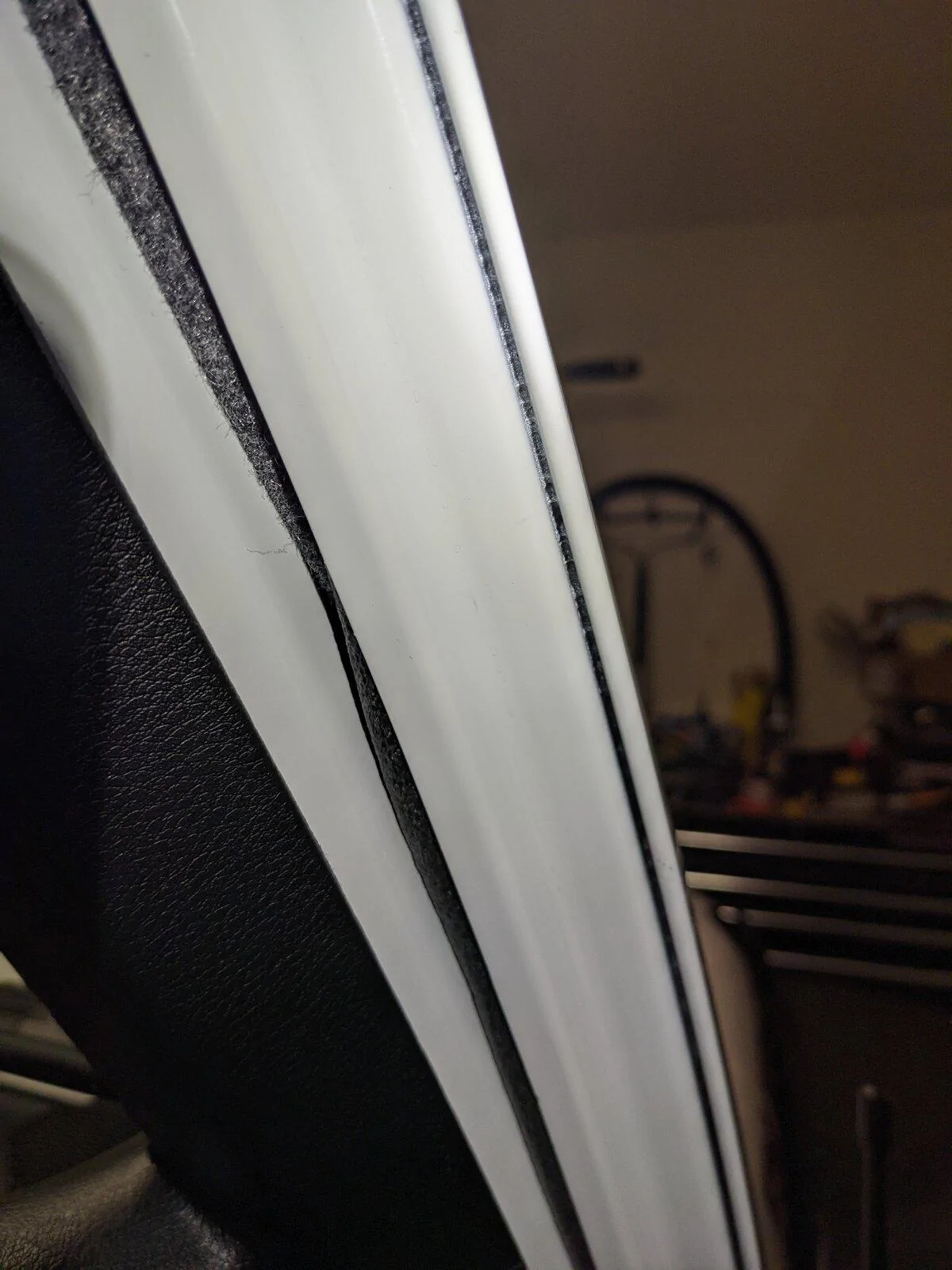

Thanks!
I have backer rod and felt weather seal in that same area because of this same problem.
