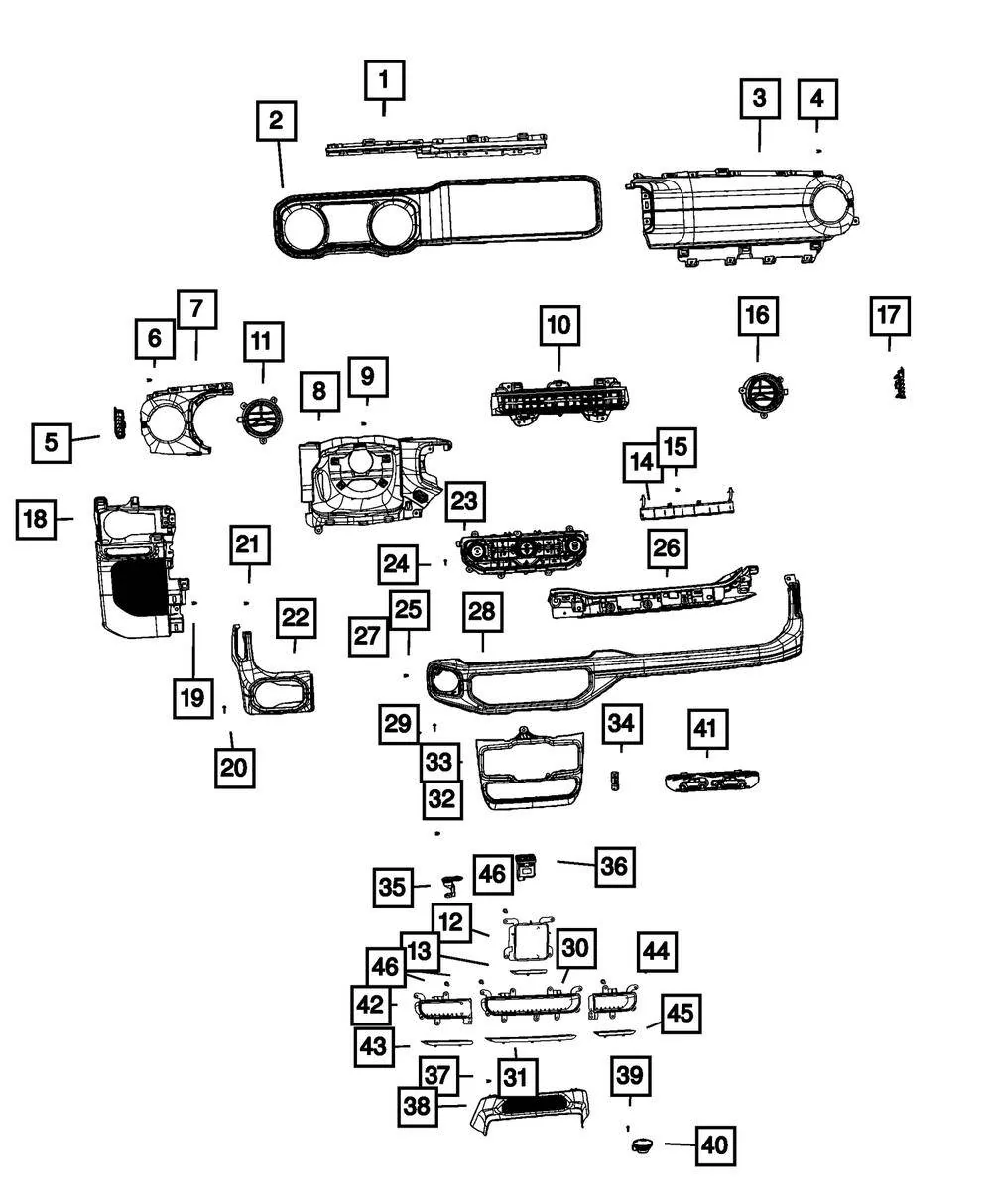

Has anyone figure out how to get it to, looks like they made this thing basically impossible to access, Looks like its part 8 on this Diagram but that is the entire gap fabric thing. You can see the vent on the side of it and its also clearly held in by the long dash trim that includes the dash handle (Part 28). One would think that they got tired of people working on their own stuff....

Ok so I got the sensor installed, but let me tell you its not easy.
Basically you need to follow the steps to install a 3rd party remote start by taking the grab handle cover off, ICS, , Under the KIN (pushstart button) is a screw, and under the drivers kick panel there is a screw, both have to be removed, then its held in with 4 clips but also the fabric so unless you doing a complete removal you can kinda get it in place and get a screw in, the other screw is basically impossible without removing the radio and or duct work thanks to that screen bezel being part of the instrumentation panel bezel. But it will stay with one screw.
