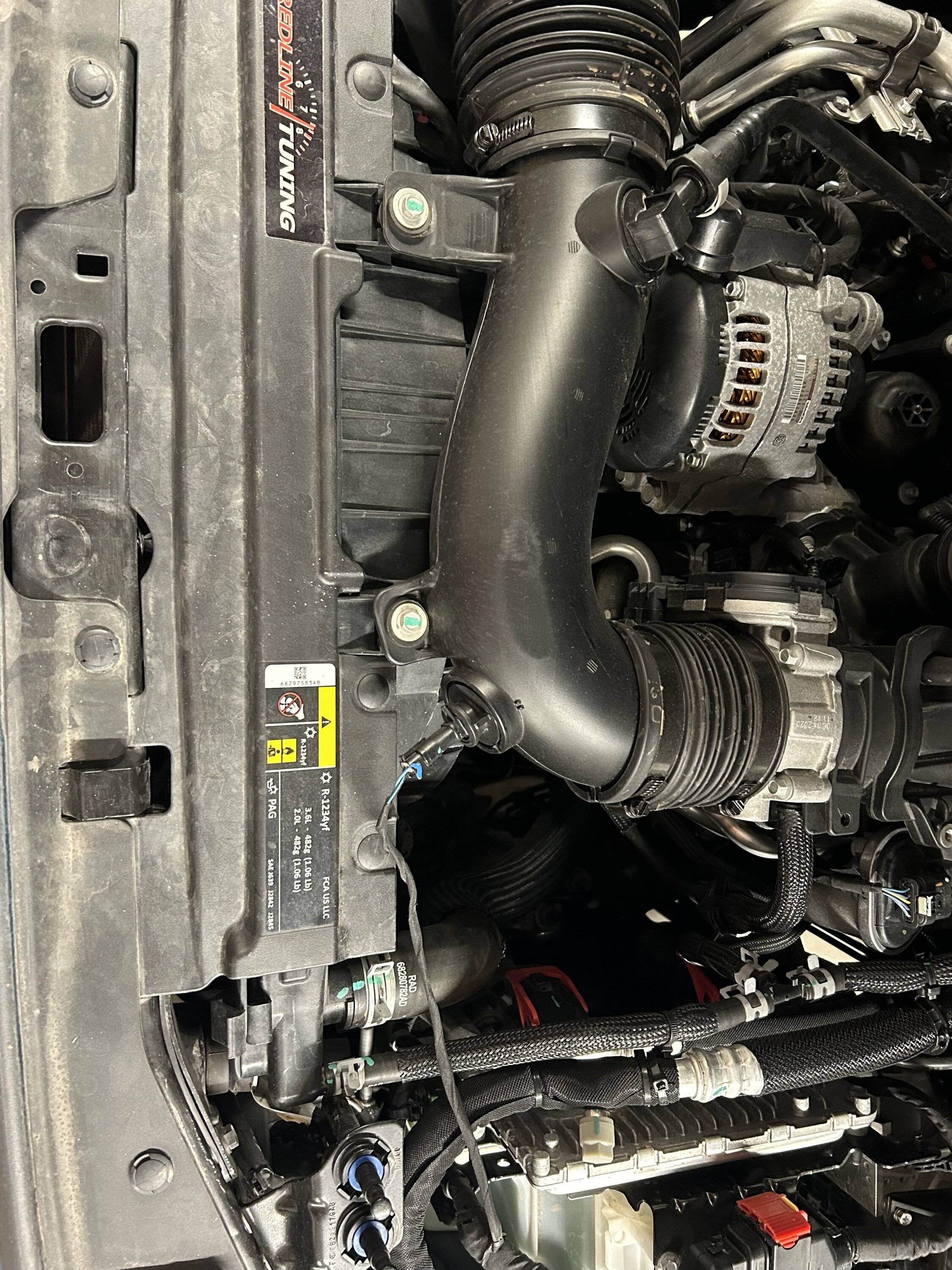

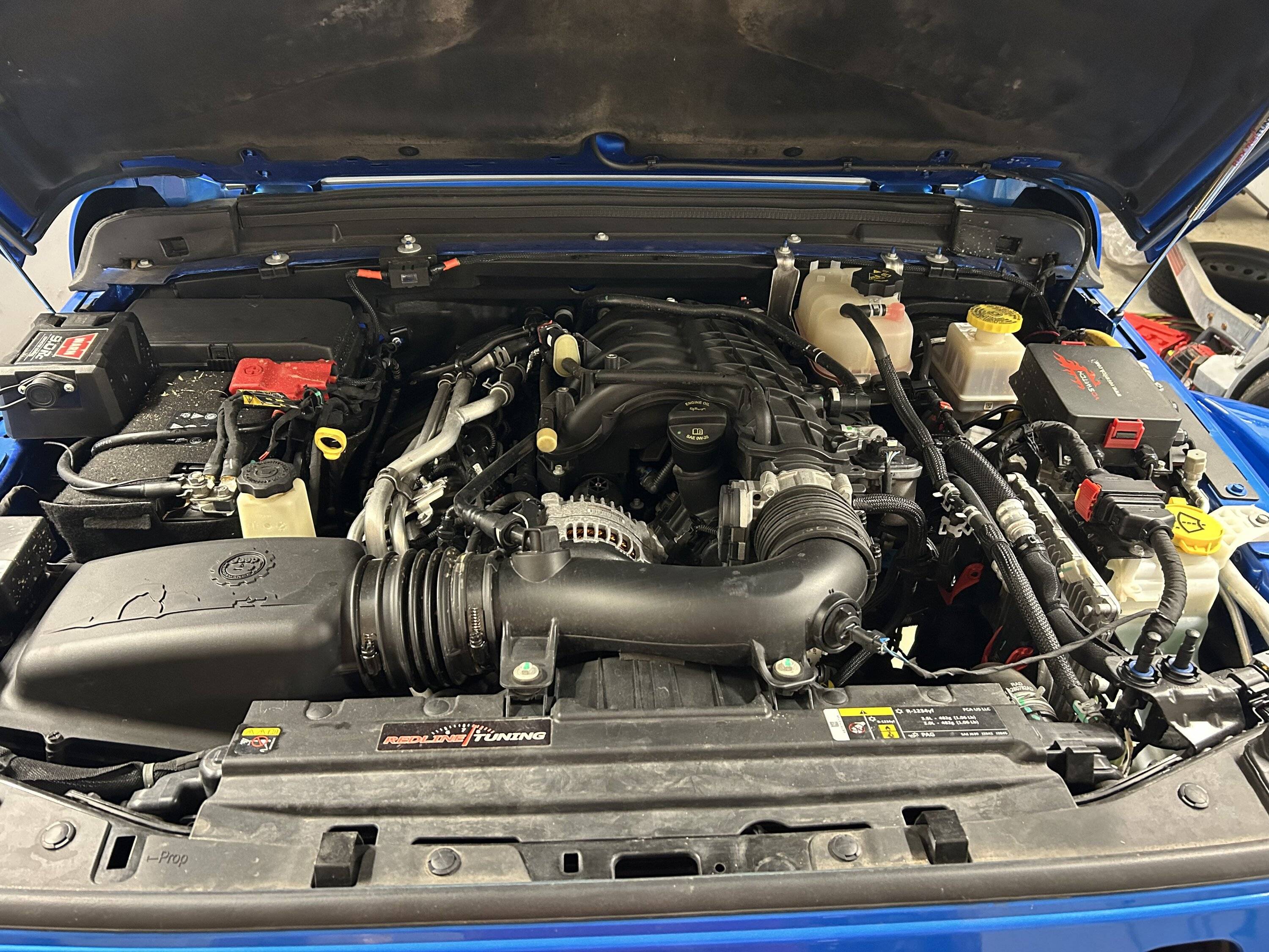

that’s sort of why I just want a tube. Get that slight growl. I may just see if a local shop can mandrel bend me a tube and I will re- use the stock rubber boots. Paint the tube black and call it good.
