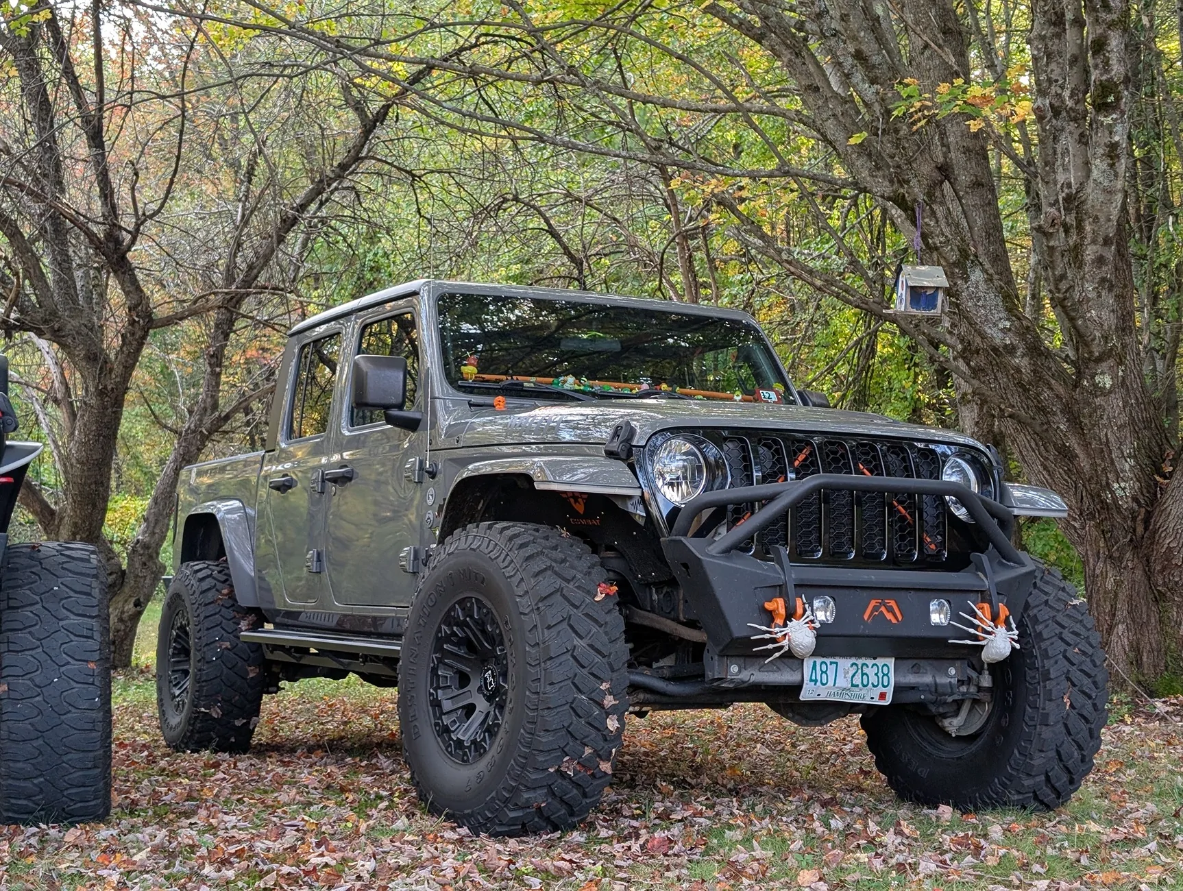

I'm running the superchips flashcal +. I tried procal snap and it was horrible. Returned that after multiple failed pairing attempts and tried the flashcal. It has been great, you can set the tire size manually or have GPS do it for you. It uses an app for the settings instead of trying to navigate through the radio. When I switched from 34's to 37's I immediately noticed shift point issues, and annoying speedometer miscalculation. The flashcal fixed all that and more. I really like the start/stop and TCS memory. Surprisingly I enjoy the rear camera activation with blinkers also. Never tried a tazer but when my "basic" radio struggled with the procal snap I wanted something that did not rely on the radio. The superchips flashcal + seemed to be the best option. I doubt I'll be keep the Mopar radio forever anyway. Good luck! Pic because I have an unhealthy addiction to my jeep. :)
Jeep Gladiator Milage not what I expected PXL_20250927_204836935
Thanks for the feedback, rig looks great with the 37s I'm going with 36s and just ordered a 2.5 lift , going to stay with the 4:10s for now and get a feel for it. We both be ave the same color too
