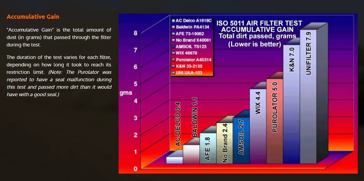

Your air filter isn't helping you either, Those K&N filters are crap.
Put better oil with a better film strength in - the stock Pennzoil oil or Mobil 1 oil.
Ditch that K&N air filter - if you want proof I've got a handful of charts showing ISO scientific testing as far as how much dirt they let through and how restrictive they get if you don't clean them constantly. Good for racing, where you rebuild engines constantly anyway, not good for an engine if you want 100,000 miles out of it.

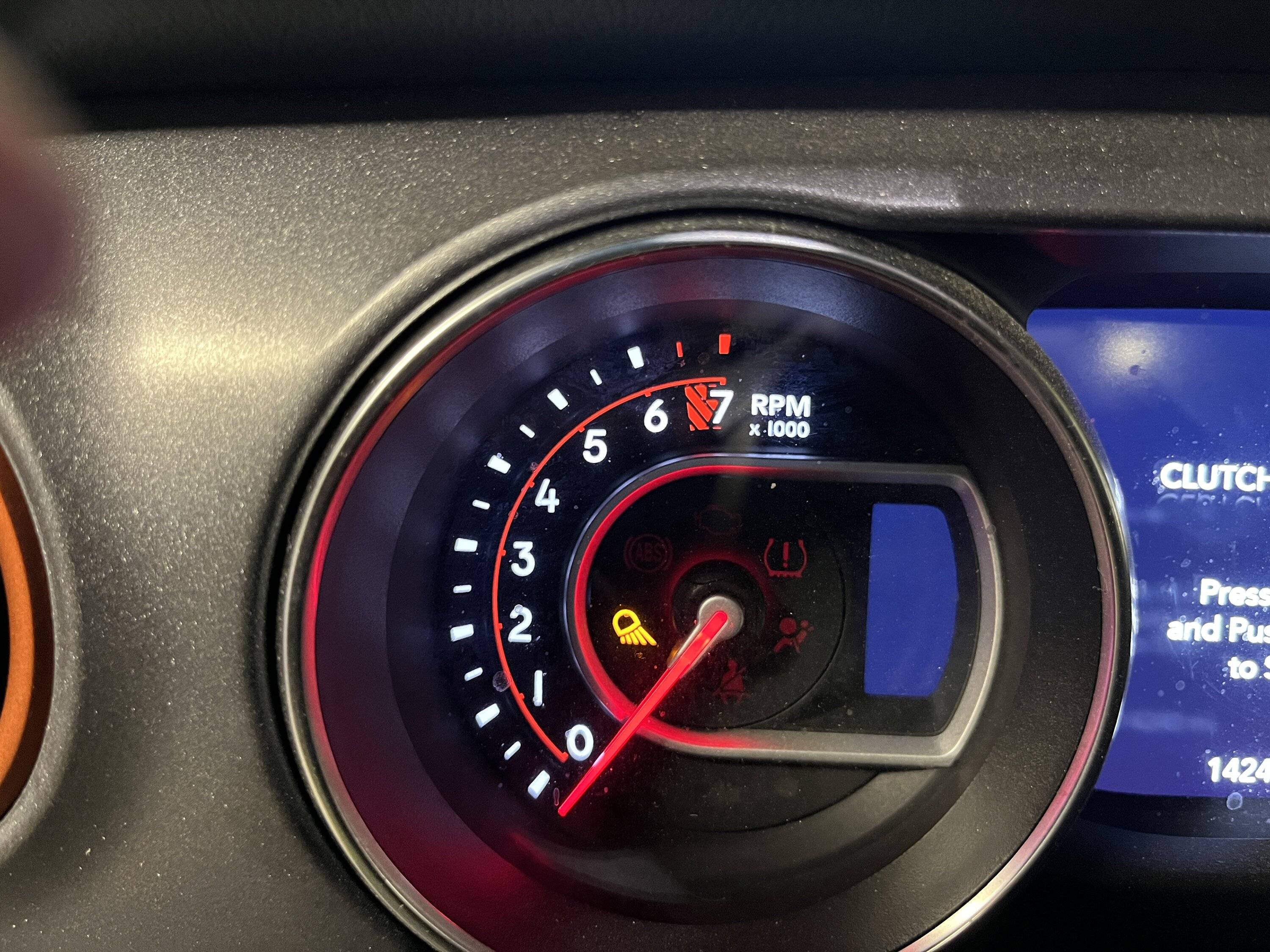

I don't rock crawl, a few easy trails a couple of times a year to go fishing or launch kayaks. Cruise just below 18,000 RPMs, shifting around 22,000 RPMs. I do all my own maintenance, it's only been in the shop for tires, so it's not like a tech is lieing about work done.
Umm, my math for Marines tells me that 2 x 1000 = 2,000 not 20,000 RPMs. ;)

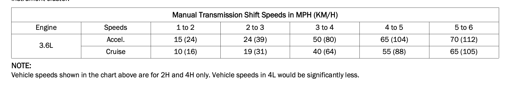

Personally, I think you're cruising and shifting at too low an RPM for this high revving truck.
Like you, I have the manual transmission. When cruising I prefer to stay in the low end of power band at about 2,500 RPMs for a better response between gas mileage and a need to accelerate because of the distracted idiots out there on the road.
I don't shift until at least 3,000 RPMs when I shift accelerating slowly.
Here in Missouri, the speed limit signs on the highways are 65 MPH around me but most on the road are doing a good 10 MPH over that. So getting on the highway I'm usually not shifting until 3,500 RPM or higher.
Remember that the shift tables in the owners manual are specifically designed only for the very best MPG due to the Corporate Average Fuel Economy [CAFE] requirements for the manufacturers. They have no basis at all in real world driving.

If you really are shifting at 2200 RPM and cruising at 1800 RPM you would have obvious lugging on any carb fueled engine with a RPM redline at 6,500 RPMs.
The fuel injection prevents the shuddering effect but the very simple test that you're still lugging the engine by being in a higher gear than you should is that you have pretty much zero acceleration without downshifting first when you press the accelerator. If you're doing this you are increasing the heat of the pistons and cylinder walls and it will ultimately cause engine issues.
That said I don't know that it would affect the cam and rocker arms.

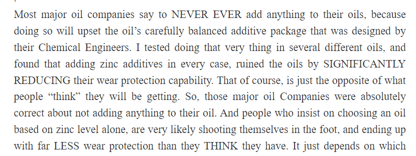

For any late model motor it is important to use a motor oil that has very high wear protection. Not the oil you chose.
Here is a link to spend hours on the subject of wear protection. Pretty reliable source for actual testing that is continuously updated
https://540ratblog.wordpress.com/
