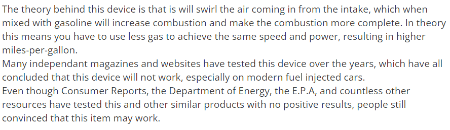

https://www.performancechipguide.com/spitfire-tuning-performance-chip-review-teardown/
As far as sticking something into your intake tube ->
Jeep Gladiator Lower MPG than expected. Anyone else? Screenshot 2024-08-23 223223
I could go into great detail about the whys and why nots............ but won't unless asked.
