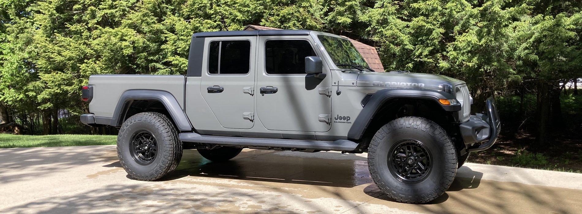

37" Cooper Discoverer AT3 XLT tires with 17x9 Fuel Off-Road Nitro 5 wheels. That combo weighs just about the same as the 285/75's with XD wheels I had prior.
Jeep Gladiator Anyone noted the MPG difference between stock tires/wheels combo and 35" and 37" combo? 0A4D6D73-0C28-465E-BFE1-AB161D3770BF_1_201_a

I actually have a lake house in the UP of Michigan and a place in New Mexico, so I drive at all different speeds and elevations depending on the state I'm going through. The picture you see here is not a highway, but a back road in the UP of Michigan and the speed limit is 55.
