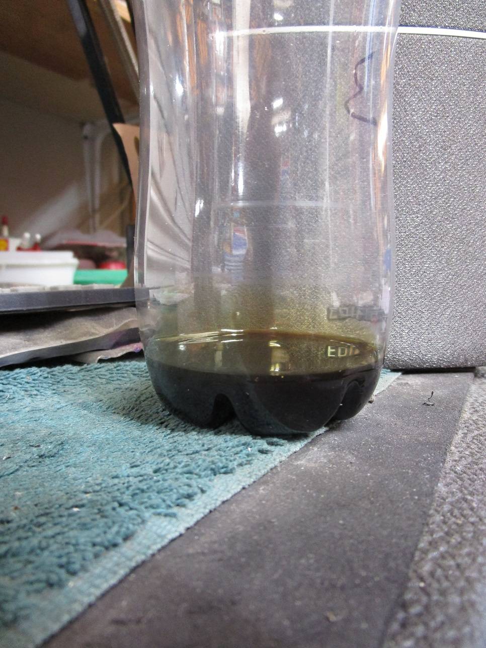

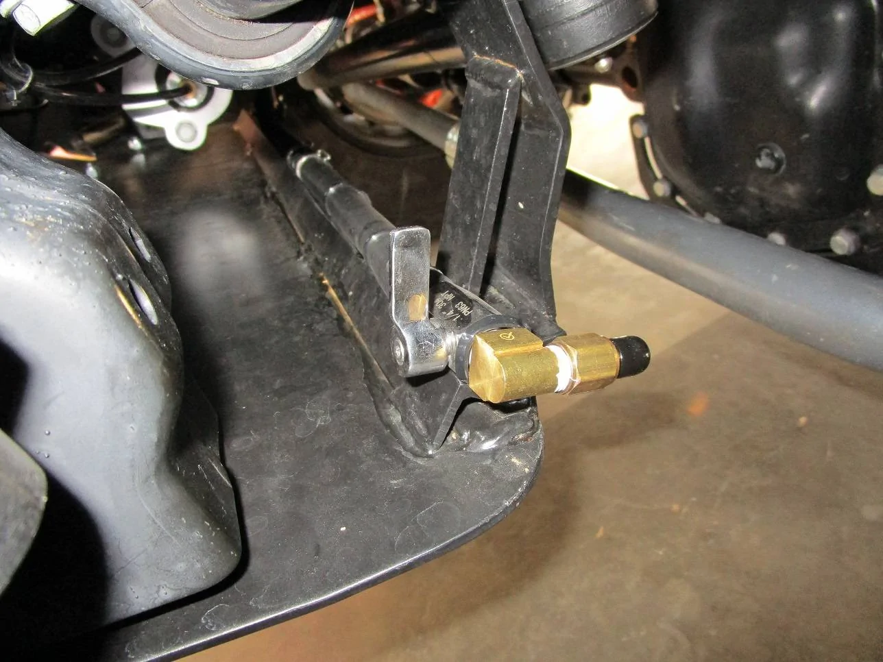

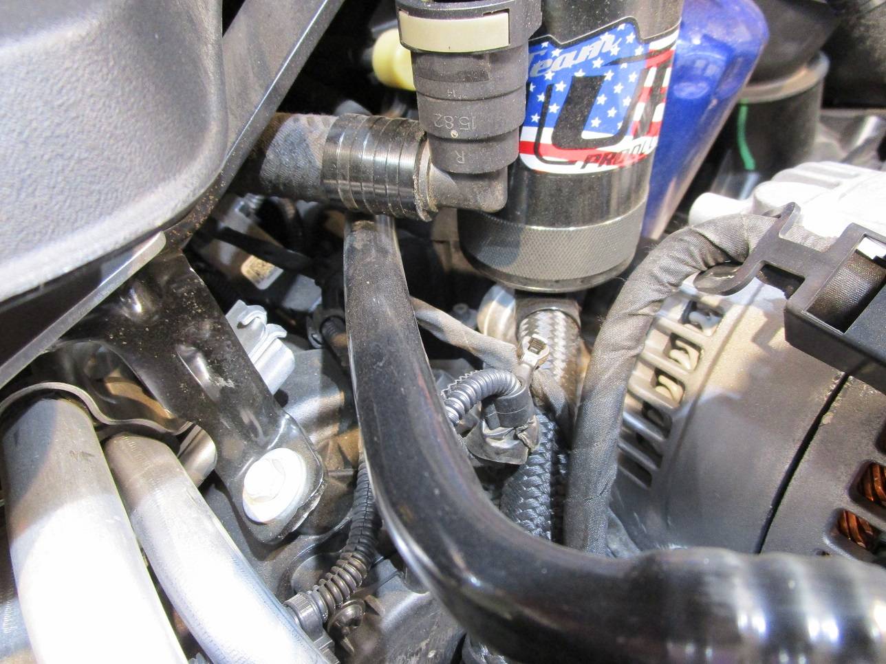

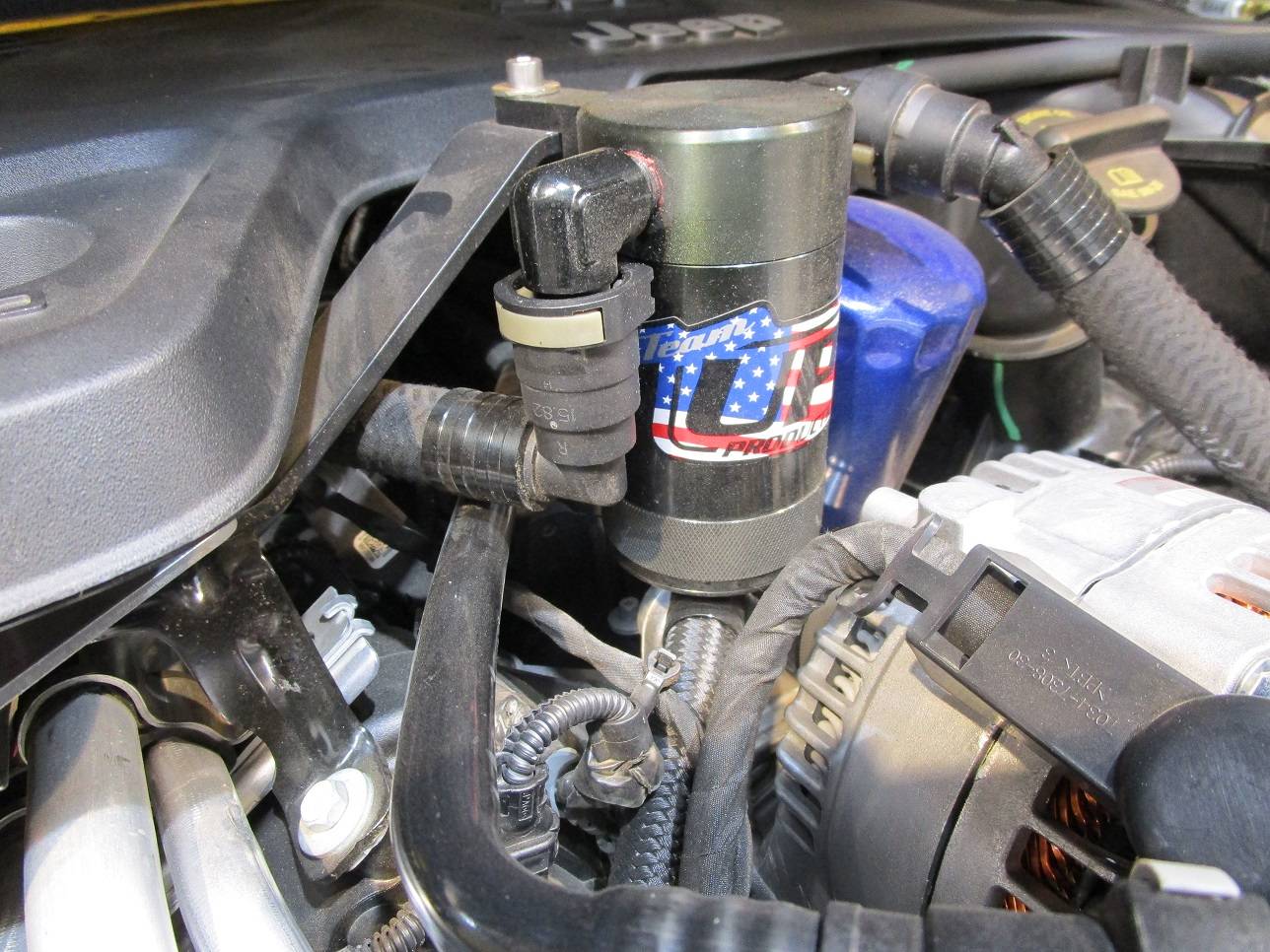

Had the same problem on my 3.6. and like you said it is loud.
The first time I heard it was pulling a off road hill in 4L at altitude with 91 octane.
I could not believe what I was hearing considering the altitude with 91 octane.
After some research I had read that the blow-by from the PCV system can and will contaminate the intake air stream and lower the octane levels. I was skeptical to say the least.
I also read that installing an oil catch can will remove the oil mist and clean up the air stream. I Installed a UPR oil catch can and after install ALL detonation is gone. NOT one ping. Gone.
The can must be drained often to avoid oil build up in the can.
I raised the can and added a 4ft 1/2in. drain hose with a ball valve keeping all the oil out of the can and in the drain hose.
