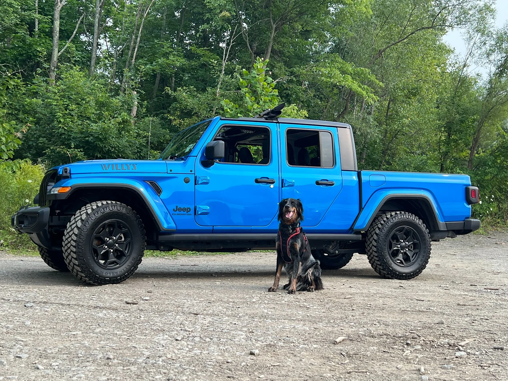

Oh and say hello to Laser the bestest service doggo!
Jeep Gladiator Dilly's Willy Build/Log IMG_0622[1]

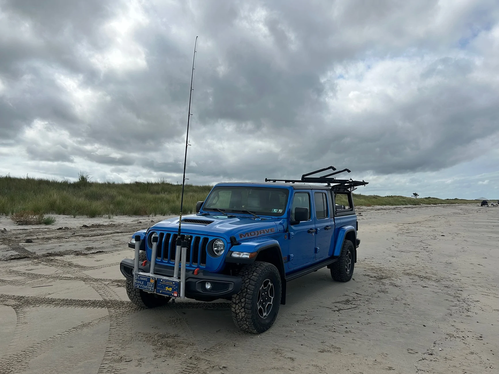

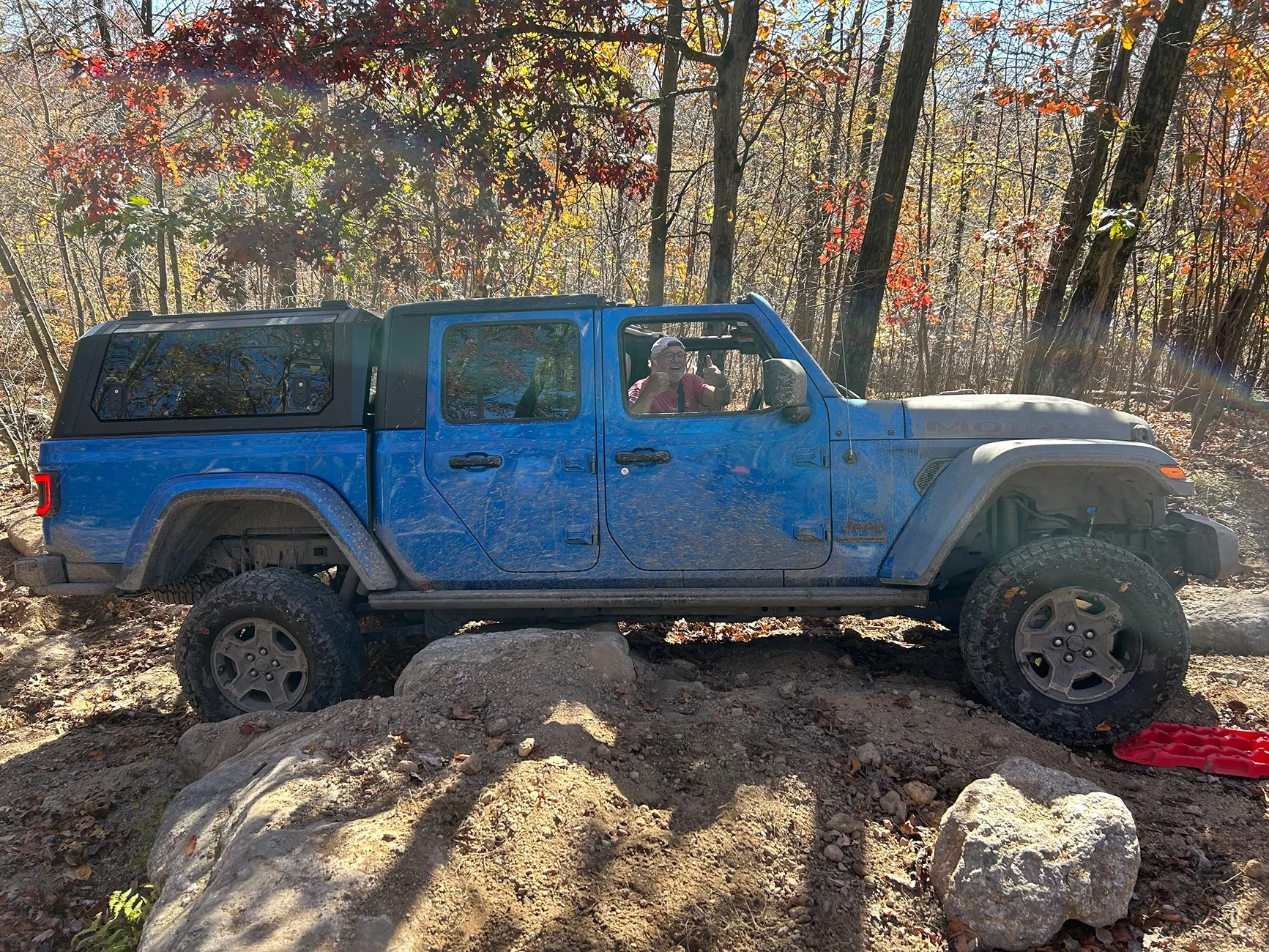

NE USA with deserts?
Jeep Gladiator Dilly's Willy Build/Log IMG_1666
Jeep Gladiator Dilly's Willy Build/Log IMG_2020
Can’t find a desert here in Pa!
Like your plan couple thoughts:
1. Get a set of Mojave take off wheels 3/4” more offset for more room and usually reasonable.
2. Clutch is something a lot of people improve on, towing is limited with a stick a bit. I have an auto though.
3. Apex sway bar disconnects are awesome , no electrical failure points, unlock’em and they are unlocked until you are done not locking back at a certain speed. Disconnected sway bar is a huge thing off-road. Welcome…..Jack

I was in the desert before I came back to the NE.
1. I've considered the Mojave take-off option, but I currently NEED a Willys wheel for 5 tire rotations with the full-size matching spare so I'm not using the steel wheel or paying for 2 mount/dismount every rotation.
- Does the offset really make that much difference with the 255 width tire?
- What the consensus on lower offset with sport axles/wheel bearings long term?
2. I've got the recall clutch fix with around 5k miles when I got the truck, and now has about 10k miles more since I've owned it. Yes the clutch is meh, but it does stay consistent...for now. I MIGHT do an ACT clutch down the road as they don't require mods like the jank CF clutches do. Heck I might even get another SouthBendClutch kit (love them in Subaru builds). Regearing will help immensely with towing, which is also why I'm debating 4.56 vs 4.88, but having 32s on 4.88 is going to be spicy. I'm already running around 7.6 sec 0-60mph on 3.73 and not smoking the clutch.
3. Those are what I've been considering, for starters anyways.
- Can you use them both front and rear or just front?
- WHEN DO YOU NEED LONGER BRAKE LINES? I can't find a good standard for when to do this, other than with lift kits.
Also, what mudflaps are those? I've have Rally Armor on my Subaru and love them. But between the 2-3x cost for Jeep, and almost smaller flaps compared even to my Subaru (rally build), and RB flaps looking cheap af...I'm not sure what to do. For reference, check out Rally Armor's Urethane flaps for Subaru, they don't get hard, super flexible for off-road, and look great.
