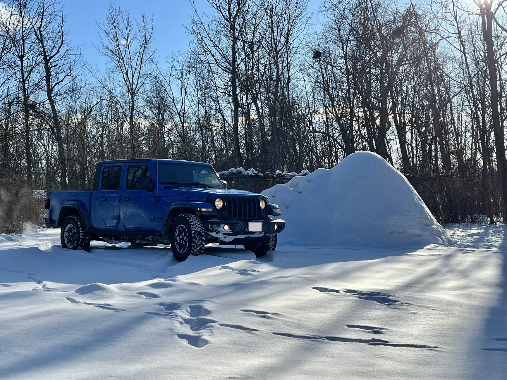

Built a small igloo with a shovel a last weekend, decided to drive the JT through the snow for fun, not remembering the tree buried underneath. Just added more fun to the mix. I have some video but need to edit it, here's a pic until then:
Jeep Gladiator Dilly's Willy Build/Log 5321670e-04bc-430a-a147-49d198e9a5a1
You can sleep two people or one and a large dog with the heater inside, it was about 4* the other day and about 45-50* inside.
