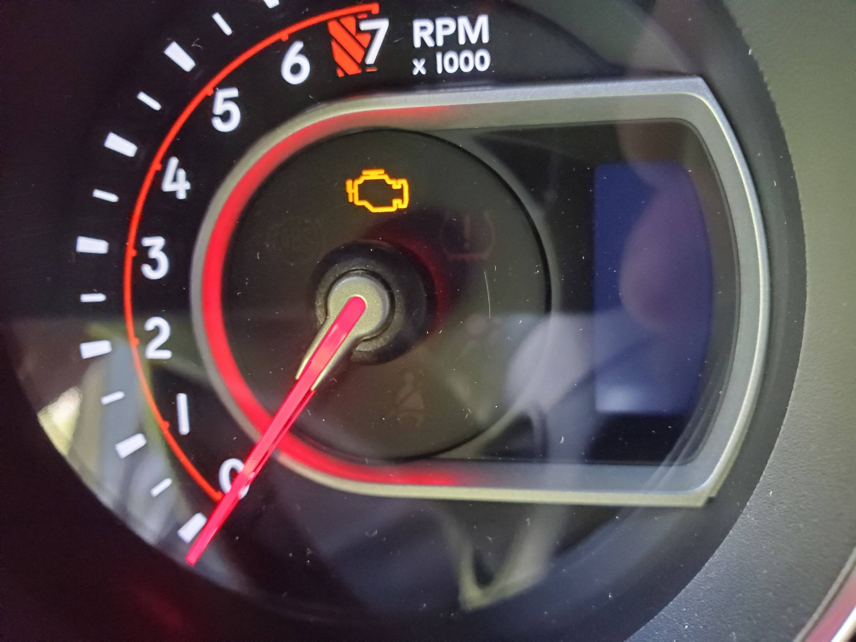

Check engine light comes on when I turn on bed lights????

Took it in today for the cluster replacement. This is the third cluster installed in this jeep. Working as it should so far.

Not sure about all that but my check engine light read as something related to the radio. They said the only way they could order the new part was to have it programed with my current milage at time of order. The jeep has about 700 additional miles. on this replacement. 1500 on the previous replacement.
