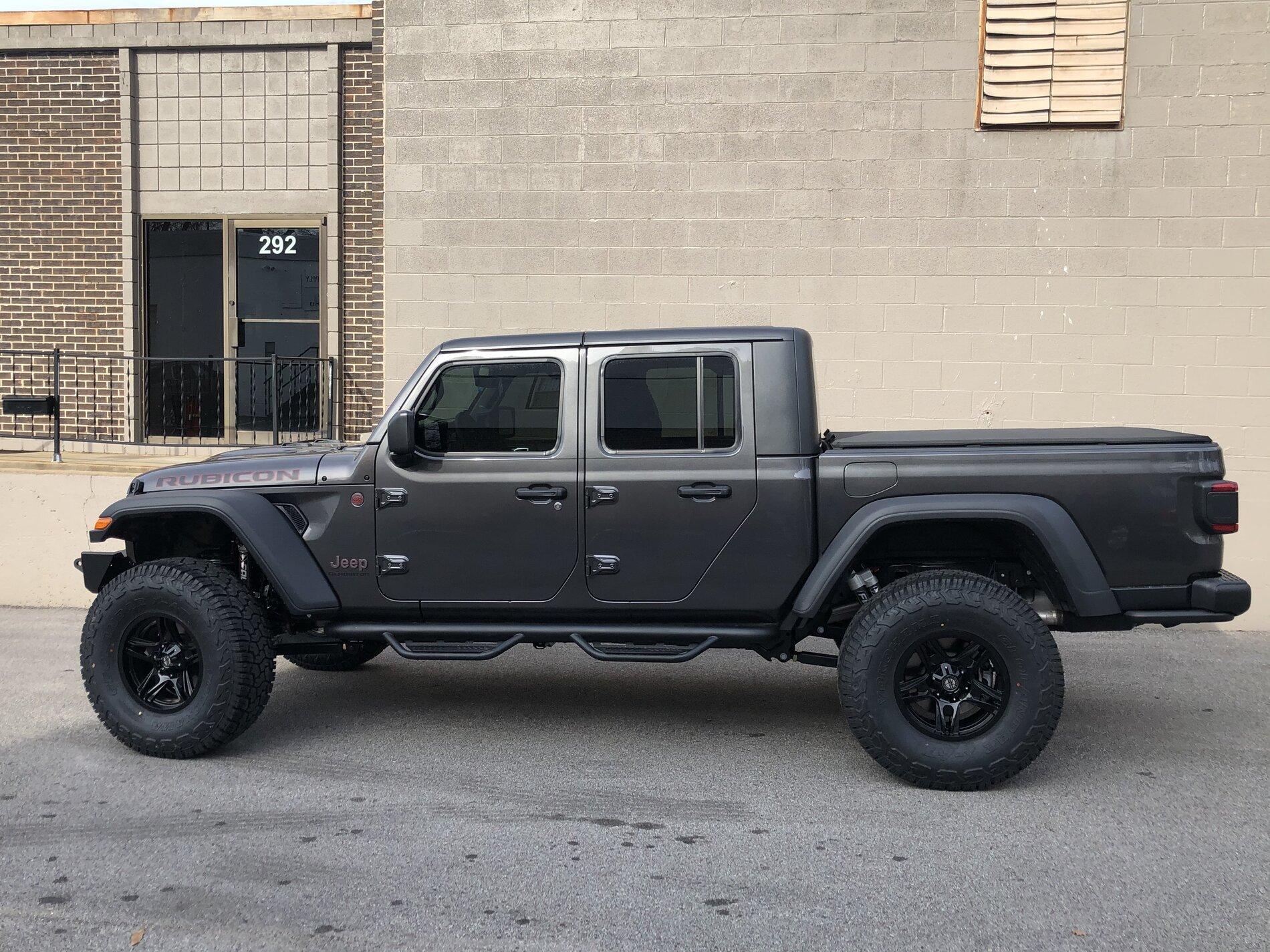

Came out great!! Is this with only the COR 2.5" spring in the rear? You added a spacer in front and it looks to still retain its rake. I know pictures are deceiving but this would fit my needs perfect seeing as I will have the bed rack, decked and RTT.
Yes COR 2.5 springs all around. I gambled with the 0.5 spacer and it’s closer to level but in some cases it appears to have a little rake to it. I’m happy with it. Rides great so far too....just had my alignment done (dealership gotta get theirs too) only minor adjustments needed for castor and toe.

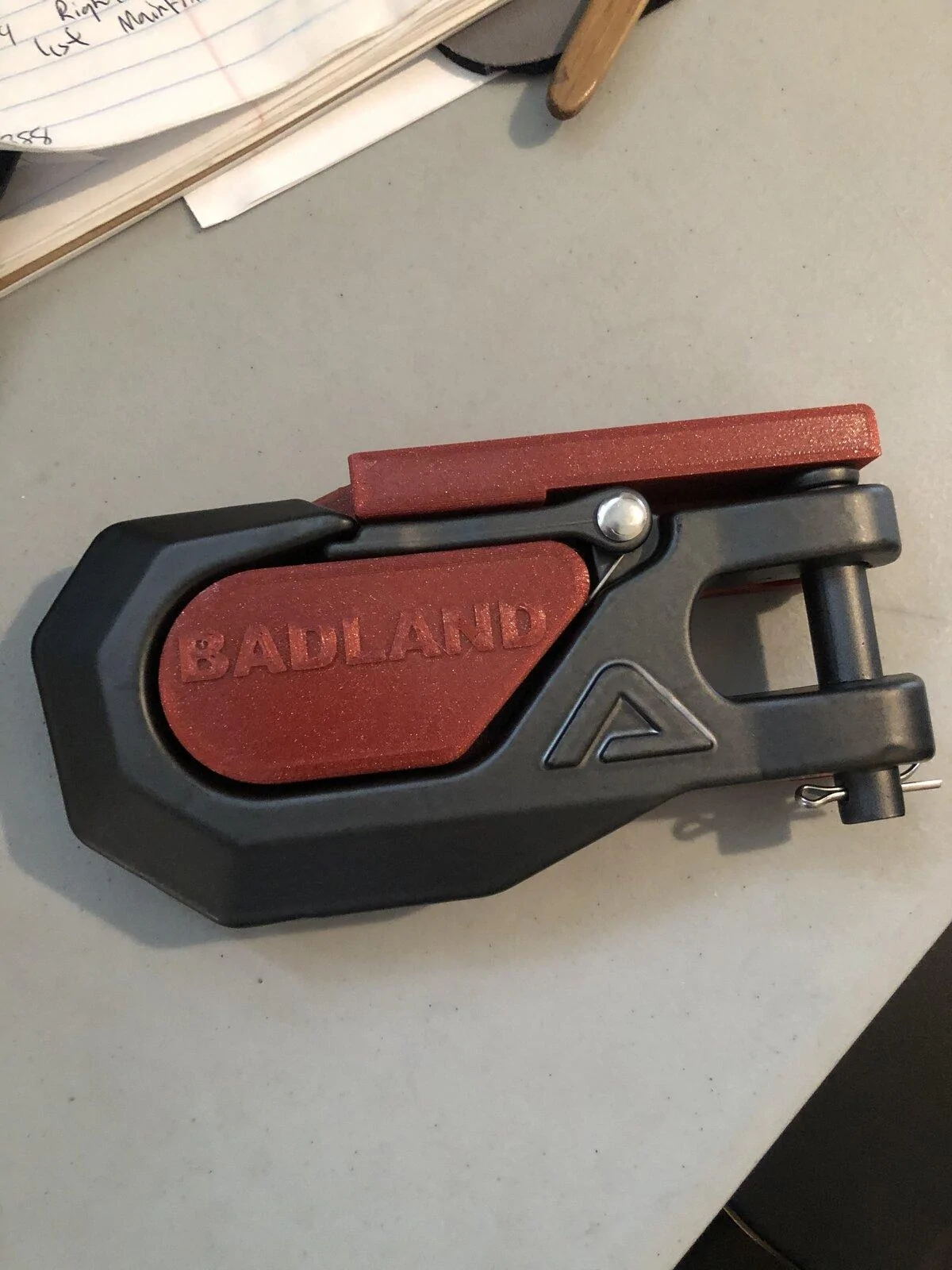

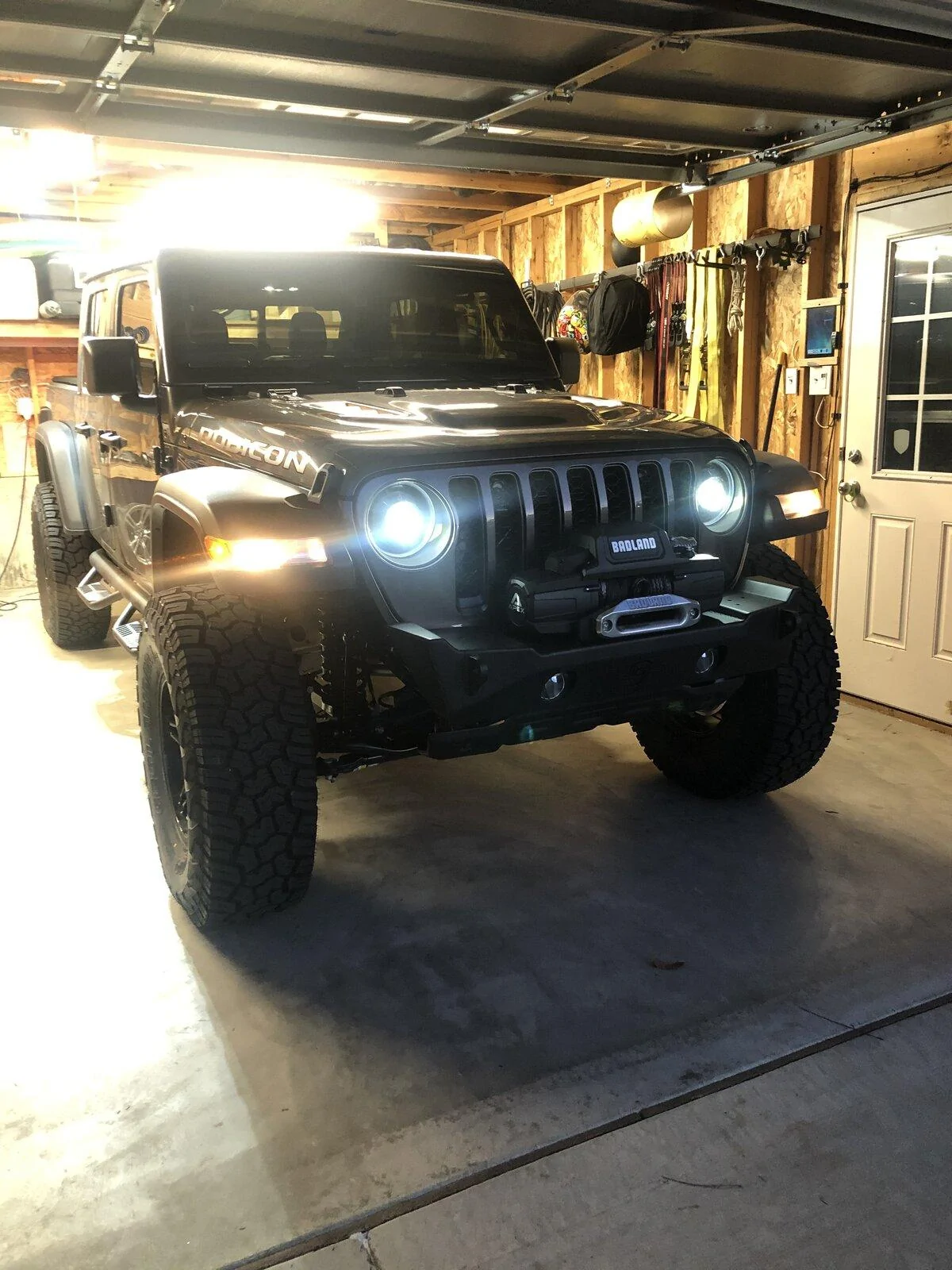

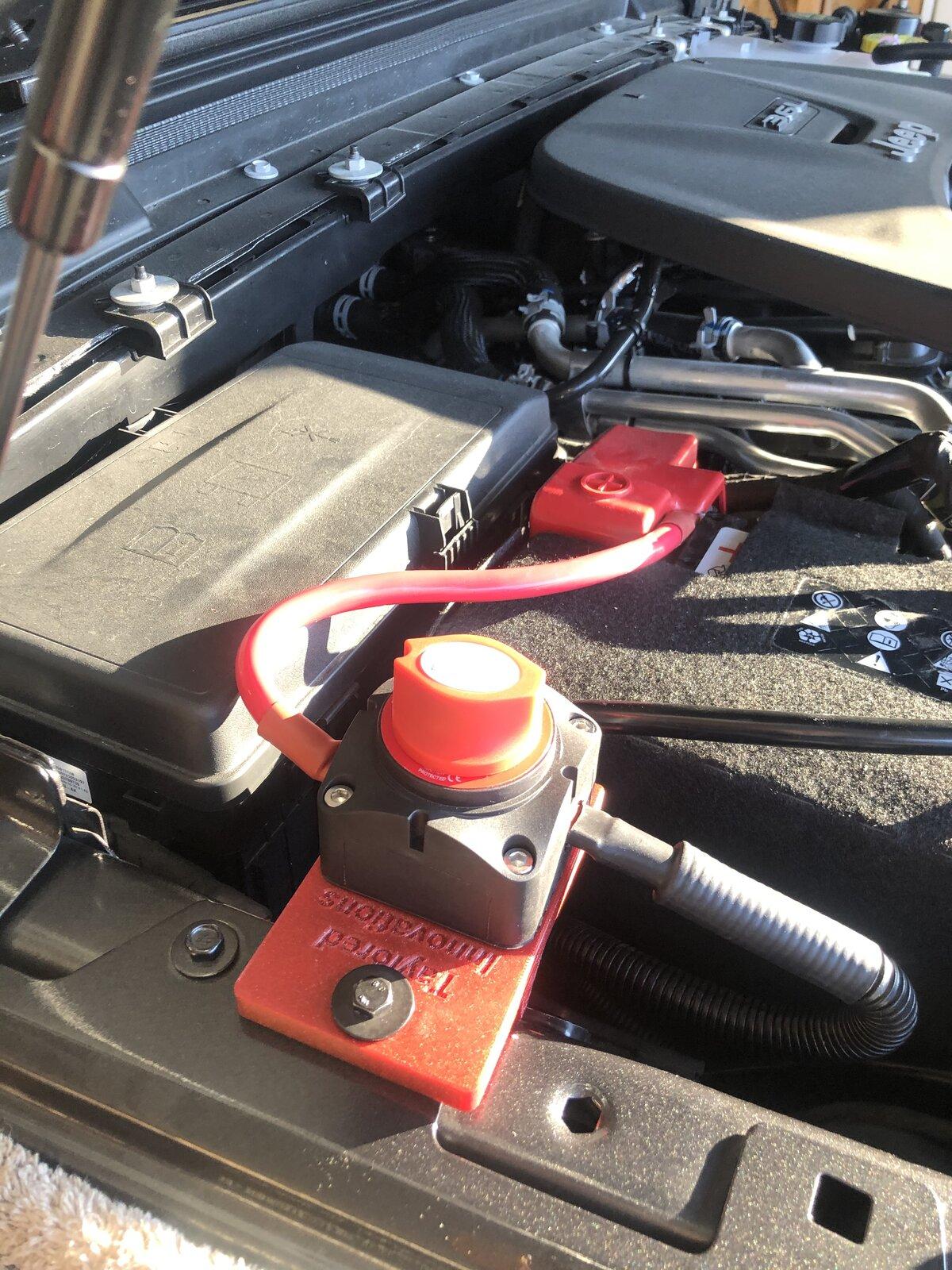

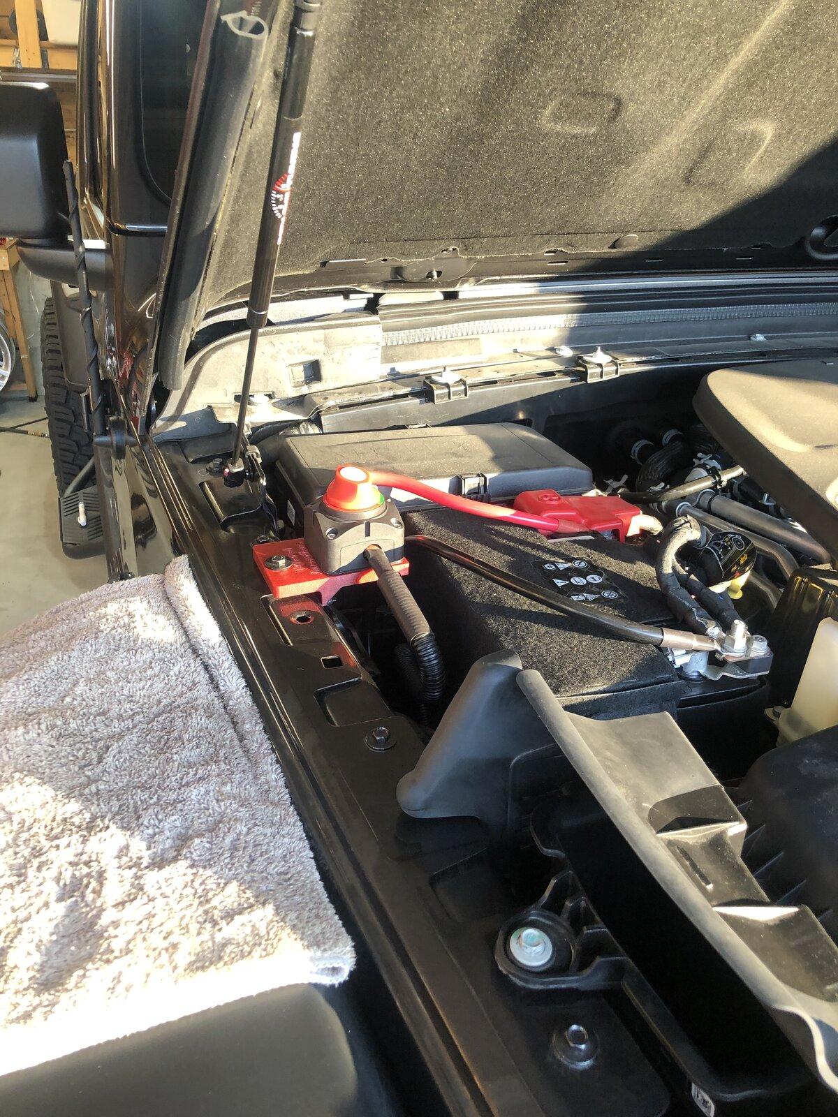

Added the Badlands Winch today
Noticed zero sag, or body roll or anything with springs and the additional weight. My ride is great over all. Tires set to 30psi cold. Falcons set to Soft 2.2.-2.3. Wife only complained about getting in...said this was tennis shoes vehicle now...no heels ?
Did make some additional adjustments to add more caster when I was chasing down a small vibration which ended up being a tires but the gains in adjustment lead to more knowledge and I can drive with 1 finger on the wheel. #effortless-handling
I should have gotten this gear sooner! @Clayton Off Road

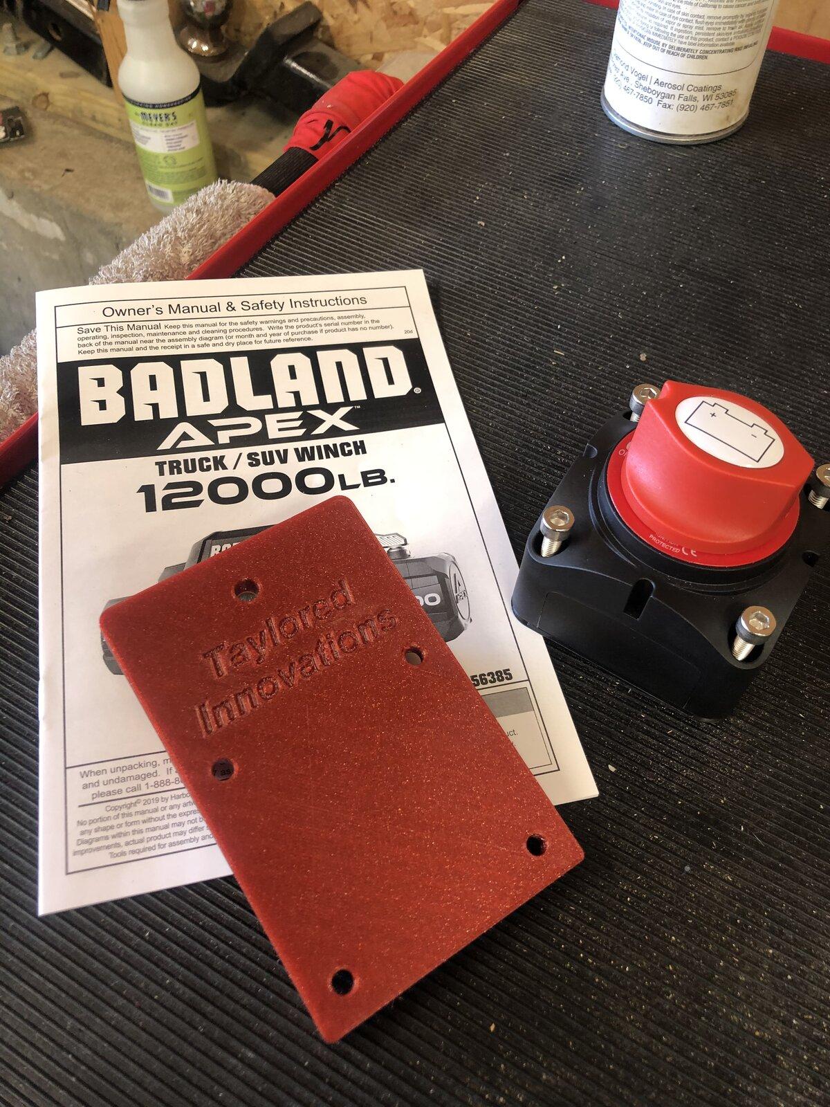

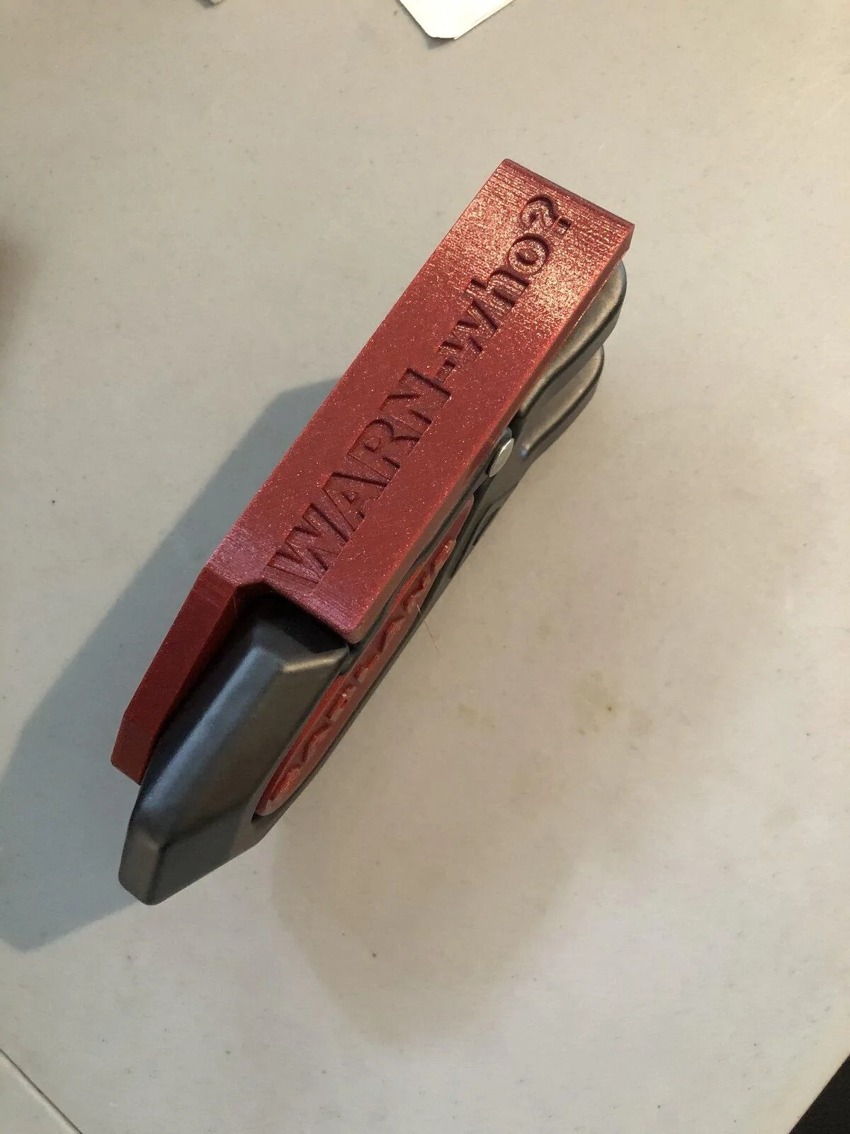

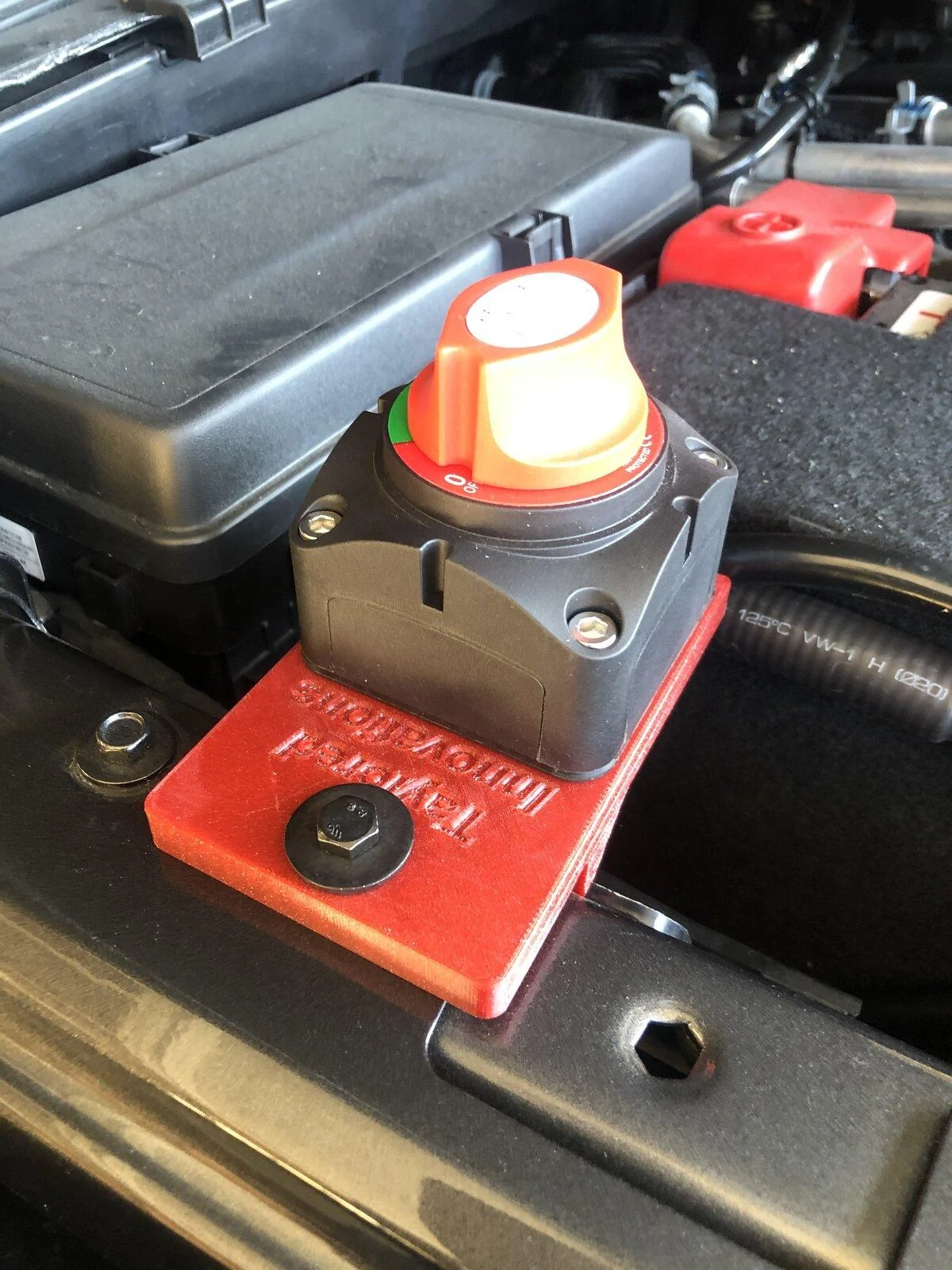

Also printed a bracket for the winch switch and a fairlead saver. Still prototype stuff but look until I get my flat link.
