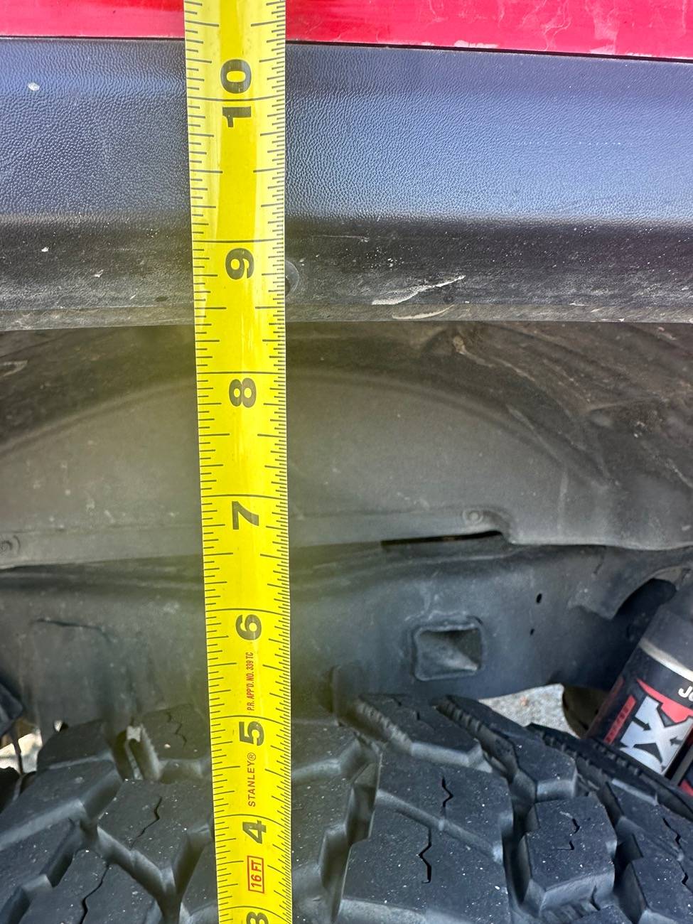

What’s your difference in gap between top of tire and fender?(front and rear) I have the Clayton diesel front springs which raise it about 1” along with a 1.5 level kit. I’m curious if I will be level after installing the rear HD 2.5 triple rate springs.

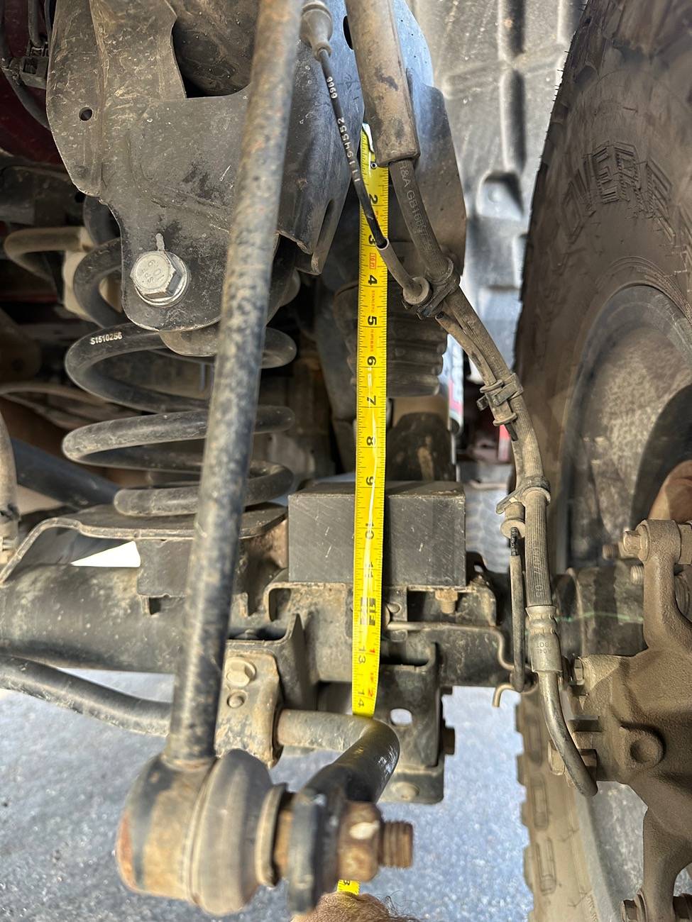

Sorry, took a few days to get time to park flat and measure.
Tire to fender will change with tire size, I’m on 37” STT Pros.
Jeep Gladiator Clayton Off-road Triple Rate Coils IMG_9411
axle to frame might be better measure of spring lift.
Note I have the 2” bump stop on there.
Jeep Gladiator Clayton Off-road Triple Rate Coils IMG_9413
I think there’s at least 200 pounds in the bed, probably 250.
I have a Bak 4s (I think 90lbs), ~100# bed rack, and tools/compressor.

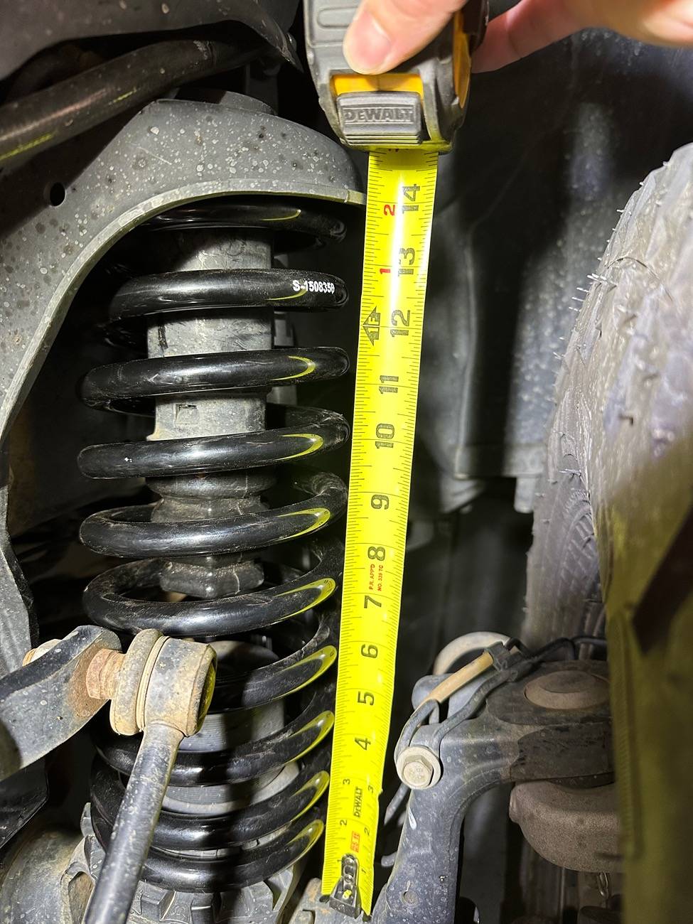

This is front with my 2.5” springs. Not sure what you’d get with your diesel.
Jeep Gladiator Clayton Off-road Triple Rate Coils IMG_3057
