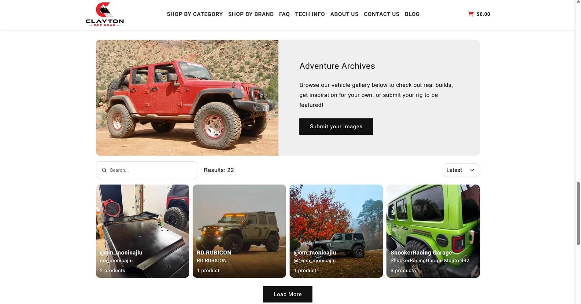

Share your build on our brand new website!
Let others check out what your current lift height/tire size combo looks like, along with any other modifications you've made to your Jeep, on our brand new "Adventure Archives" section available at the bottom of our homepage!
Let us know if you end up making a submission!
